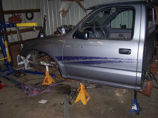

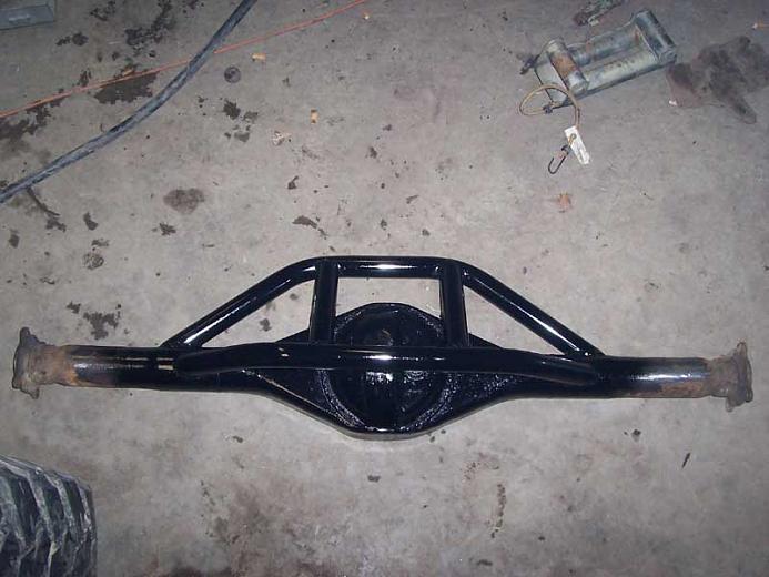

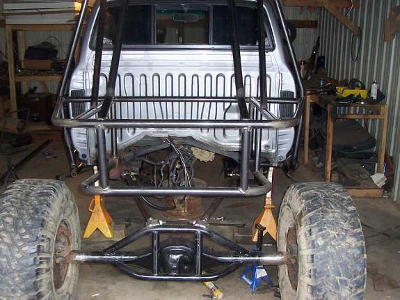

1998 taco.here we go sas with toy axles 2 t cases back case with 4.7.1. 22r on propane.dirty thirtys welded rear detroit in front 37 14 16 boggers on lostvally beadlocks.chevy springs front 4 link rear with fox 2.0s.

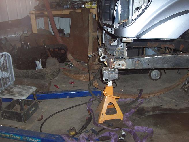

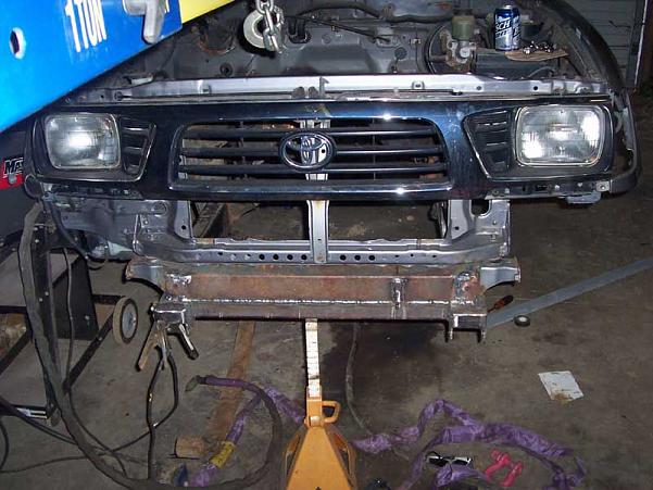

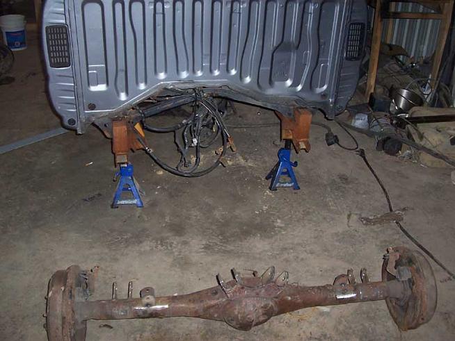

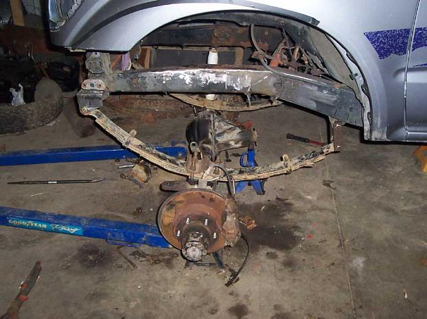

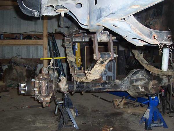

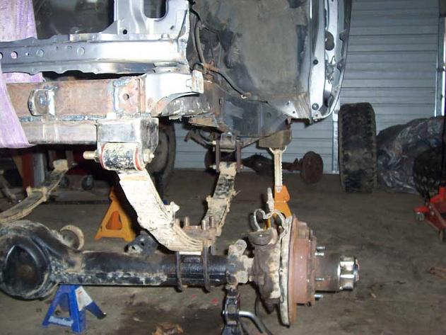

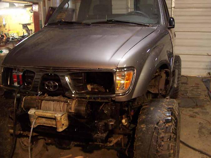

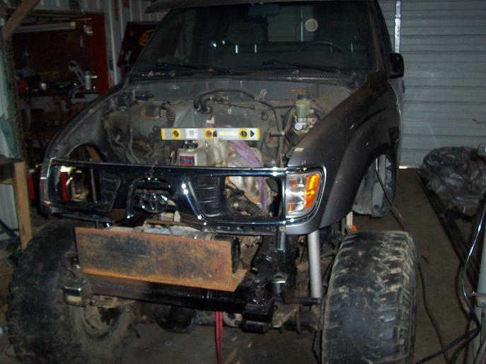

front moved forward about 4 inches.chevy springs and toy axle went in like butter,
Attached Thumbnails riegel's 1998 Tacoma Build-Up Thread-4x4-081.jpg   riegel's 1998 Tacoma Build-Up Thread-4x4-083.jpg   riegel's 1998 Tacoma Build-Up Thread-4x4-082.jpg

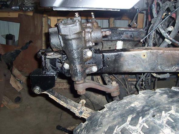

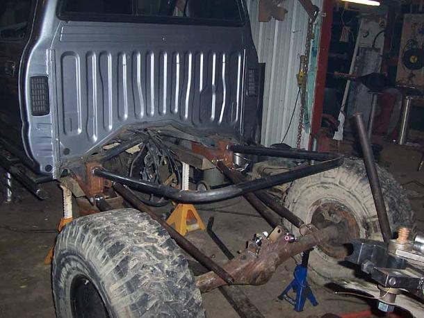

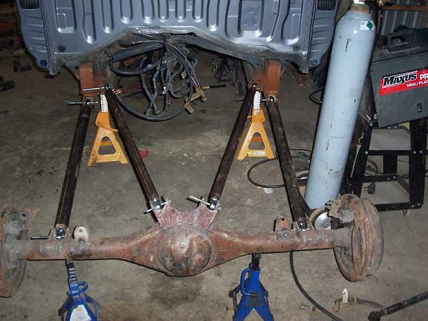

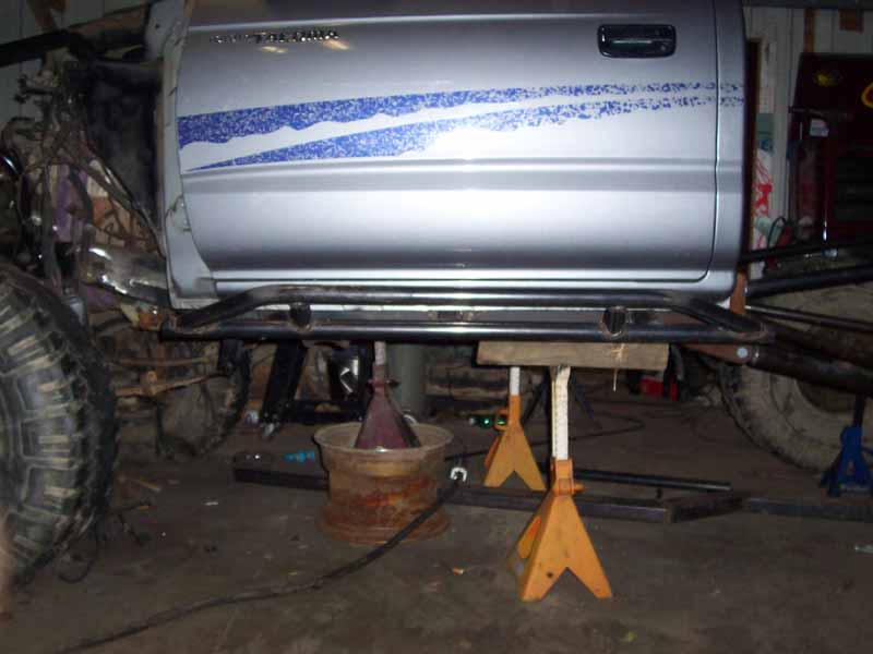

front mount and rear shackels.4 link mock up
Attached Thumbnails riegel's 1998 Tacoma Build-Up Thread-4x4-084.jpg   riegel's 1998 Tacoma Build-Up Thread-4x4-085.jpg   riegel's 1998 Tacoma Build-Up Thread-4x4-086.jpg

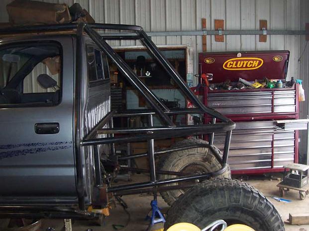

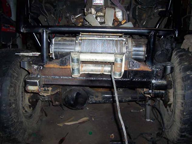

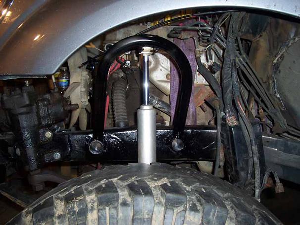

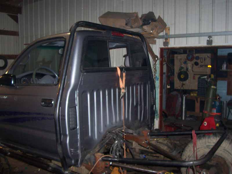

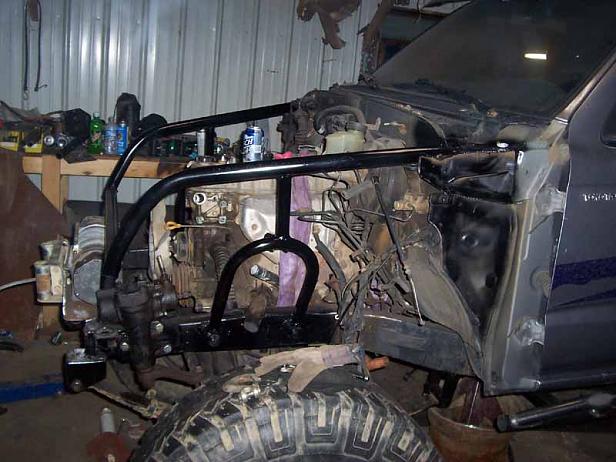

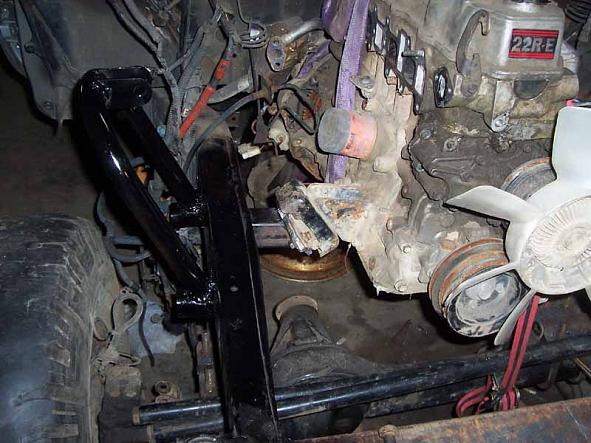

shock hoops and motor mounts. and start of winch plate.
Attached Thumbnails riegel's 1998 Tacoma Build-Up Thread-4x4-097.jpg   riegel's 1998 Tacoma Build-Up Thread-4x4-098.jpg   riegel's 1998 Tacoma Build-Up Thread-4x4-102.jpg

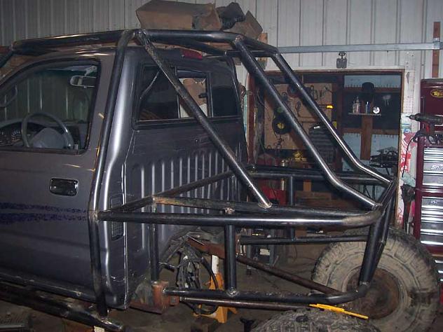

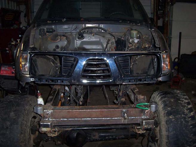

some new stuff.
Attached Thumbnails riegel's 1998 Tacoma Build-Up Thread-4x4-104.jpg   riegel's 1998 Tacoma Build-Up Thread-4x4-106.jpg   riegel's 1998 Tacoma Build-Up Thread-4x4-107.jpg

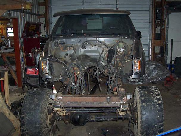

and more
Attached Thumbnails riegel's 1998 Tacoma Build-Up Thread-4x4-108.jpg   riegel's 1998 Tacoma Build-Up Thread-4x4-109.jpg   riegel's 1998 Tacoma Build-Up Thread-4x4-111.jpg
