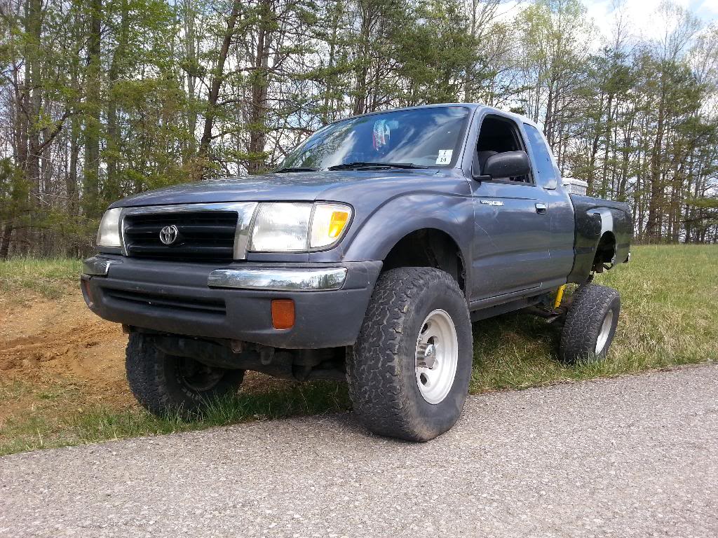

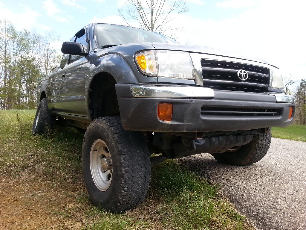

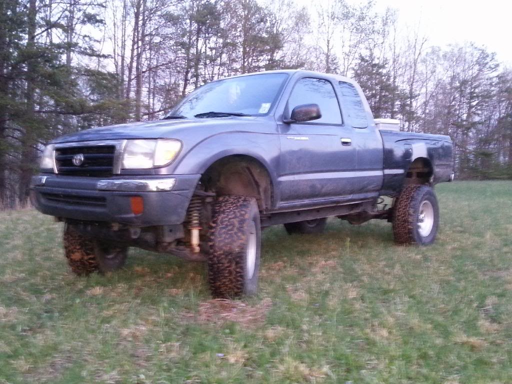

My lift came in friday so I installed it friday.

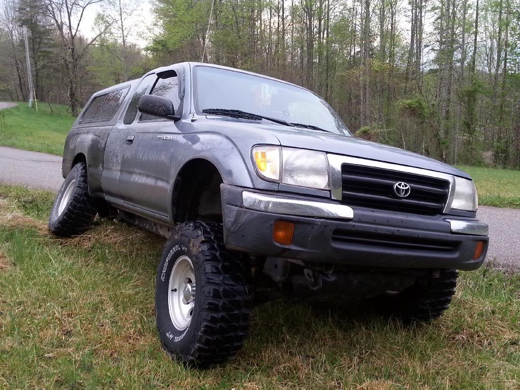

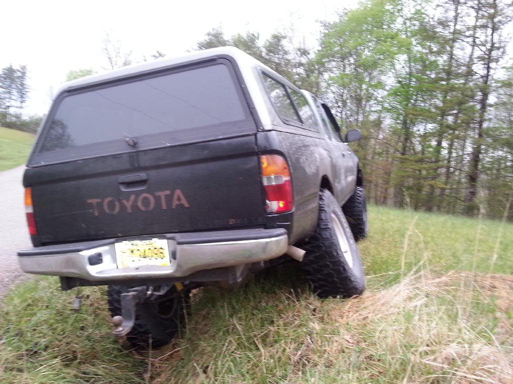

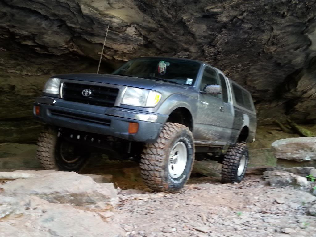

I tried my flex today.. I geuss its pretty good for what it is.. if I want more then I gotta go with a total chaos upper a-arm and a coil over

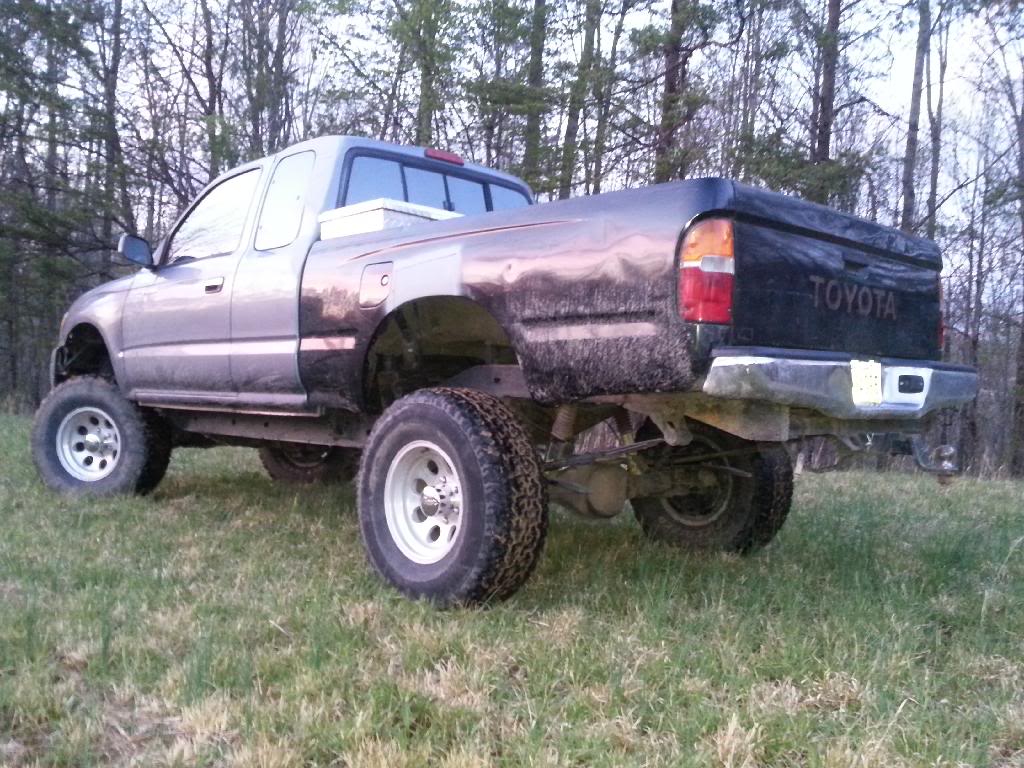

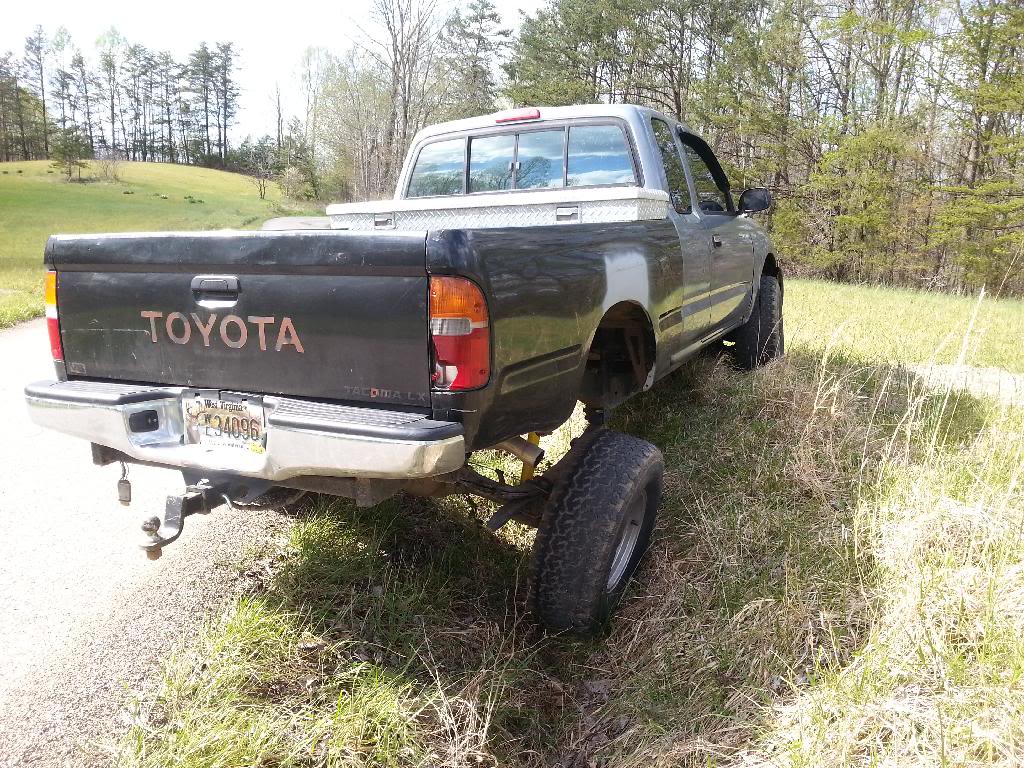

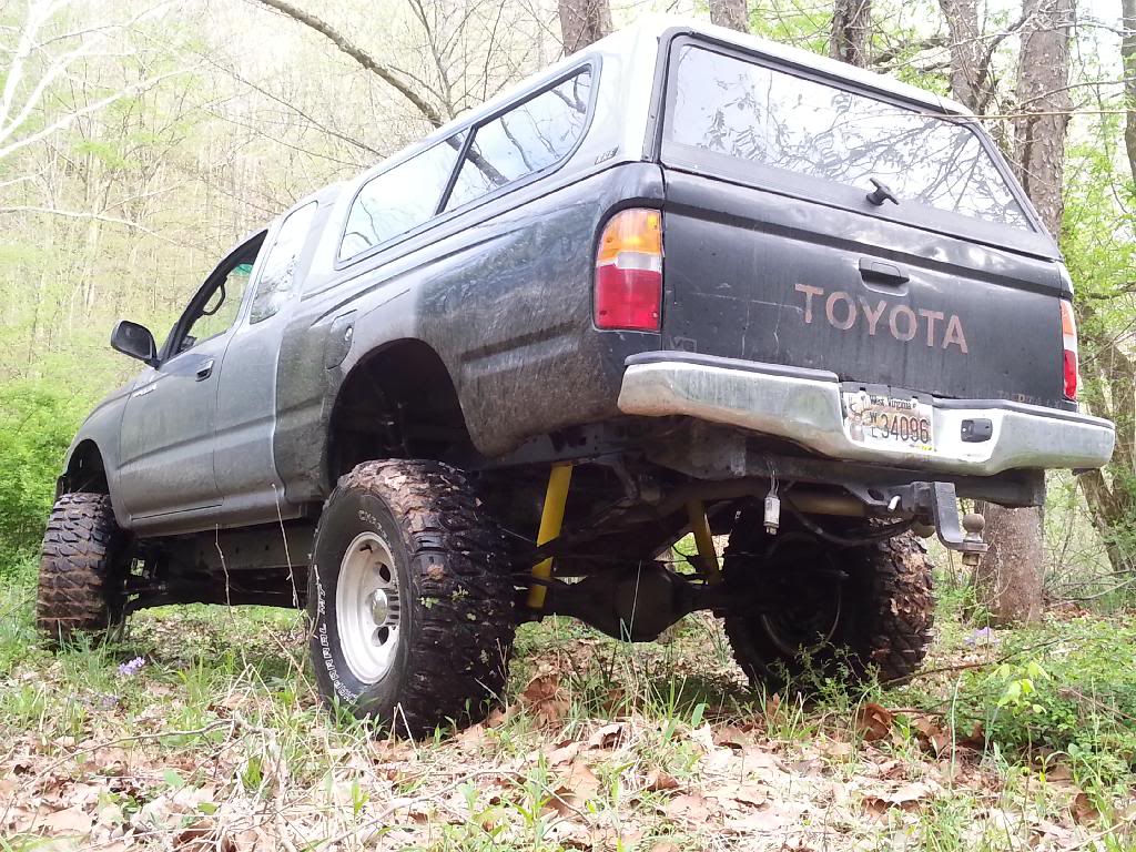

Crazy rear flex

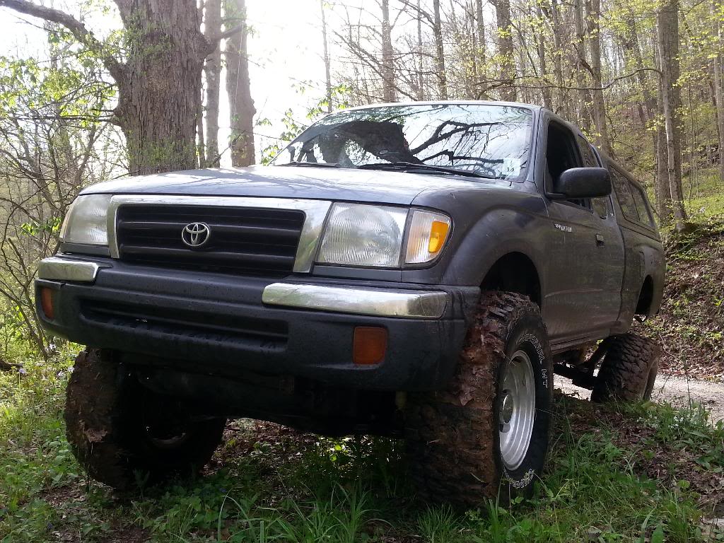

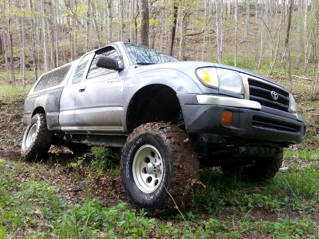

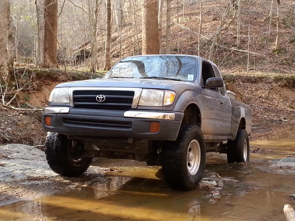

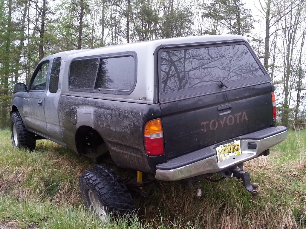

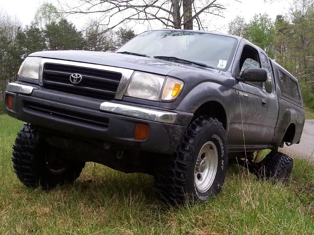

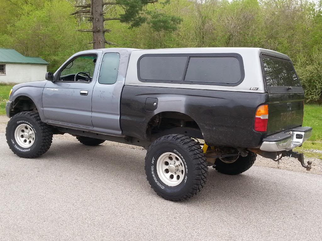

Ima setting at the Tire shop .. I decided to go with 33\12.50 Chaparral MT's. Ive never ran this tire before. After reading reviews and seeing them in person I wanted them. One good thing I like is they measure out to 34.3 inches tall when mounted on my 8" Rim.
I also bought me a Bed Cap today for $100.00 bucks. Its practically the same color as my truck. Included all hardware too.
So needless to say I spent $880.00 bucks on 4 news tires and a ARE brand topper. I will upload some pics in a bit.. I'm still waiting to have my tires installed.

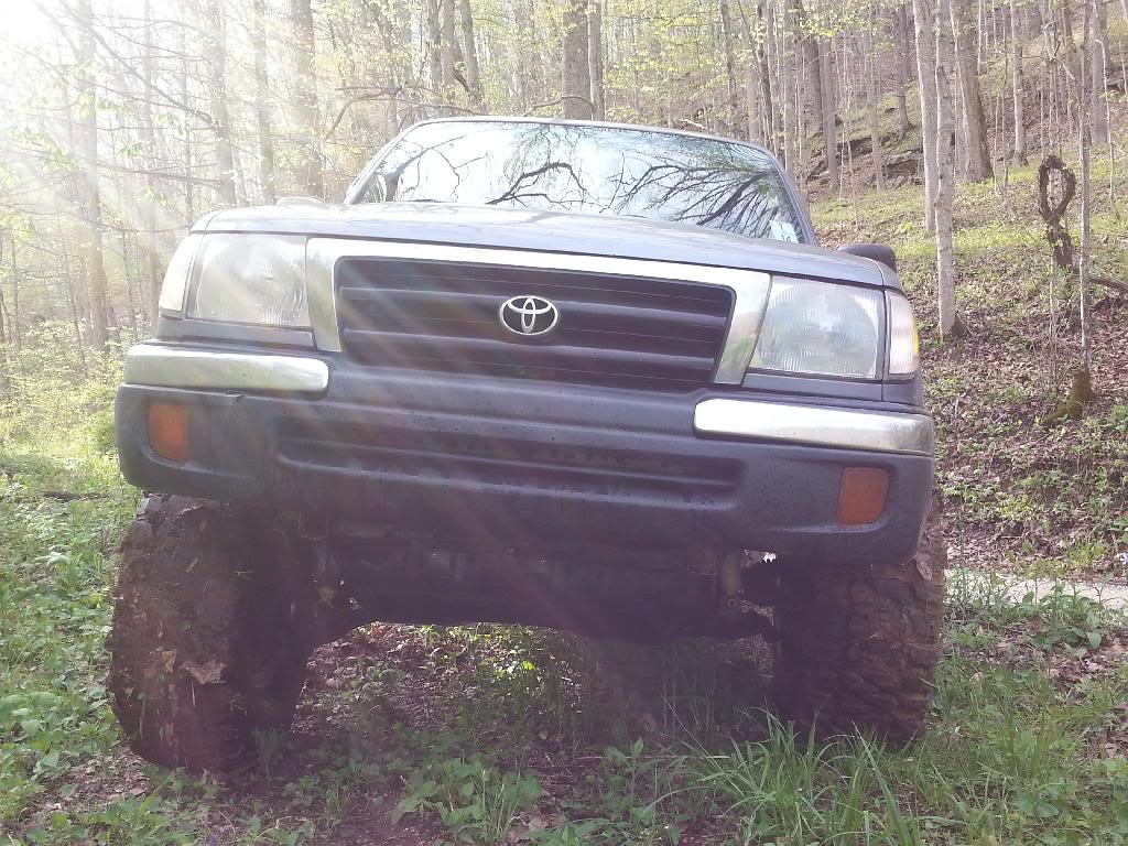

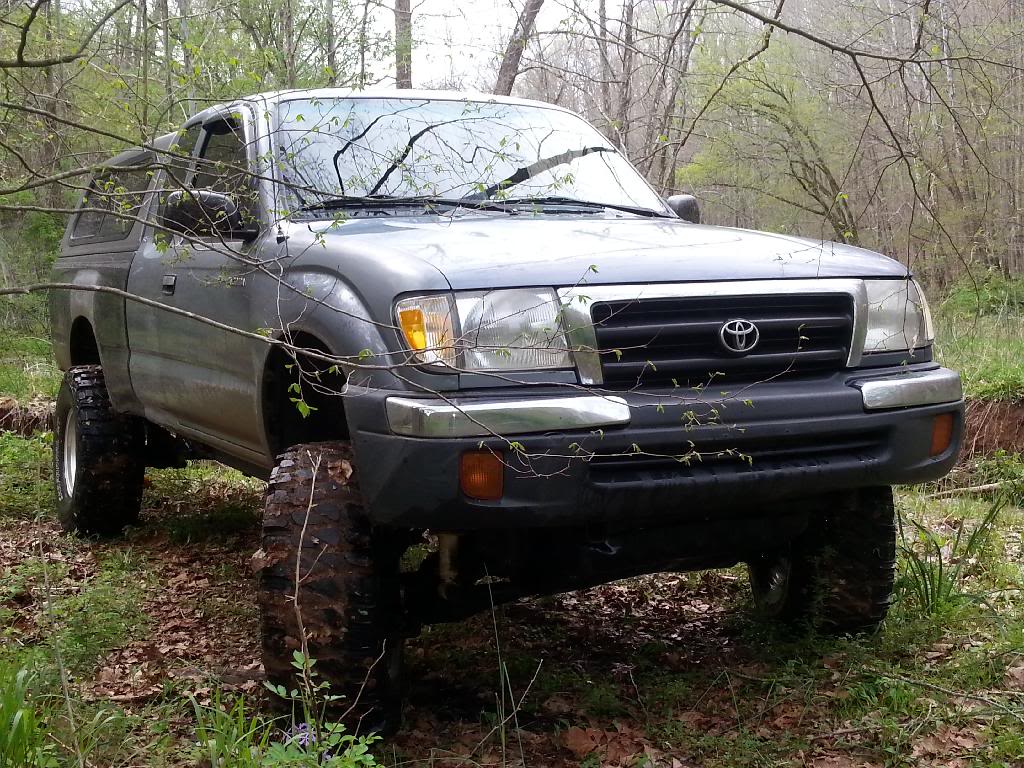

Playing around a little today.

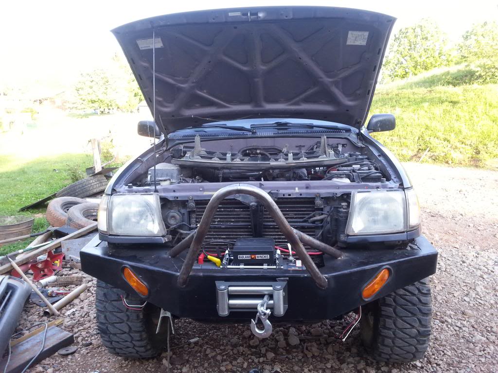

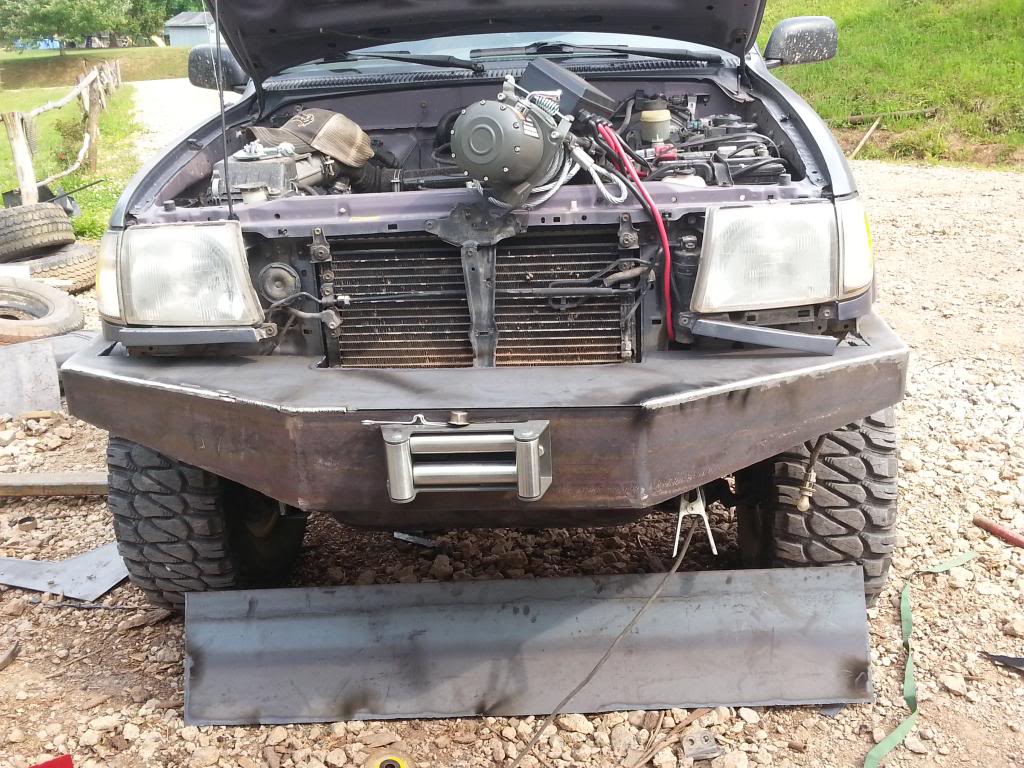

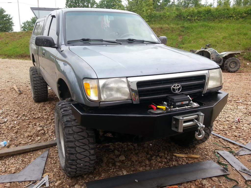

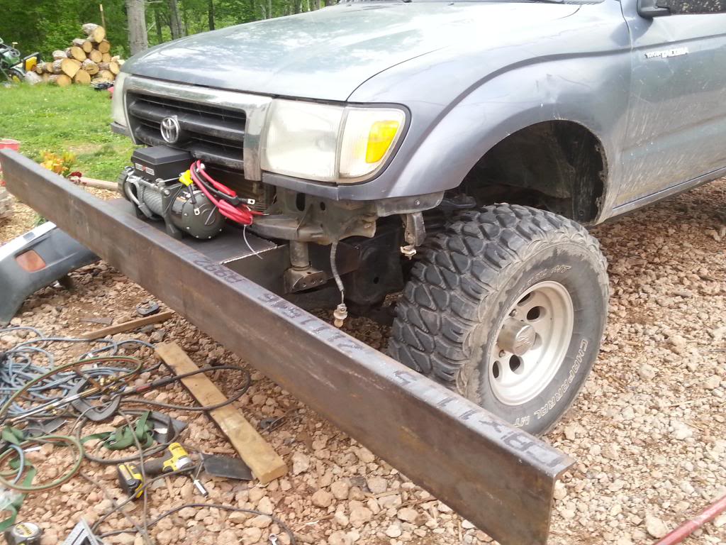

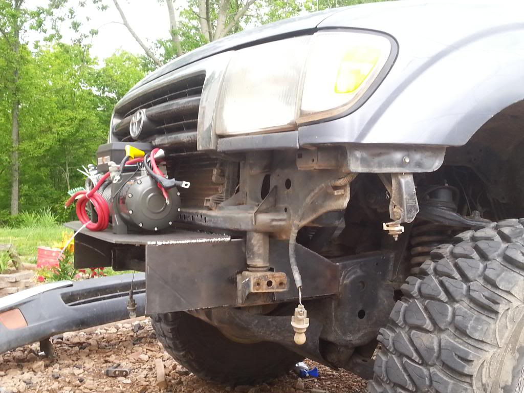

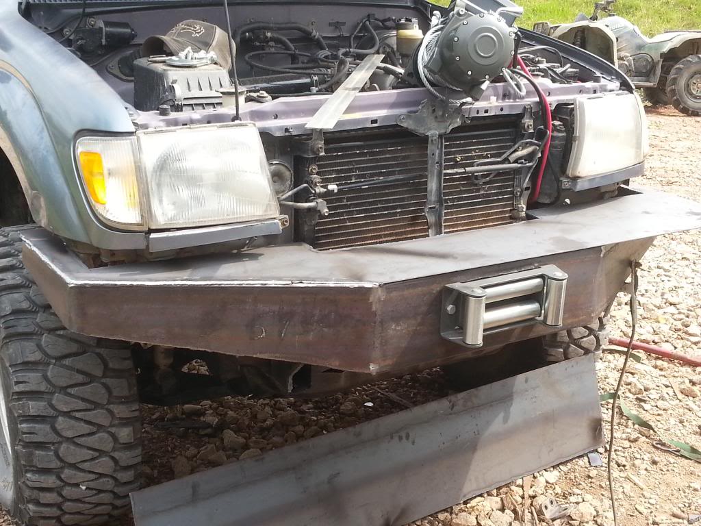

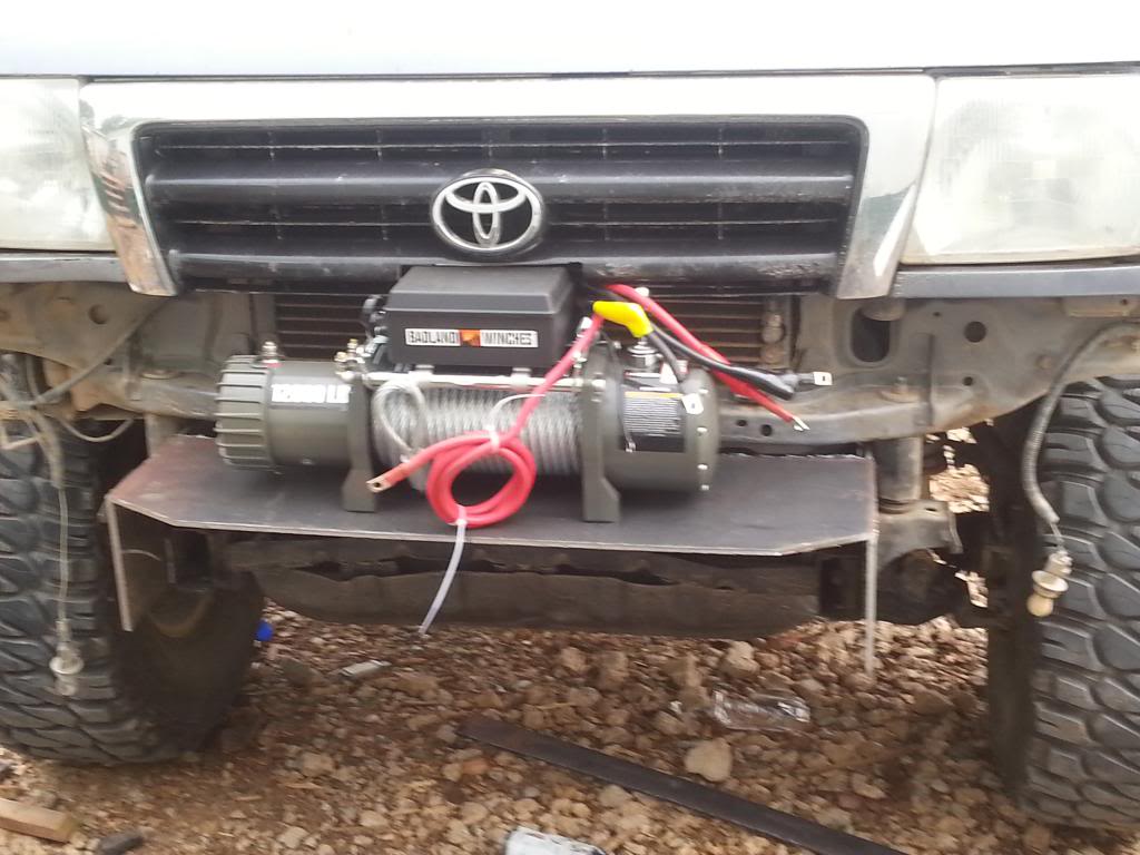

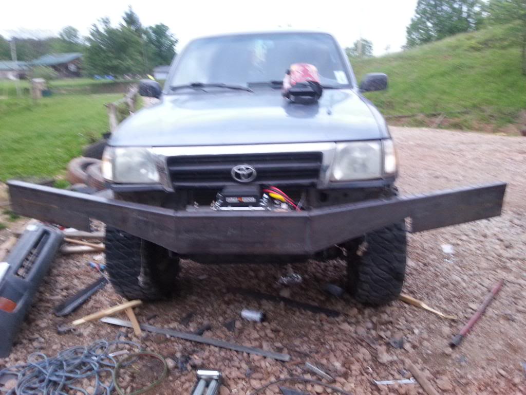

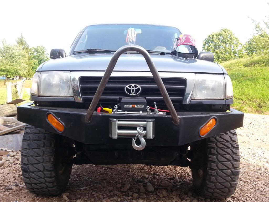

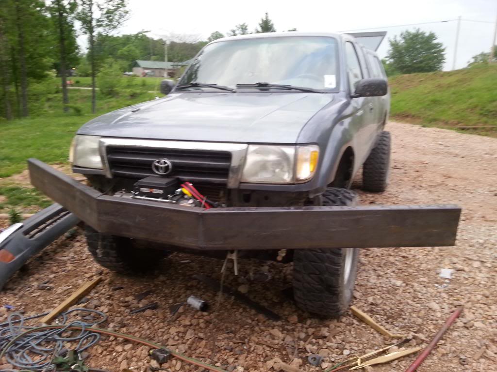

Recently I purchased a 12,000 pound winch for my truck. So with that said I had to build a bumper to hold it. So here's the pics on that.
The winch plate is entirely built from 1/4" plate. The main channel is 3/8" and everything else is 11g. The bumper and winch weigh in at around 275 pound.
After installing the bumper my front end sit 1" lower then the rear. So I decided to do the Tundra Coil swap. Instead of swapping in the tundra strut and coil I just swapped coils... THIS WAS THE WORST IDEA EVER. MY TRUCK RODE WORSE THEN A SASED TRUCK..... HORRIBLY ROUGH. THE COIL WAS ALSO HITTING MY UPPER BALLJOINT.
So with that said i purchased a set of SwayAway coil overs.. my truck is setting level and the ride is awesome. Nice and smooth.
