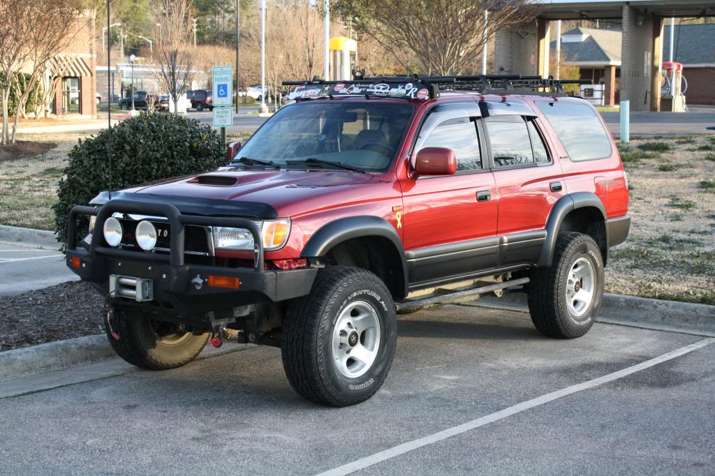

Painted my faded silver flares with Krylon before it got cold and they turned out terrific.

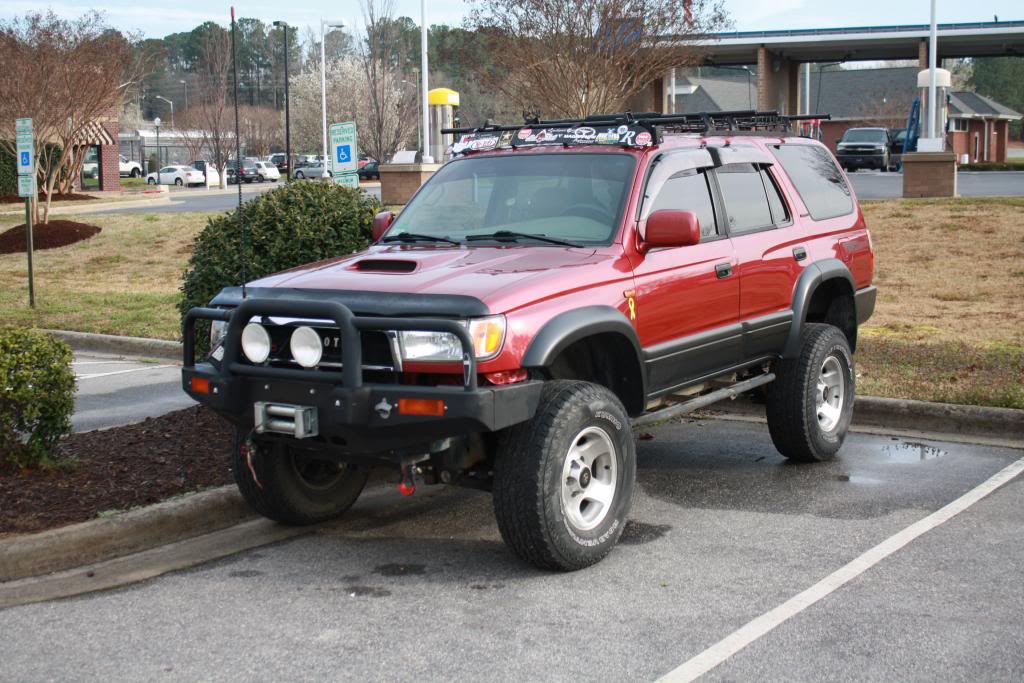

Finally had a chance to install the Bilstein 5100 Tundra setup and LC springs on it and I have to say it does ride very smooth. I have the front spring in the middle perch and may go up one notch to level it out some. The rear has a rake as seen in the pic but should settle.

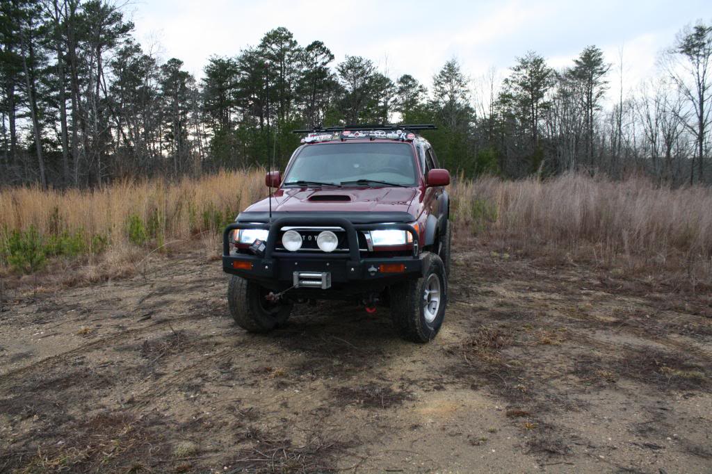

On the way back from the CWTS rainout at Martinsville yesterday. Bookmarked a little trail in my brain and stopped on the way home, nothing on top of the hill but garbage an a decent photo op.

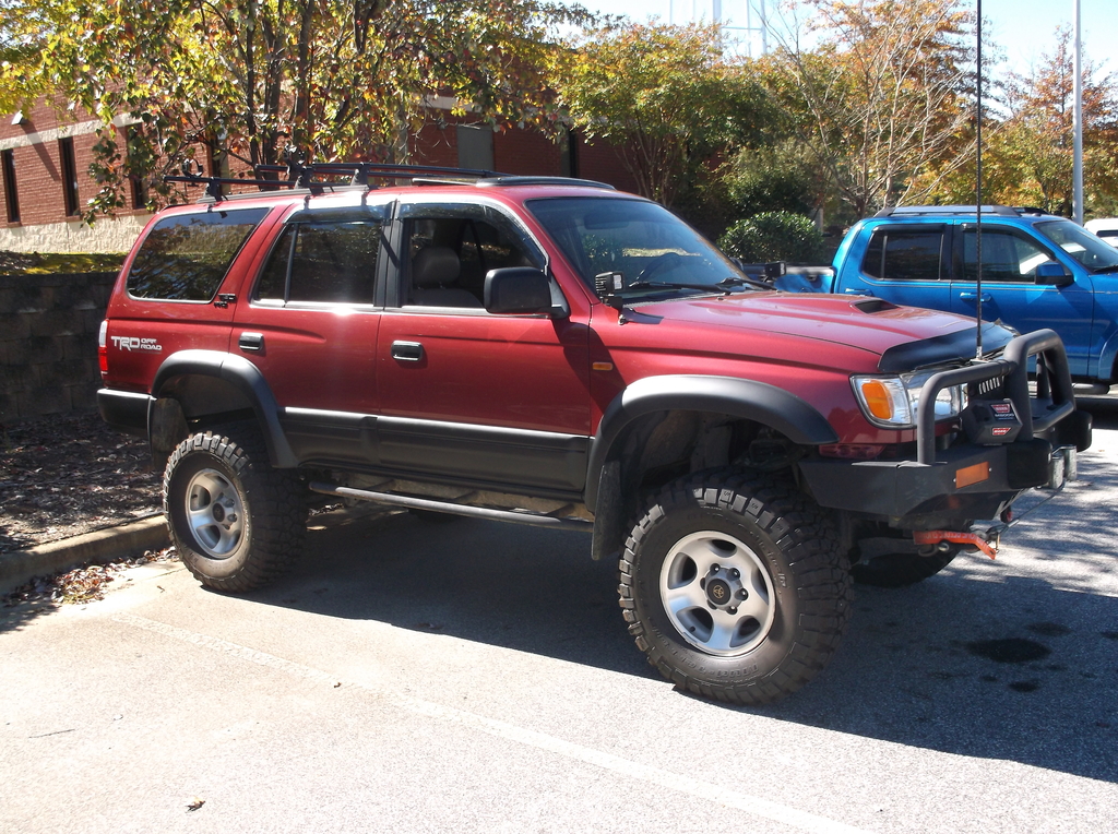

285/75/16 BFG KMII installed after a long time of saving
