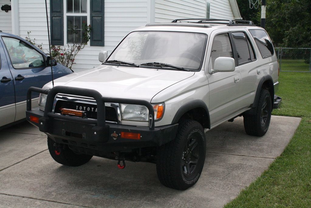

Just bought a 97 4Runner, has an extra shifty thingy in the console!
Old 05-14-2017, 05:24 PM
  #59
habanero's Avatar
Join Date: Sep 2005
Location: mo
Posts: 8,189
Received 463 Likes on 309 Posts
Whaaaa???
I have that! It's fun!!
Looks good, any plans for it?
Old 05-15-2017, 04:19 AM
  #60
terminator's Avatar
Join Date: Jun 2003
Location: Raleigh, NC
Posts: 923
No plans yet but you know how that goes.
Originally Posted by habanero
Whaaaa???
OK, so the vehicle has received the 99+ console upgrade, SR5 flares, Limited wheel painted, rear wind deflector, 99 coils front and rear and my TJM T15 and Satoshi grill from my 96 4Runner which will now get an ARB bumper and Raptor style grill.
