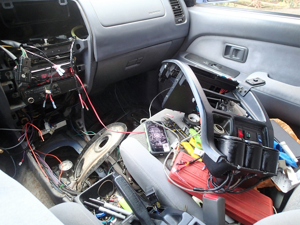

96 4Runner 287,996 miles
Done.
Got the electric cleaned up behind the center console in the dash,
changed the bulb color on the center console gauges,
made a new gauge holder out of junk,
added a 3 switch plate to the console,
moved the overhead light switch to one of those spots,
put in a daddy switch in another of those spots,
put the obd ii on/off switch in the last of those spots
got the new socket on the shifter and the new seats in.
Listened to all the Toyota Trucks and Trails podcasts I needed to catch up on. I found all of them to be interesting, got mentioned for a comment made, loved hearing about winch bumper considerations and have stored that info for further thought, always love hearing about Jason's 4Runner, had a lot of chuckles over the STLCA chat even though the audio on that one was terrible it was worth it. And more!
This vent was broken and floppy so I replaced one with a spare I had out of a 99+ bezel. They are the same as the earlier style.
The transfer case shifter seat had turned into tiny particles, the transmission shifter seat was just chipped in places. The tranmission shifter socket seemed fine until I put the new one on. It is much more firm.
The socket is easy, a screwdriver and hammer bumped the old one off, I set the new one on a rag and pressed the shifter down onto it.
The transmission shifter was hardest to get off, press down and turn counter-clockwise. It was also easiest to put back on, press down and turn clockwise. It was the opposite for the transfer case shifter, easy to release the snap ring and hard to replace it.
To put in the Marlin shifter seats clean everything out to bare aluminum, line up indents in top of seat after you turn it upside down with the posts in the shift lever housing then rotate and push down into place. Grease and add shifter. I believe the Toyota version simply requires you to squeeze to fit, but don't quote me on that.
White for the transmission, blue for the transfer case.
I used some black rtv for the places where the vinyl shifter boot has holes or where the material is thin and about to break from being bent back and forth. I put it on the inside of the boot, we'll see if it holds okay.

You can see I removed the transmission shifter housing. It's not necessary to replace the seat or socket, mine was full of dirt so I spent a bit of time cleaning it up and freeing up the 2 breathers. Didn't see an easy way to remove and extend them, so I didn't.
That picture makes me twitchy.
I tried to repair a shift boot with liquid electrical tape. It peeled off in one piece. I'll try RTV.
We managed to get the '89's rear bumper off while cooking a turkey. It took a lot longer than expected. Happy Thanksgiving!
That picture makes me twitchy too! Too many wires, too much clutter. I'm not meticulous like you or Terry, but I can agree it's a mess.
I don't know if the RTV will work yet, I put it on the inside rather than the outside, mostly to reinforce the weak spots. It'd look pretty bad outside, I think.
