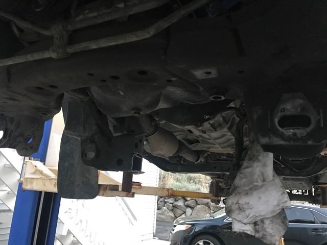

Doing IFS lift kits are just something else. This one included Fab Work. On Scale from 1-10 on how hard it was, id say it was a 5 or a 6(prior hands-on knowledge on of lifting trucks). The part that really blows about this lift this once you cut that back cross-member that holds some of the IFS theres no turning back (unless you wield it back on) but im trying to say it will never be factory…ever. Also you have to cut out a Square chuck on the driver side of the frame.
driver side cut to clear extended steering knuckle movement
Cross-member support cut
Id like to say the extended power steering lines are a lil bit of a fight. The area/room you make from cutting the crossmember is a tight fit. I would advise making another small cut to allow the line not to rub on the new cut over time per se’. my line seems to have a small mark on it now so I would make a small cut or even just grind it down a tad. (picture will be shown and labeled)

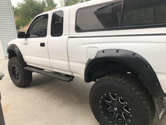

With the 35x12.5 and 4.5in offset rims, you will make contact on your front inner wheel well. And it does not sound nor feels pretty. It is quite harsh and makes your ass pucker. Also I need to say you will eat ur rear fender wells once you get a good flex on because I found that out the hard way to.
So I did the most logical thing ever and got some bushwackers. My 1st thought was, cheap crappy plastic. 2nd thought lets just send them back. 3rd was screw it time to drill holes in my nice paint job. I said screw it because bushwackers have a good warranty on them just fyi.(but does not include the damage you do towards installing them obv) Just the bushwackers them self.
So putting the bushwackers on it kinda iffy if id say my self. There are holes that drill into nothing is the only way to put it. Its like they made it for a model of truck that had a bracket for the certain area which you’ll see in the pic below this. Just makes me think its cheap and flimsy but it bolts on their pretty good id say. Hopefully good enough not to have to work on them ever again but you know how that goes.
After having them on I haven’t rub yet thou. So I guess it did its job.
