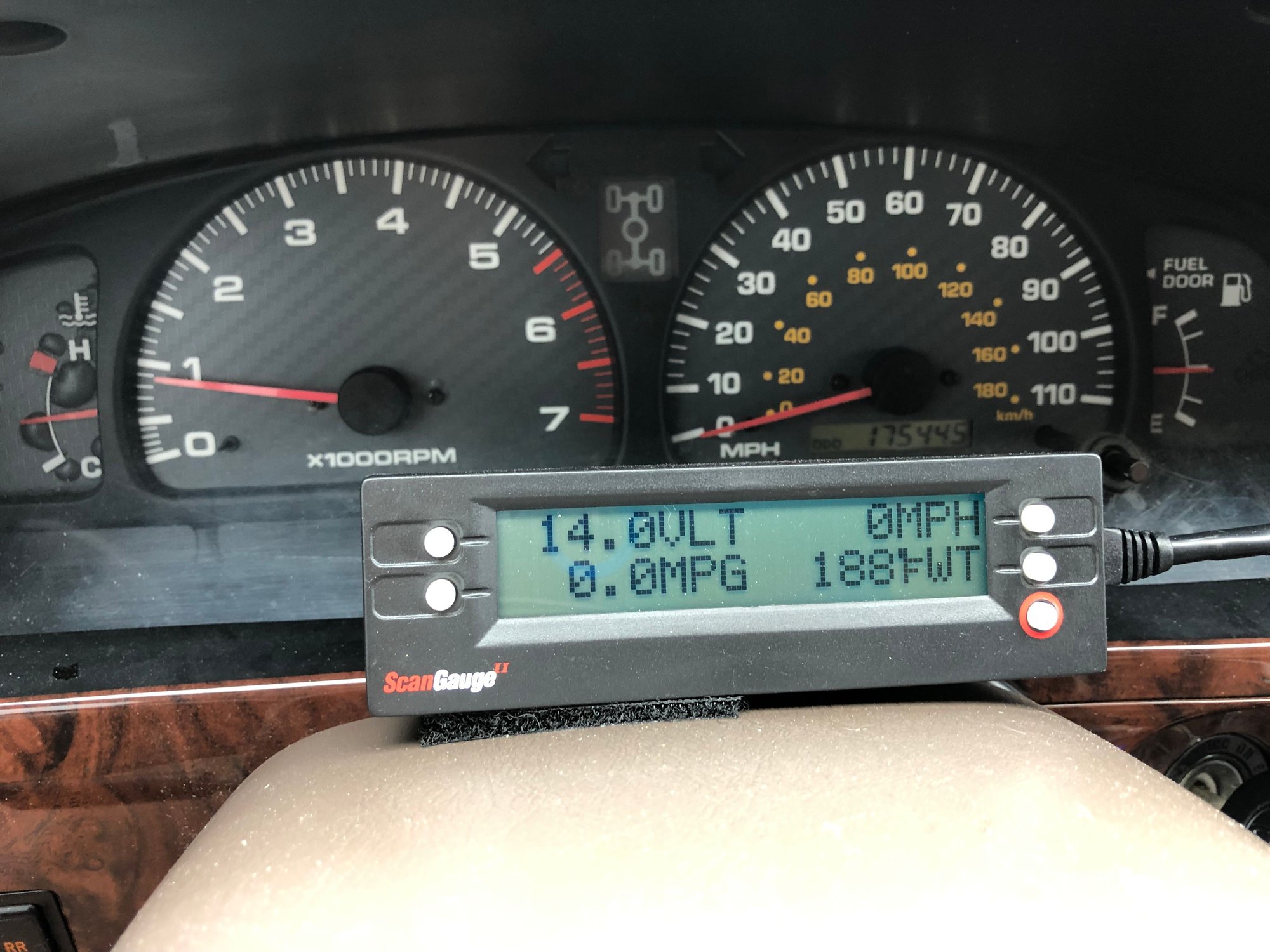

I have seen the ScanGaugeII is a very popular monitoring system. I always wanted one to better monitor coolant temps, volts, and fuel mileage (I thought they did trans temp too but I was wrong). So as a late Christmas present to the Yota, I cashed in some speed perks and got one for a discount.
I installed in on top of the column between the tach and the speedo, it blocks the indicator for park and reverse and high beams. It’s not too intrusive in the dark. And I recently managed an trip average of 23mpg and 275 miles to the fillup. (Granted that was very disciplined highway driving)

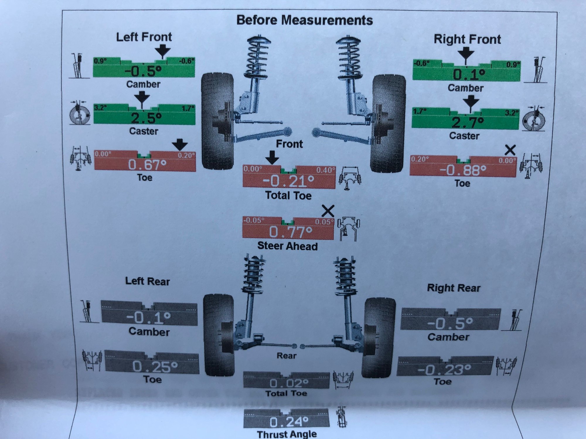

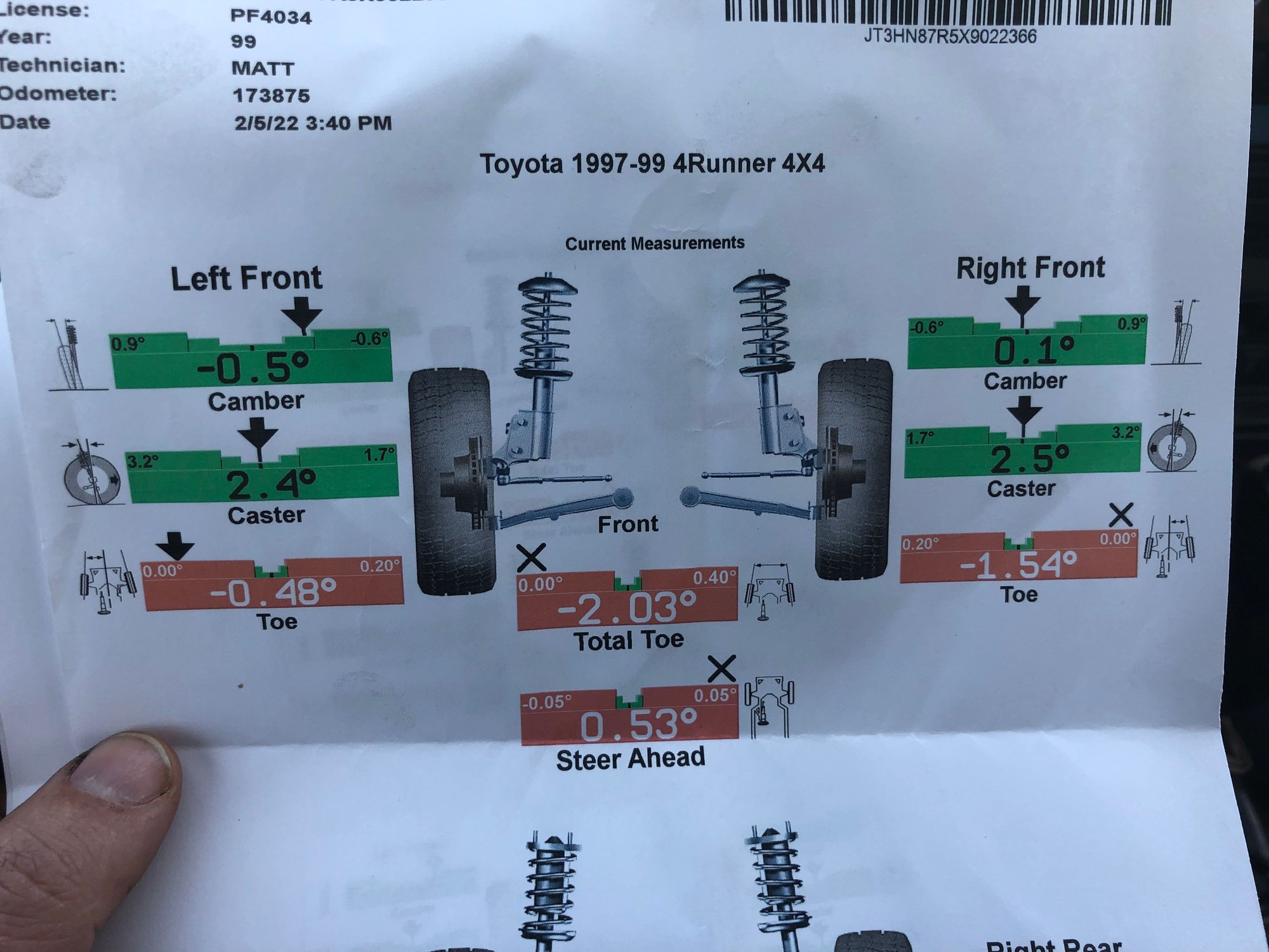

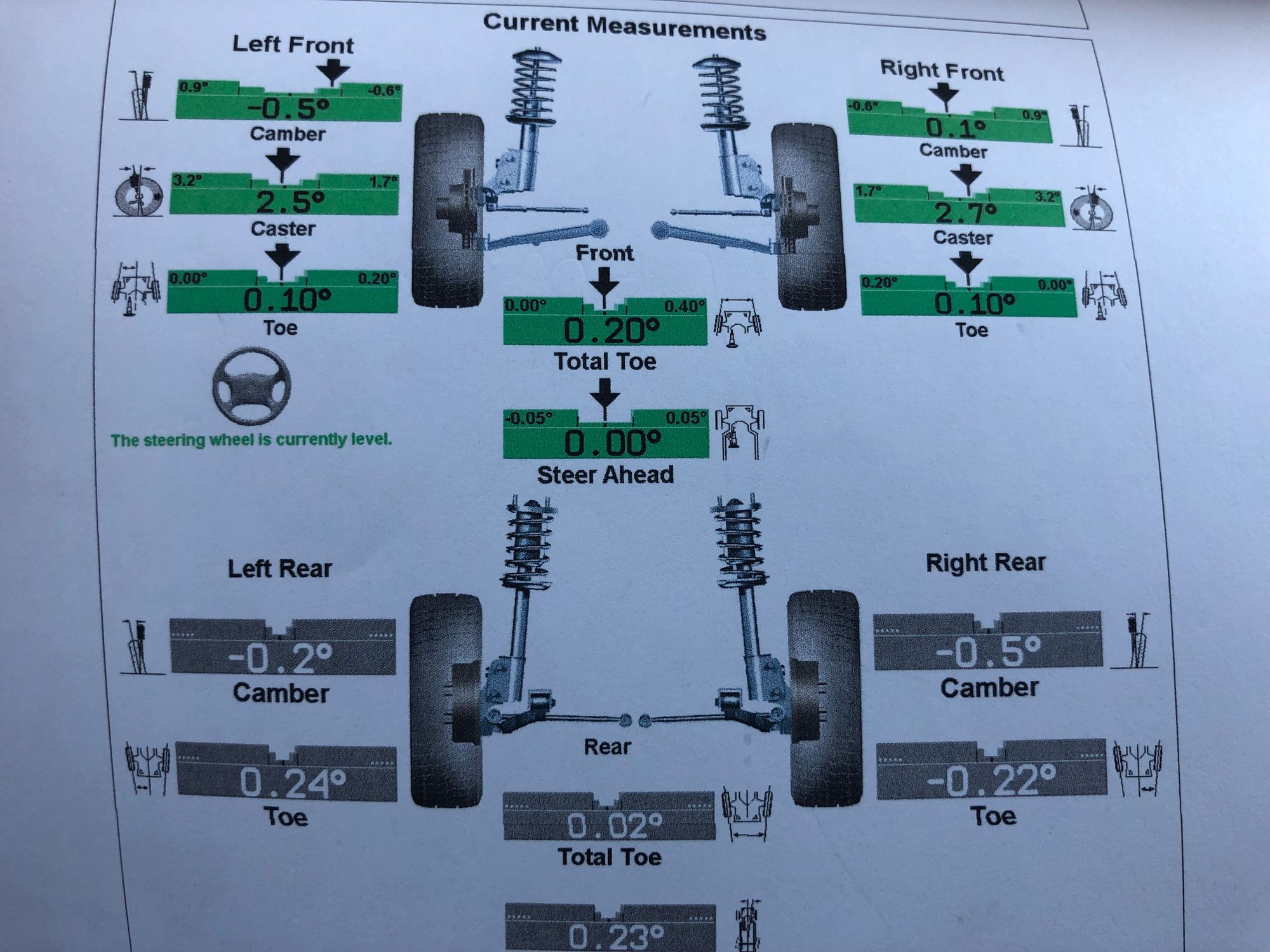

On my way to work I got boxed in and couldn’t straddle the lanes like I normally do around a pothole about the size of a 5 gallon bucket and so hit it doing 75-80mph. Immediately after my steering wheel was clocked by about 45* and there were about a dozen cars on the shoulder with flats. At least huge sidewall 16” tires have some benefit.
Alignment indicating damage
After my driveway alignment after new inner and outer tie rods on both sides
Professionally done alignment 😎
I took the truck to my alignment guy with tie rods for the passenger side. He said he couldn’t get the drivers loose to adjust and they had a little play, so I ended up replacing inner and outers on both sides, did my best to align it to drive back to the shop and then had professionals put it spot on.
she drives like a champ again. Plus I have a claim in to SHA of MD. I learned the state has insurance for some roadway related vehicle damage. I’m hoping for the best and expecting the worst, but that morning by the time I finished my commute the traffic reports were saying the lane of travel I hit the pothole in was now closed for “emergency repairs” so… 🤞🏼

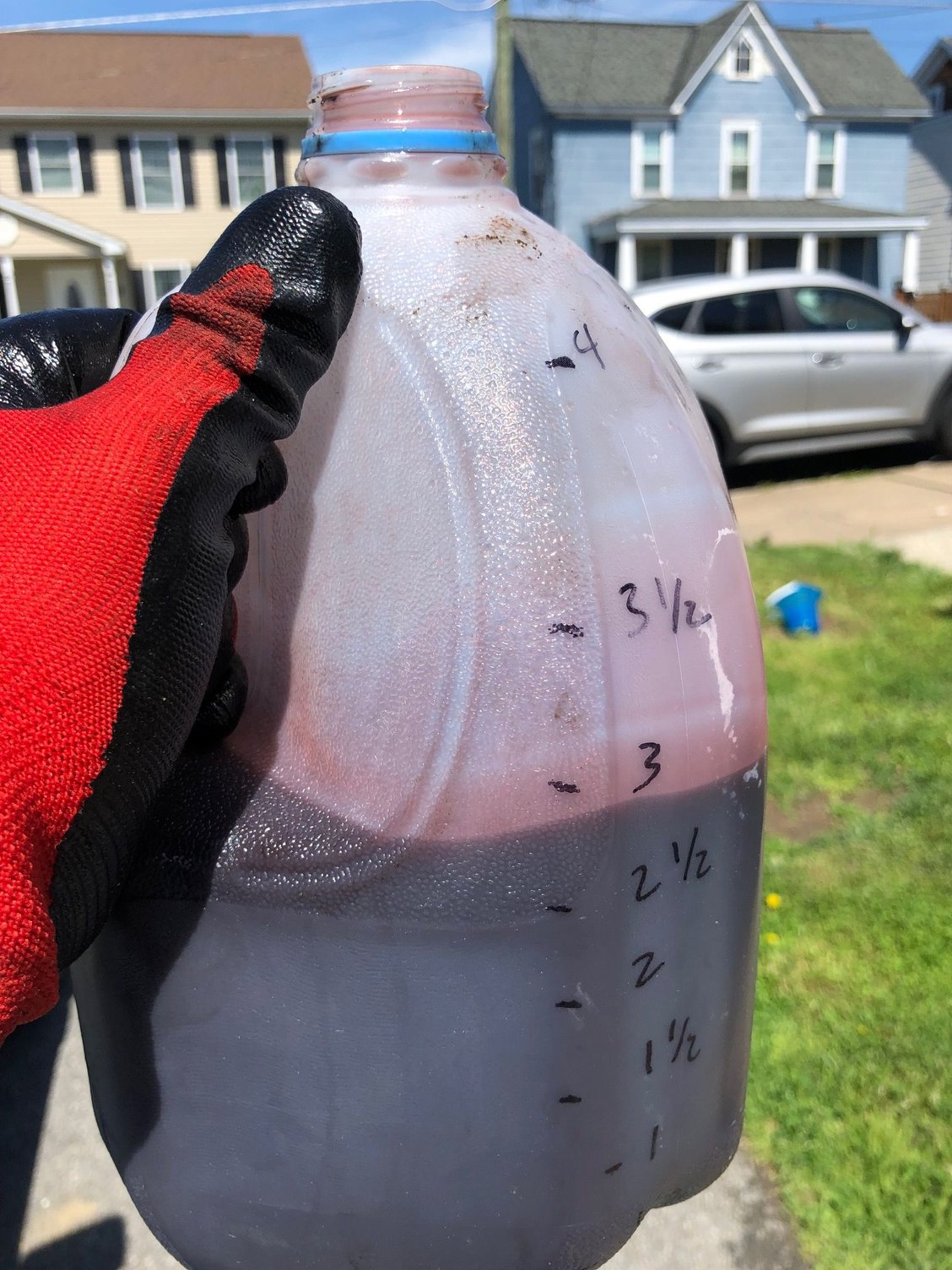

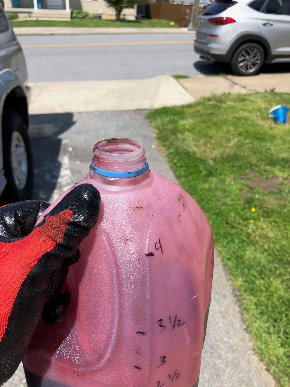

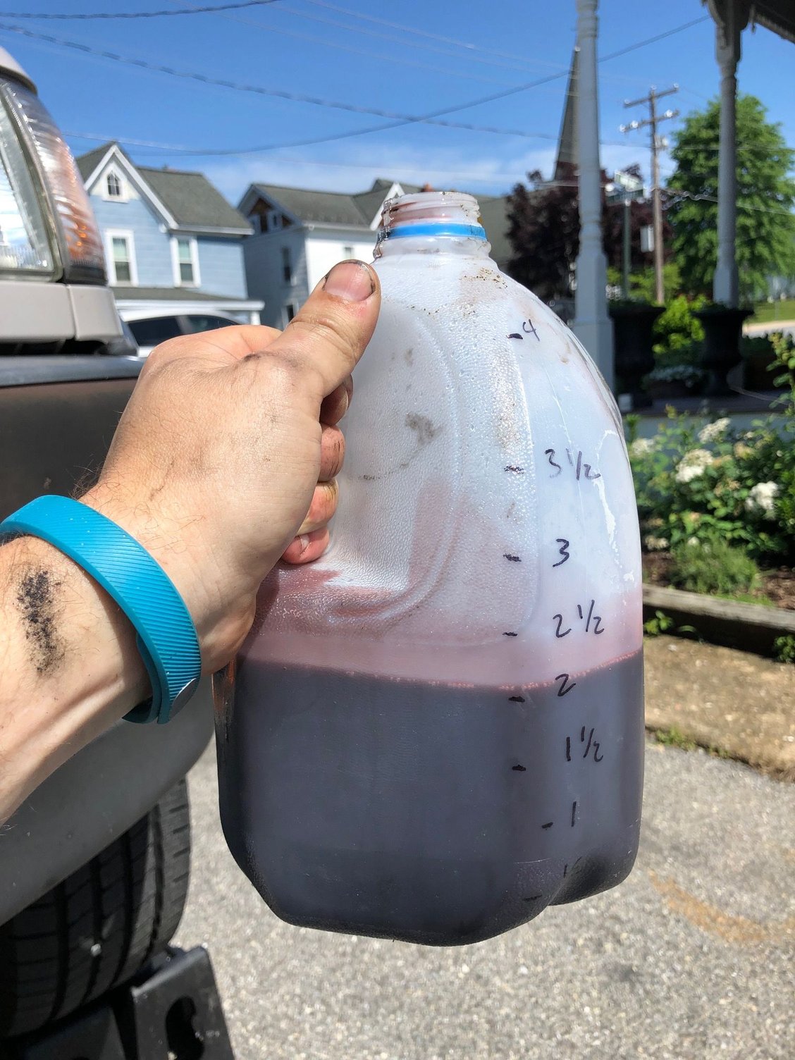

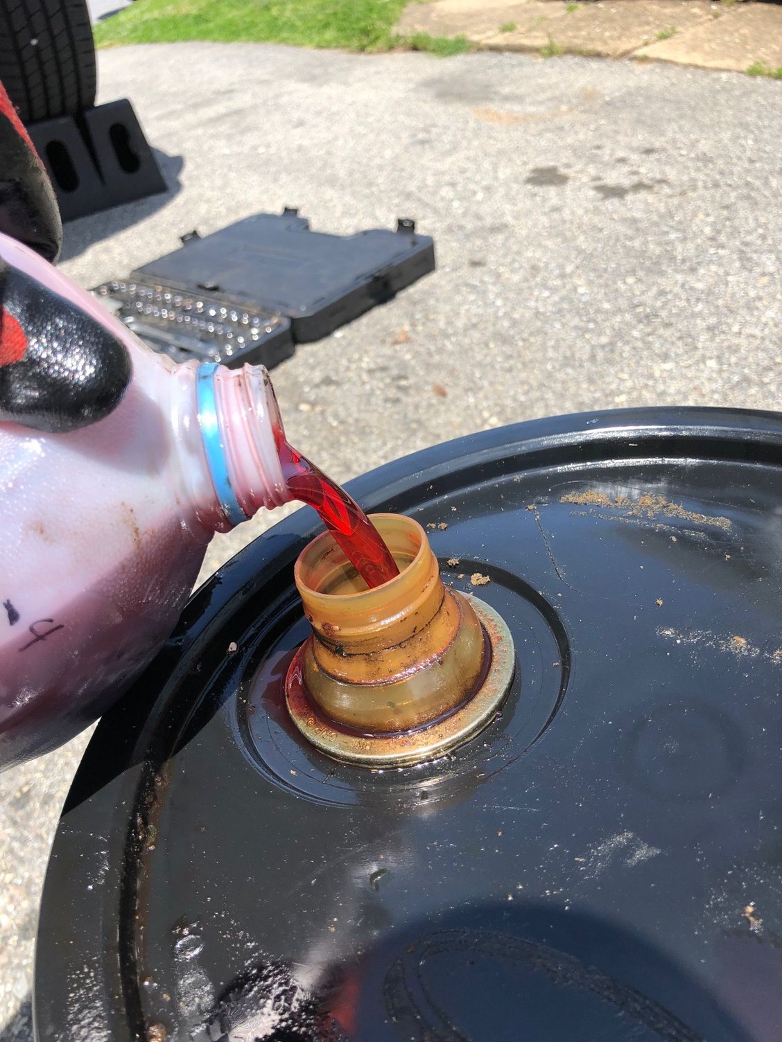

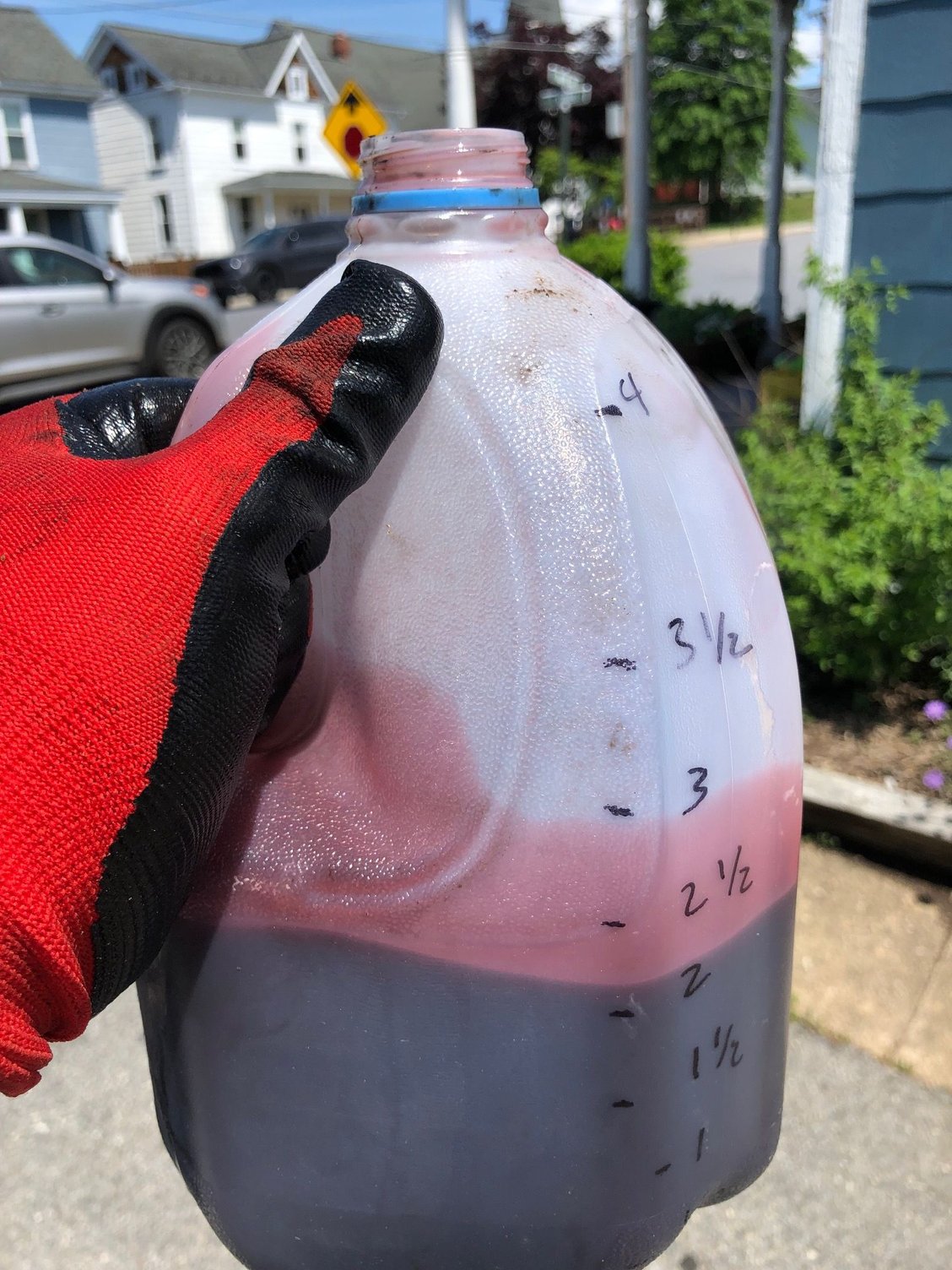

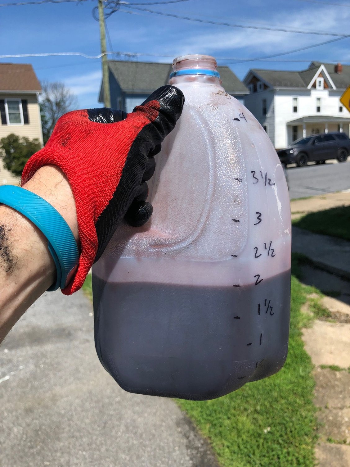

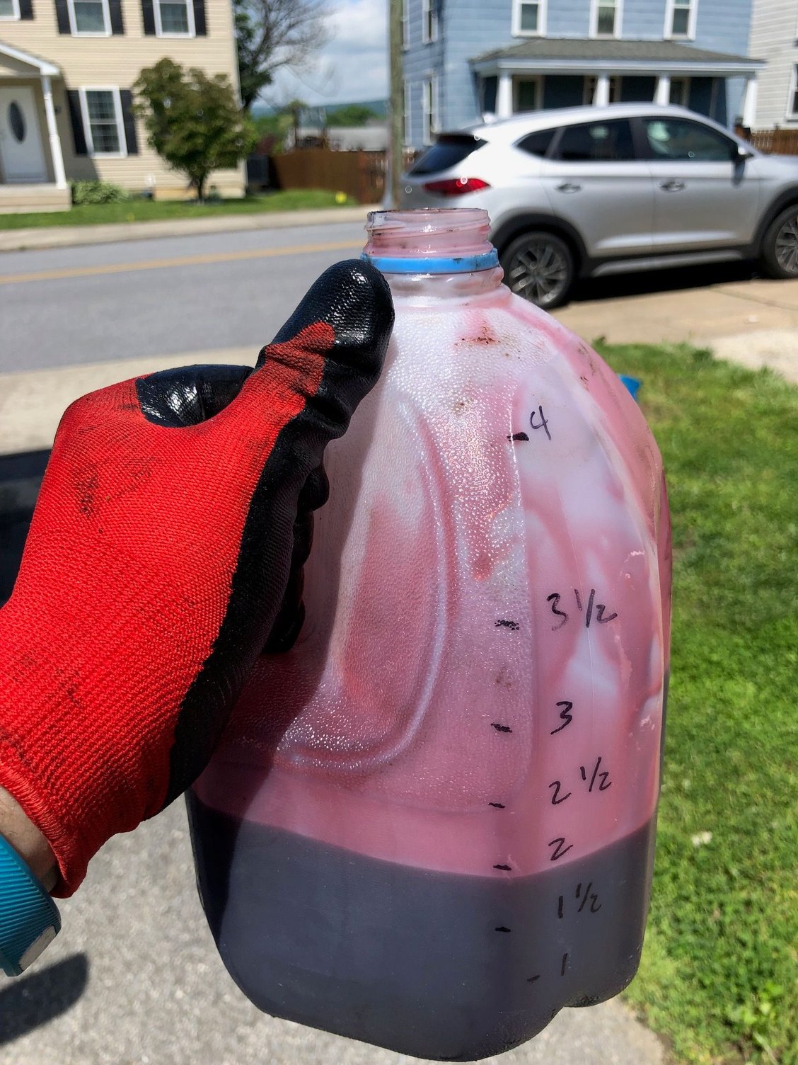

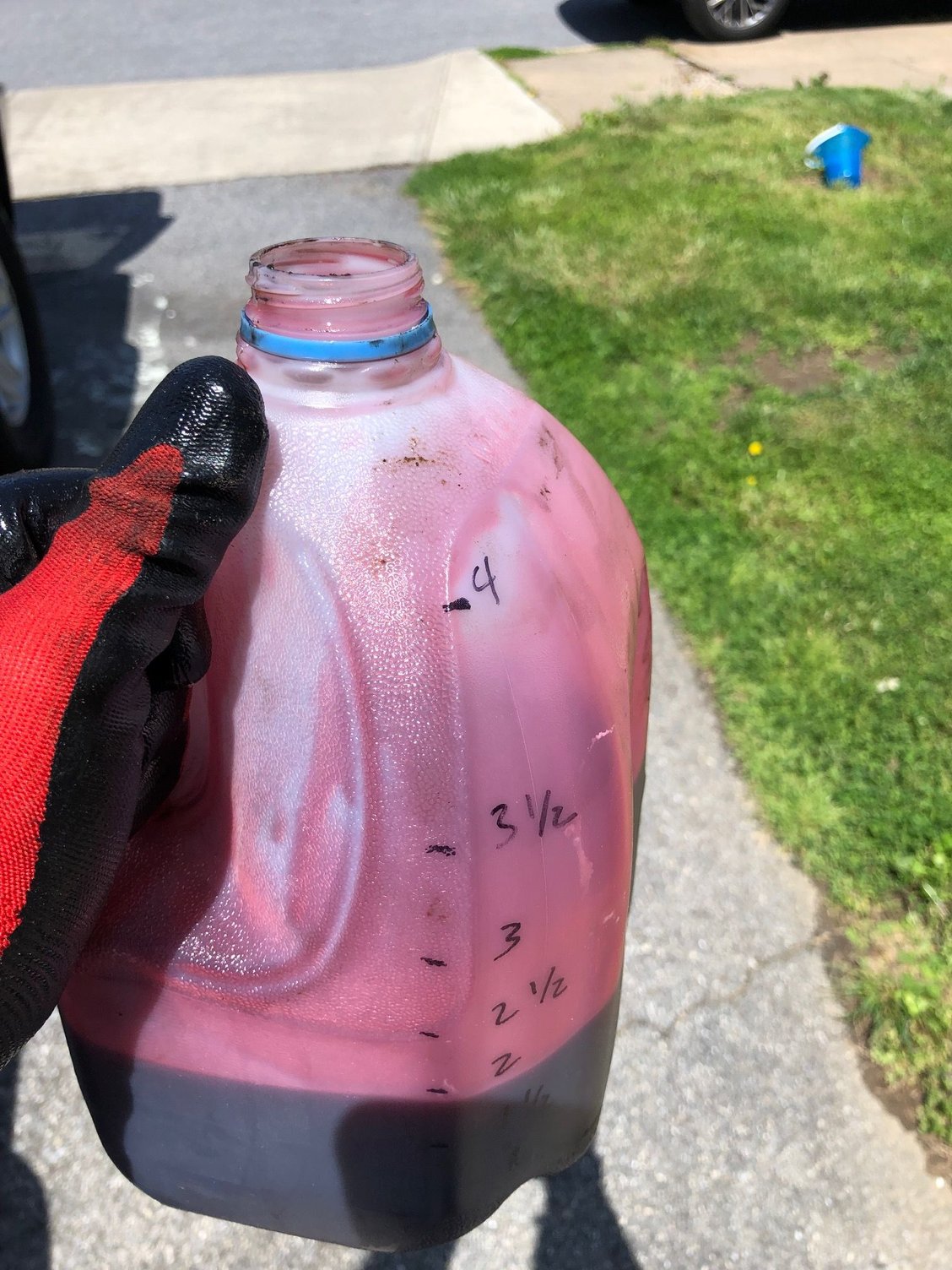

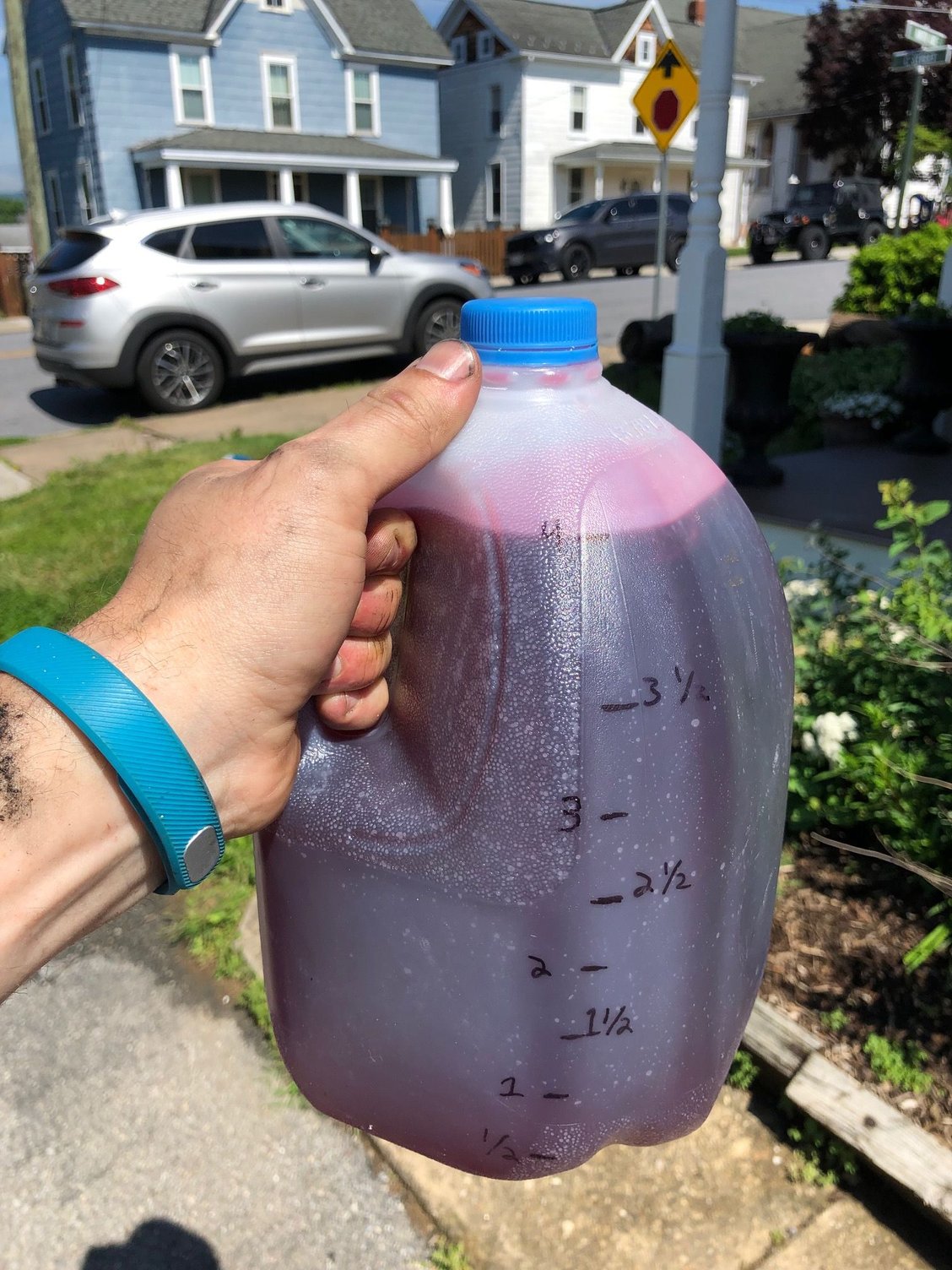

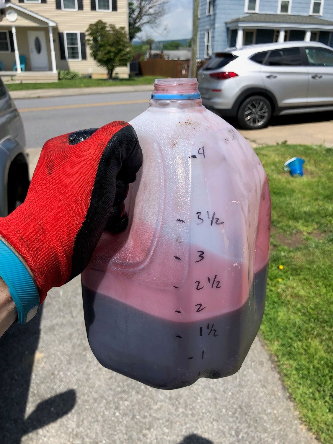

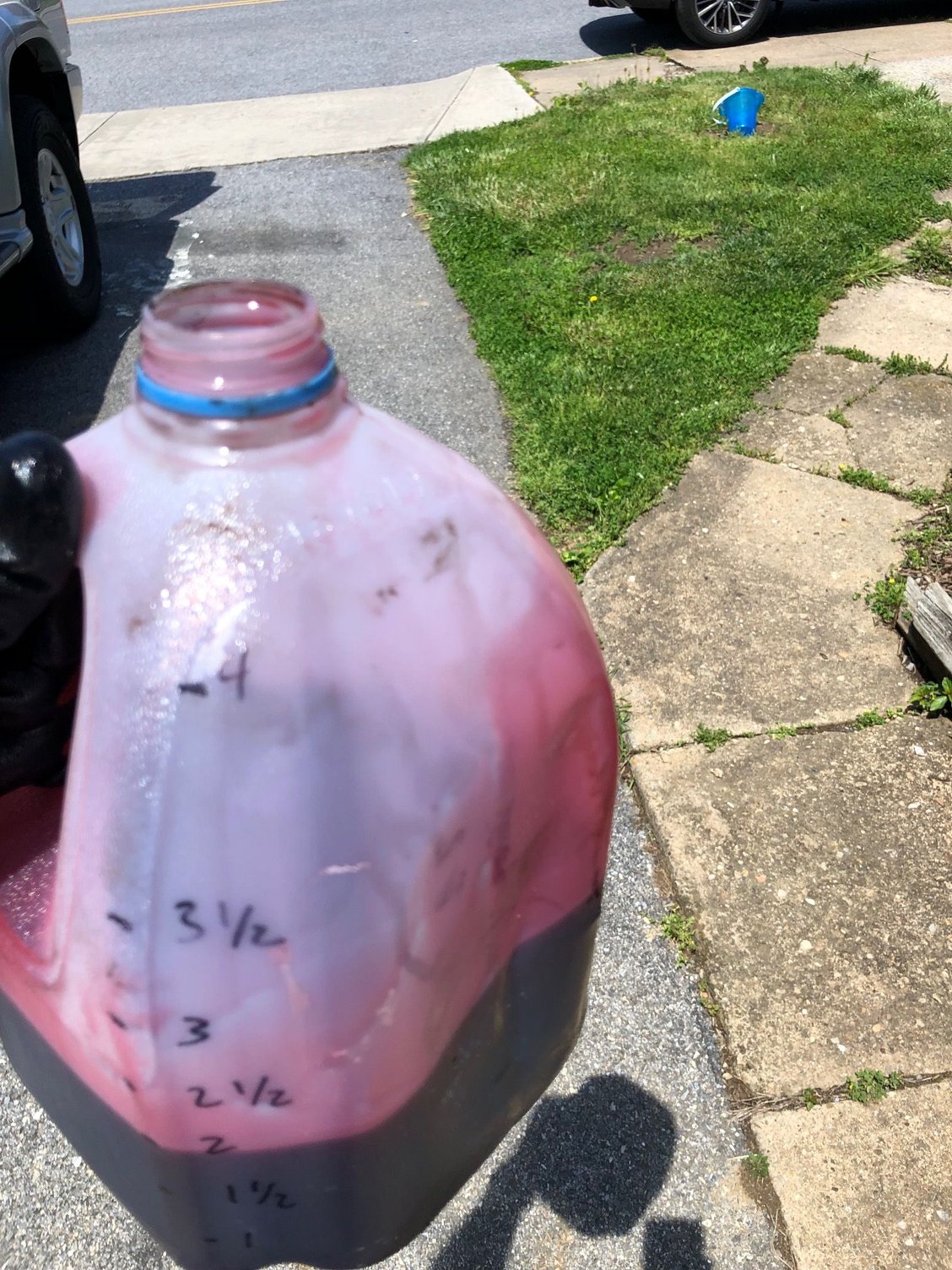

So I got more done on my days off than I thought I was going to. I was able to drain and change the Front and Rear diffs, and the Transfer case with some Valvoline SynPower 75W-90 gear lube. I also ran 5 gallons of Dex 3 thru the transmission and replaced the inline filter.
Fresh Fluid
1st Drain
2nd drain
3rd drain
4th drain
5th drain
6th drain
7th drain
8th drain
9th drain
final drain
Just like the last time I flushed the trans, I used a gallon jug that I marked off in 1/2QT increments. I ran the line from the trans to the cooler into the jug. Started the truck, cycled thru Park -> Reverse ->Neutral -> Drive -> 2 -> L and back over the course of about 17 seconds, and shut the truck off. That pretty closely equaled 2 QTs of fluid into the jug. Refilled thru the dipstick with clean fluid, emptied the dirty fluid jug, and repeat. I was able to do 10 passes of about 2QTs each. The fluid looks really good now, and with my refills I ended up being about 1/2QT short from between the hash marks on the dipstick.

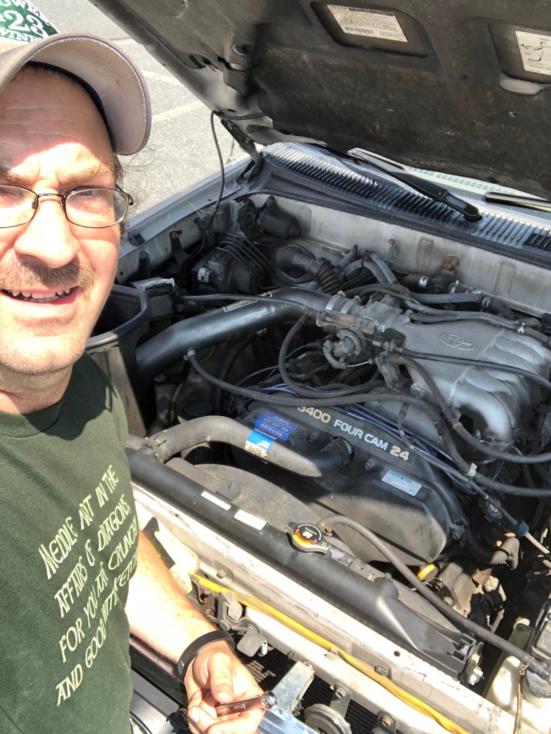

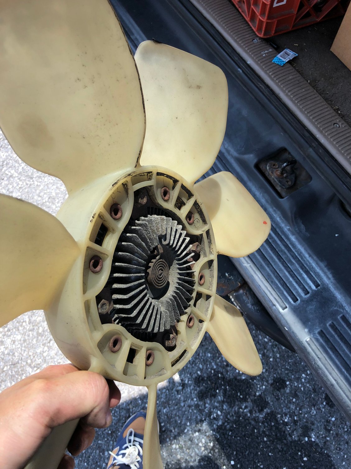

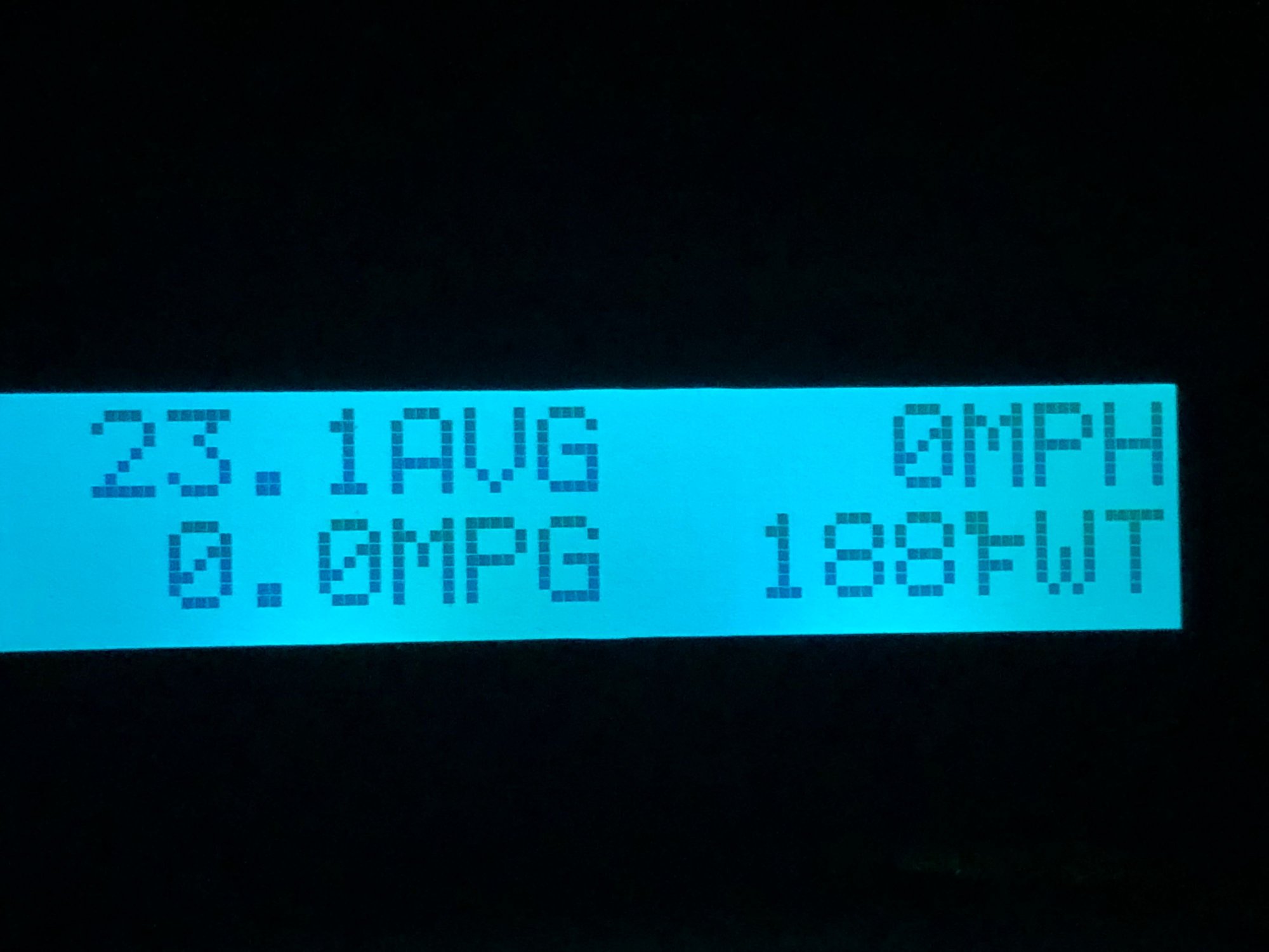

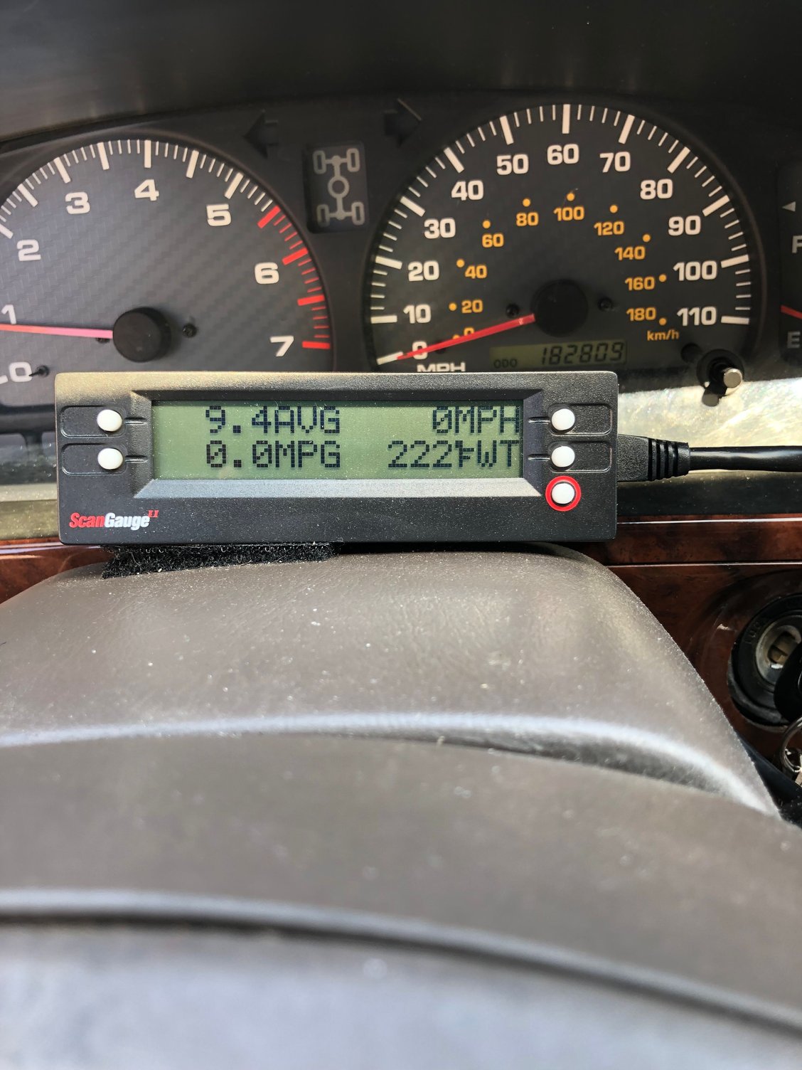

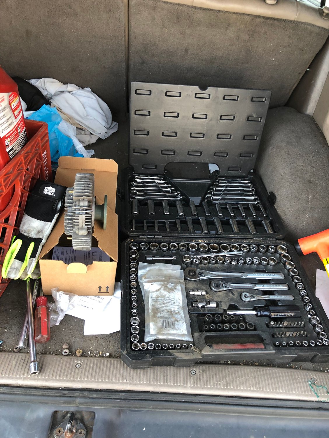

I’ve noticed a handful of times in sweltering heat and humidity with the a/c running my coolant temp would creep up. Prior to the Scangauge I only recognized when the needle would go from the middle to 3/4. I had no numeric data to go with, but I knew this wasn’t great. Now with the Scangauge I’ve not had the needle move but I have recorded some high temps.
Shortly after I snapped this it continued to 227*!!! And I switched to no a/c and full heat.
questioning this in another thread, someone suggested my fan clutch. So while it was hot, I killed the motor and checked the fan and it just free spun. So in 95* midday sun and heat I swapped out the fan clutch in the Advance Auto parking lot.
fortunately I travel prepared. 30 minutes from hood up to hood down. Sitting in traffic with the a/c running I would float between 188* and 191*. I’m calling this fixed… for now.

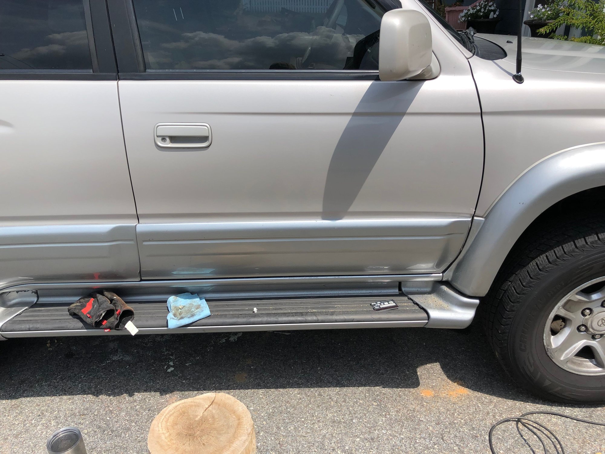

oil change and filter, tire rotation, and assessing damage from the car wash AGAIN!!!
looking at the thread, I missed adding a message from about 2 months ago when I got a car wash and it snapped my newish antenna mast off at the threads. Fortunately they bought me a new mast, although while I was waiting for their response I found a company that sells a 17” flexible mast so I won’t have car wash issues again. Well, at least not with snapping my antenna mast.
Old Aug 5, 2023 | 10:17 AM
  #180
fierohink's Avatar
Joined: Apr 2005
Posts: 1,436
Likes: 95
From: Frederick, MD

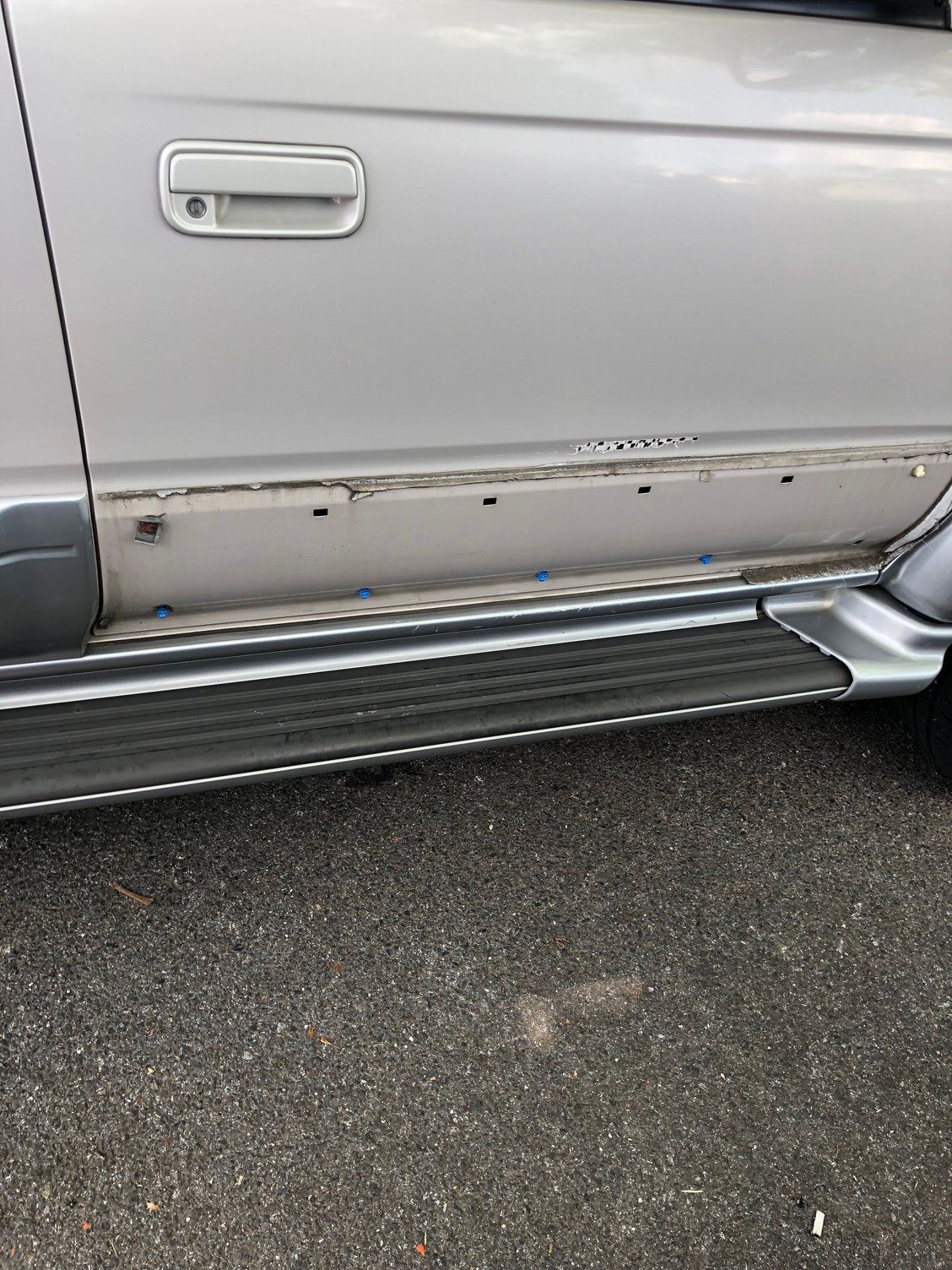

$30 worth of body clips from Amazon, a rubber wheel to peel off the old residue, and we’re back in business.
