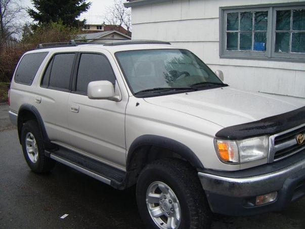

Just found this site and have been amazed at the amount of information here.. Thanks for having a very good Toyota forum..
Here is my 4runner,
Bought it in 07 with 102,000k
Mods:
-Silencer removal: went to Specialty Metals and asked for 2.5 ID 2.75 OD DOM and they cut me a piece for $4.50. My local muffler shops were worthless.
-Turn signal moved to corner lights, used a pair of Honda corner light sockets and used two 18W 12 volt outdoor lamp wedge bulbs to keep it from blinking so fast.
-Custom front bumper
-BFG A/T KO's 265/75R16
-1999 Sport hood with scoop installed
-Custom roof rack with integrated light bar
To come
-Square Sliders
-Rear carrier bumper
-Rear storage organizer
-Suspension lift of some sort, Leaning towards a Total Chaos kit
-Paint the rims black

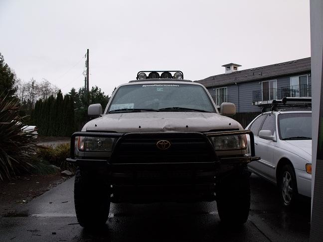

Front bumper build..
After the wife hit a deer it was time for the new bumper. Here is the photos of the front bumper build.. Decided to keep it bolt on and incorporate a winch mount and tube frame.
Side view
Front
Mount
Lower support
Finished without the tube grille guard
Grille guard
Need to finish the plating work..

Thanks guys, I've started on my sliders last week but ran out of tube and Argon but next week is payday so we'll see how much I have left over.. I'm debating to plate the bumper in diamond plate and paint it black or just go with .120 sheeting..
Cody, I use the the top plastic off of the stock bumper to use as temp plates on the sides of the bumper..

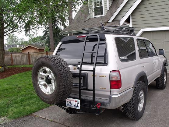

Rear tire carrier
Finished up the tire carrier/rear ladder last night.

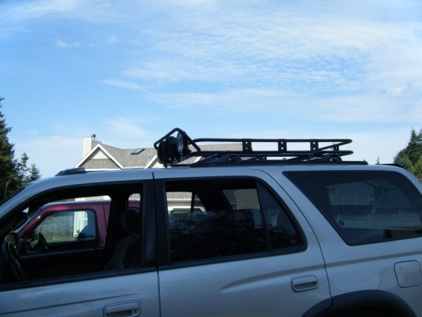

New roof rack
I've been in the market for a new roof rack system since I sold off the one I made a few years back. I've looked at the mega warrior for Yakima and Thule and couldn't pull the trigger on a $400 system and another $100 for the attachments to fit my 99 4runner.
I just purchased a Curt roof rack system and extension from amazon.com and had it out of the box and together in about an hour. it was very well manufactured and 95% of the holes matched up perfectly. The other 5% needed a little force but the bolts did go in and every thing lined up properly.
The mounting system is somewhat universal and can be used on round and square tubes.
I did need to reverse the forward cross bar to add the extra support for the front of the rack.
It measures 62"x37"x4" with extension installed and 41.5"x37"x4" with out
Overall for around $210 for the rack and extension I felt it was a good buy and would recommend it.
