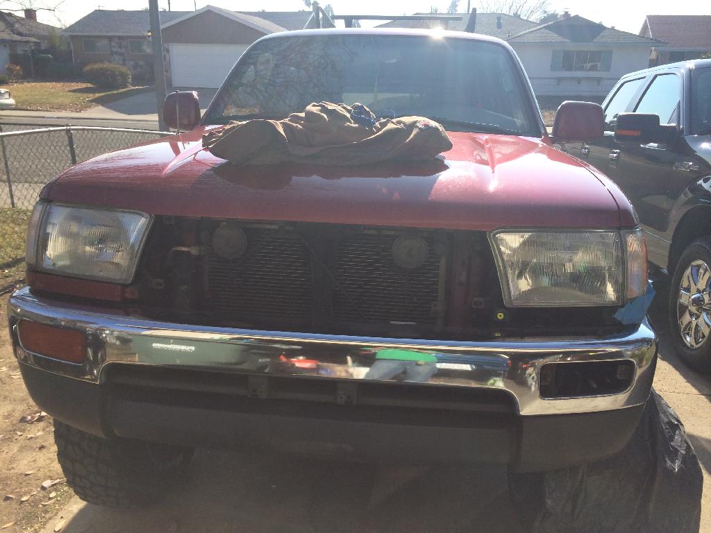

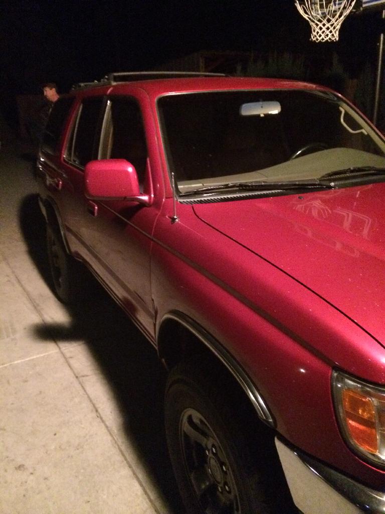

I know i know Pic Time !!!

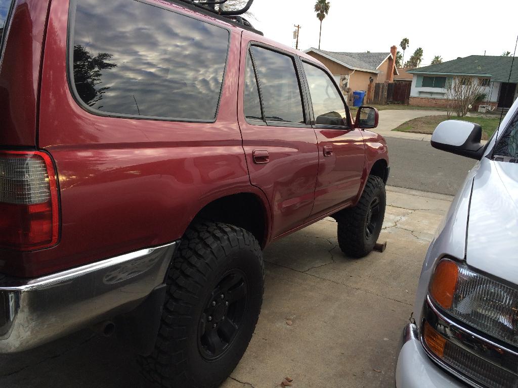

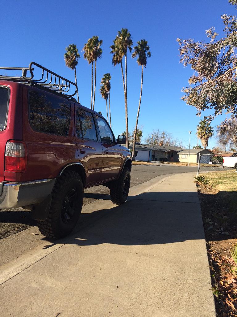

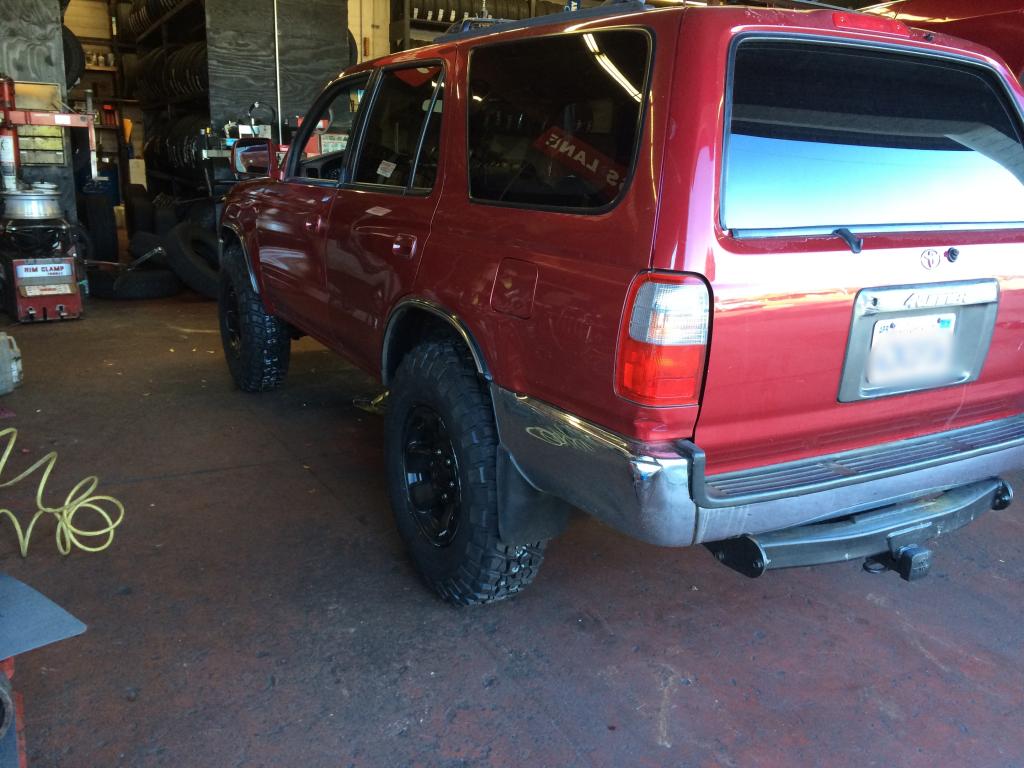

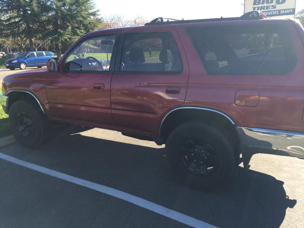

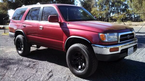

New Shoes

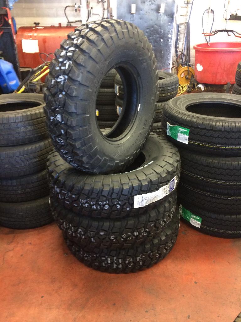

Well the Tires were not cutting it for me and they were old and hard..
So i Got her some new Shoes
255-85r16 BFG K/a 2 ( Done 217.9xx)
( Yes They Do Rub on full Lock and on the Pinch Weld. All stock )

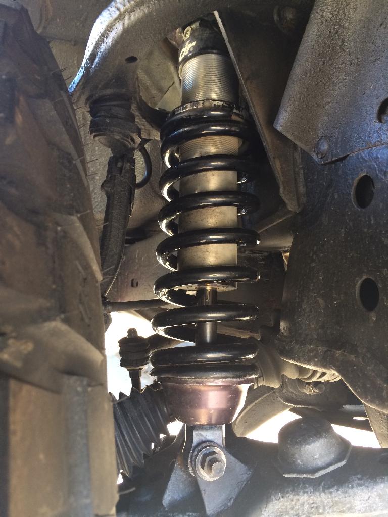

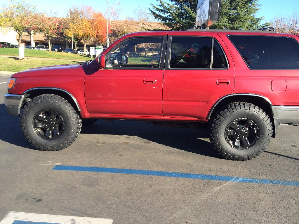

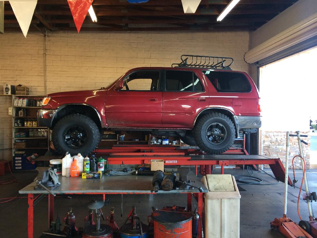

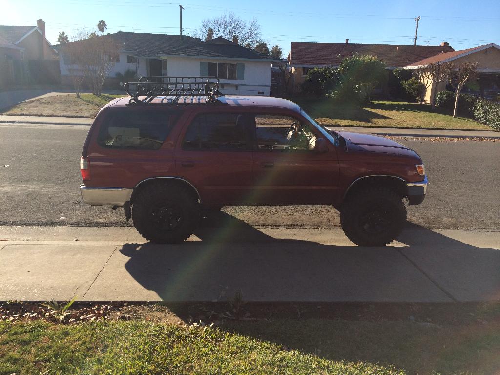

Replaced the stock front coil-overs with some DR/ICON coil-overs
Before
Left side 19.1/2 "
right Side 19. 3/4"
After
Left front 22.1/4
Right front 22.1/2

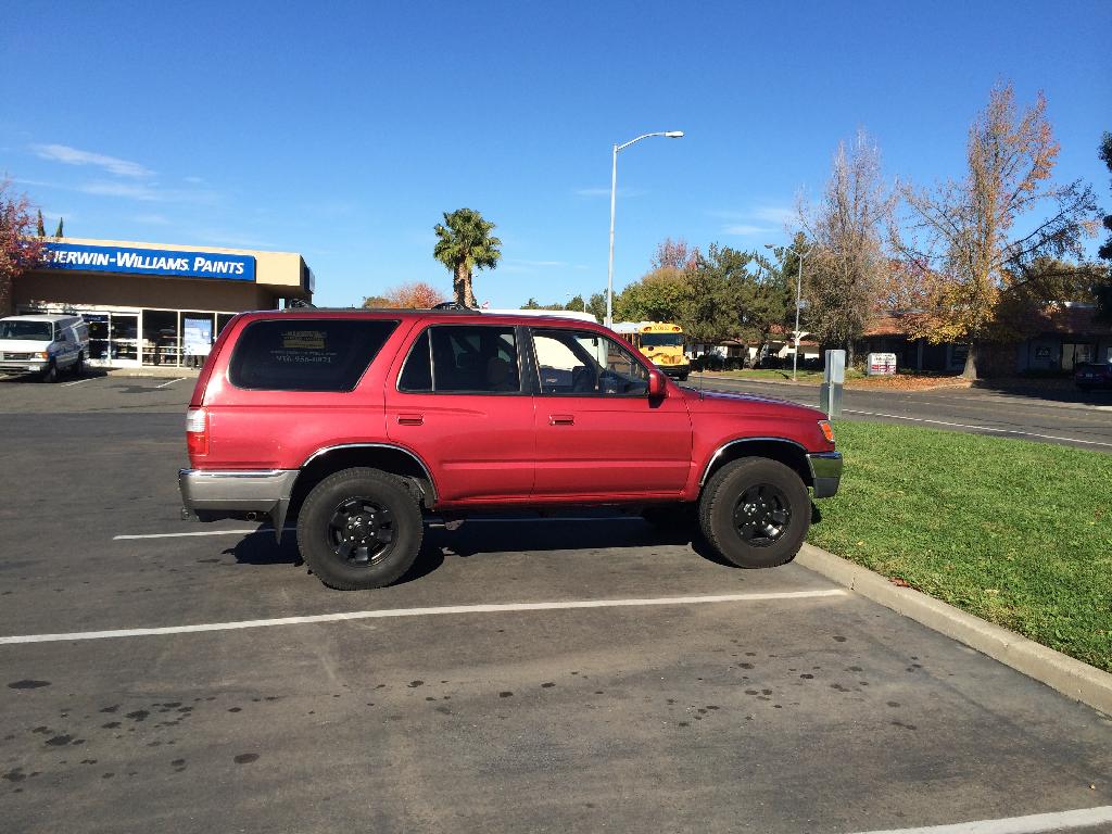

Before Tires
After Tires

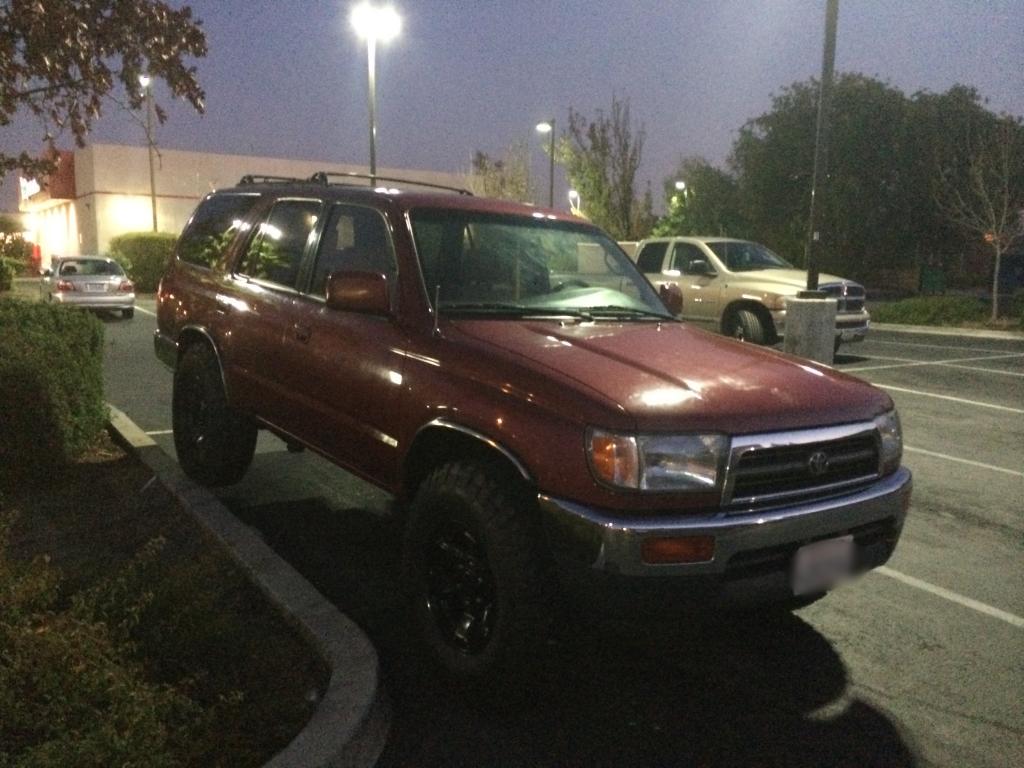

After Tires and coil-overs

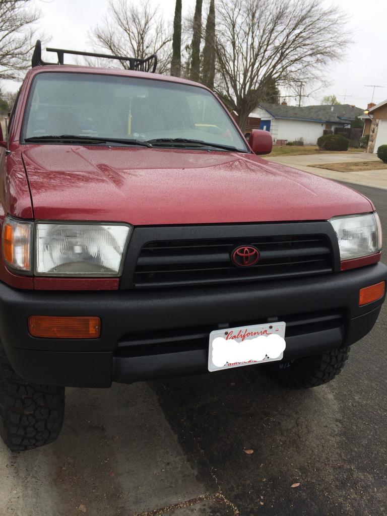

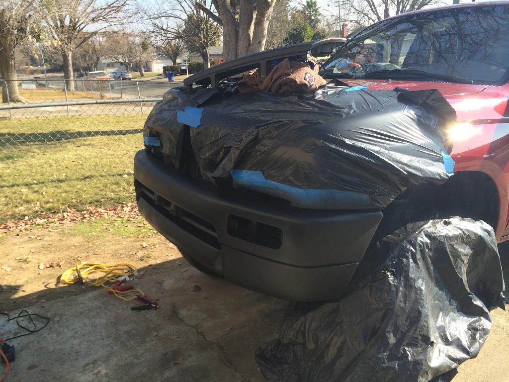

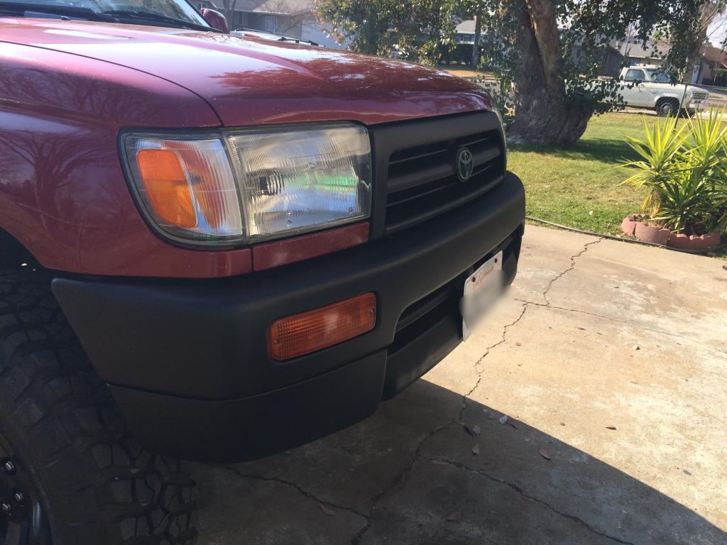

bumper Mod

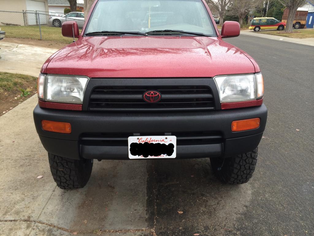

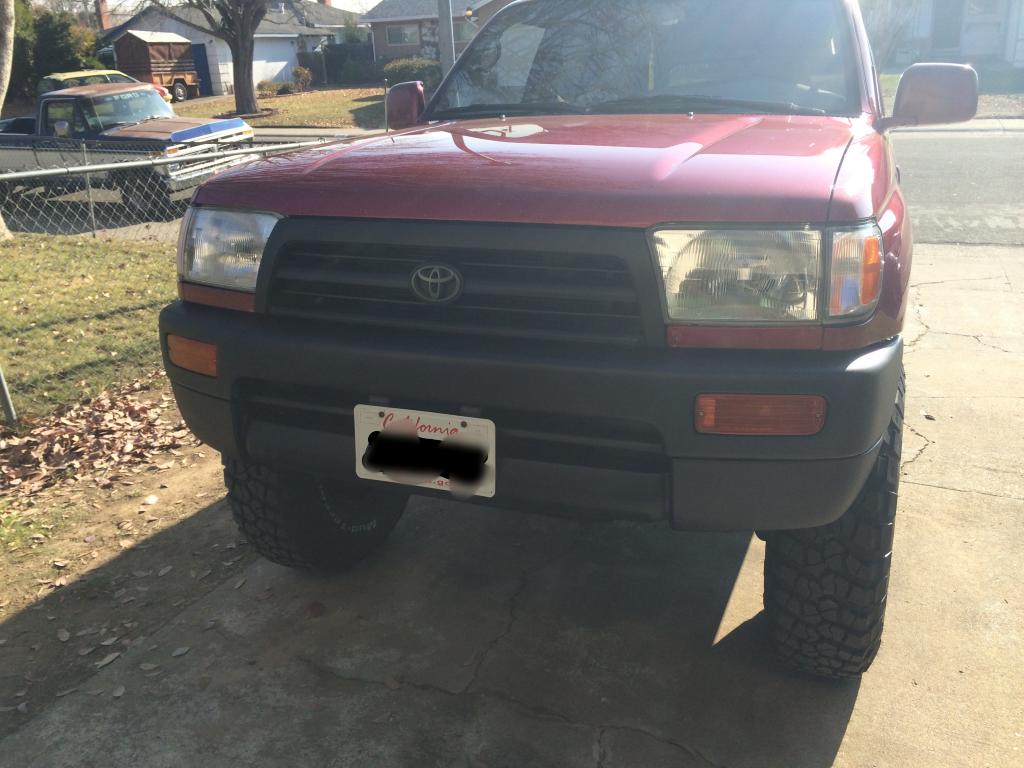

Bored and had a idea for my stock bumper till i can replace it
So i got some
Primer
Spray on bed liner in a spry can
buff pad
sand paper
Taped it off took the turn lights out and ruffed it up and cleaned it and did primer and two layers of bed liner

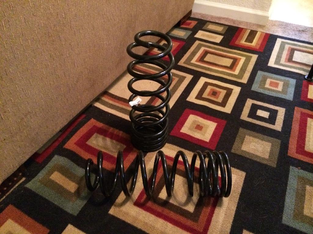

So Coils came in the mail to day!
Going to install this weekend. I have to get some cheap lift shocks wile i wait for my ICONS 2.5 Piggyback's get here!

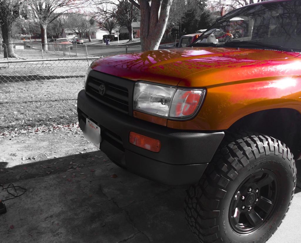

Also Painted the Toyota Logo Factory color.

Like the black bumper front, now you just have to do the rear....
Old Mar 24, 2014 | 03:12 PM
Everest's Avatar
Joined: Oct 2009
Posts: 18
How is the rattle can bedliner on the bumper holding up? Looks great so far.
