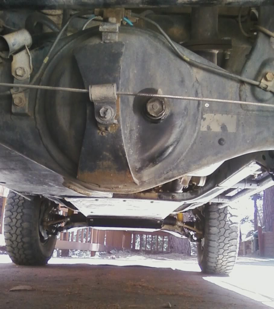

I have a lot of pics of my truck on my build thread, but not very many of the underside. I figured I'd take some armor shots.. some of it's custom, some of it's not..
ARB and front BudBuilt skid..
Front Bud (a little chewed up, but holding up well)..
The Bud belly pan attached to the front skid. You can kinda see the Lil' Skip's gas tank skid too..
Bud belly pan, Lil' Skip's gas tank skid and my 4xInnovations sliders..
Rear LCA mount (just welded plate on them for bashing)..
Side shot of LCA mount (added plate to side to keep bolts from rounding out the holes in the thin stock mounts). They're definitely not as nice looking as the Lotus LCA guards, but they weren't around yet..
Custom rear LCAs that J-money$$$ and I made. They're a poly bushing on the frame end and a 7/8" heim joint on the axle end. The tubing is .250" wall 1.75" DOM. Also, the lower shock mount skids are made by Icon..

We also made some rear UCAs to replace the puny stock ones. These are also a poly bushing on the frame side and a heim on the axle side. The heims are 5/8" and the tubing is 1" .125" wall DOM..
Both UCAs, my diff breather, and my Trail Gear Taco diff armor (slightly modified to fit a 3rd gen diff)..
A closer shot of the TG diff armor..
Custom pan hard drop (made by J-money$$$ and welded on by Driffter33)...
What it looks like under there..
And a shot of the underside of the CBI rear bumper..
