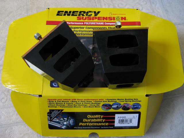

Bump stops..... one more piece to the puzzle.

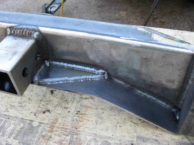

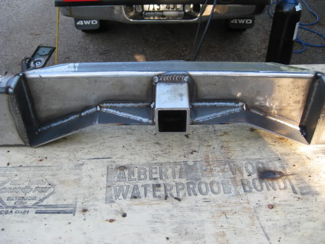

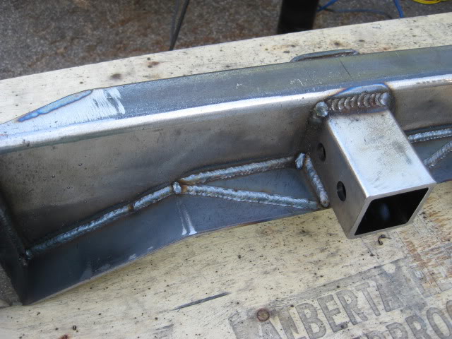

Couple weeks ago I managed to do some welding, windy day but managed to get er done.
I welded the receiver gusset plate and top plate inside seam. These were the last structural welds.

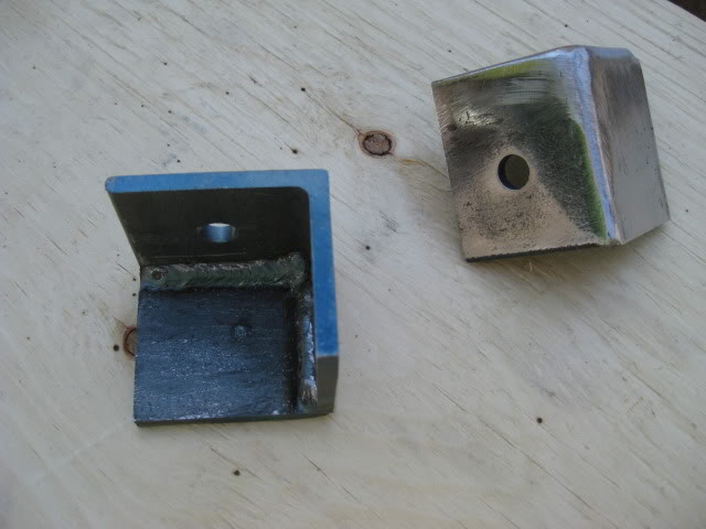

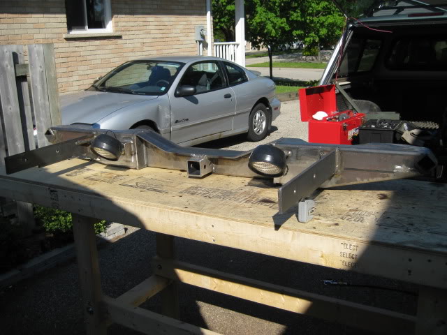

The next scene in this program was adding the rock light brackets.
I used some angle iron and pieces of scrap to form the brackets, then welded them up....
Located the light brackets on the backside of the bumper, allowing for full up / down and side to side rotations for setting the perfect spot light direction. The lights will be up high enough to be out of harms way. The lights I'm mounting are 55w tractor lights, found them at Princess Auto on sale for $7.

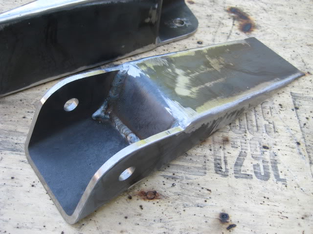

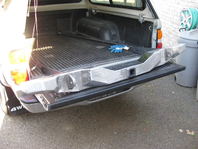

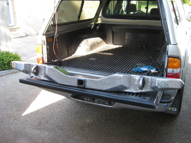

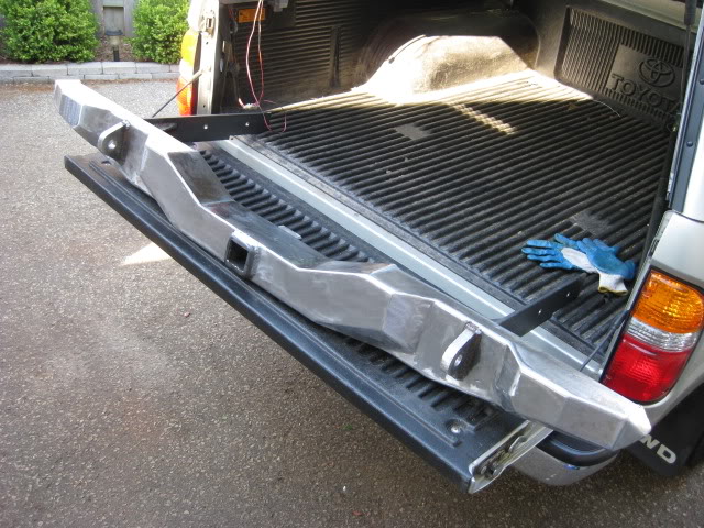

I managed to squeak some time in.
Leave it to me, to destroy the peaceful dinnertime of the neighborhood by grinding up a storm.......
I did a once over with a flap disk, removing weld berries, sharp and fugly features....
