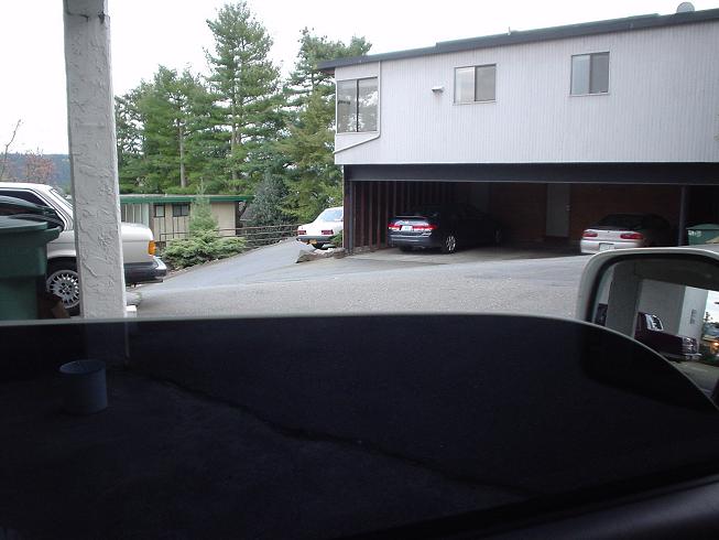

Looking out of 5%
Old Apr 14, 2003 | 08:11 PM
  #47
snappy's Avatar
Joined: Mar 2003
Posts: 63
From: Seattle, WA
and broad daylight
