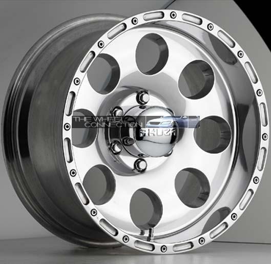

I can get a smoking deal on these wheels, they are take offs of an 07 Chevy Silverado 4wd... They are 17x9. Will they fit?
if anyone knows what size tires will fit on stock height? I was thinking 265/70/17 but that 9" wheel worries me..

9"... I'm thinking you need some serious offset, but I am not sure.
Do you really need a 9" wheel? I'm sure it's a good deal, but if you don't need it, is it really a good deal?

Maybe, maybe not. The only way your going to know for sure is to put them on your truck. Backspacing could be different, and the center hole opening for the hub could be different too. Also, 2500 and 3500 silverados are 8 lugs so if they are for those it wont work since yours is a 6 lug, which only the 1500 is.

do you have any lift under your 4runner because i'm thinking it might also scrub a little

My truck is stock height, stock everything. I dont really need/want a 9" wheel but they are brand new and I can get the set for 200$... They are off a 4wd 1500 so lug wise I know. But the reason I was asking was for the hub size and offset.
I will try them out, but I thought so many of the people on here know soo much that they might be able to say real fast yes/no on the hub size. Also I am trying to find out about what offset they are. I am thinking that they wont have enough offset because of the 9" width, but its worth checking for such a deal.

I found out last night that they have a -12mm offset and the bore diameter is 107.95mm I need to find about the bore dia... There was no markings on the box for the backspacing..

What about the PCD? Toyotas has 5.5-inch PCD.

Sounds like a European measurement for the equivalent of the bolt pattern (IE 6 on 5.5)

PCD = Pitch Circle Diameter, also known as BCD = Bolt Circle Diameter
