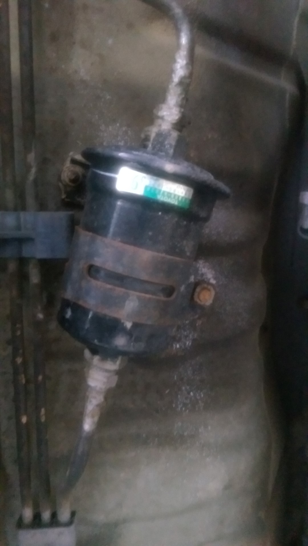

This is my fuel filter. It is oem and has a Toyota sticker and part number on it. Is there any way to differentiate this filter from the stock one that came with the car? I'm trying to figure out if it has ever been changed. How often would you say is good to change it? Thanks
Also my car has 170k miles and I don't know if the wires have ever been changed. They look to be in good shape from inspecting them. Should I change them or keep them if they have the proper resistance? Also do you guys replace the intake manifold gaskets when you remove them to do the plugs or keep them because they are metal? Again Im at 170k miles.

I think the filters are identical. Toyota says lifetime, I do 80k. The factory plug wires were Sumitomos and have the year of manufacture stamped on the insulation, so it's easy to tell if they are original. If they are, they really owe you nothing and I would change them.
Why would you remove the intake manifold to change the plugs? You just unclamp the big hose from the airbox to the throttle body; no gasket involved.

So Toyota states that the fuel filter is supposed to last the life of the car and not to change it?
No stated change interval. But a few of us have cut them open at 80-100k and they look like something you would want to change.
