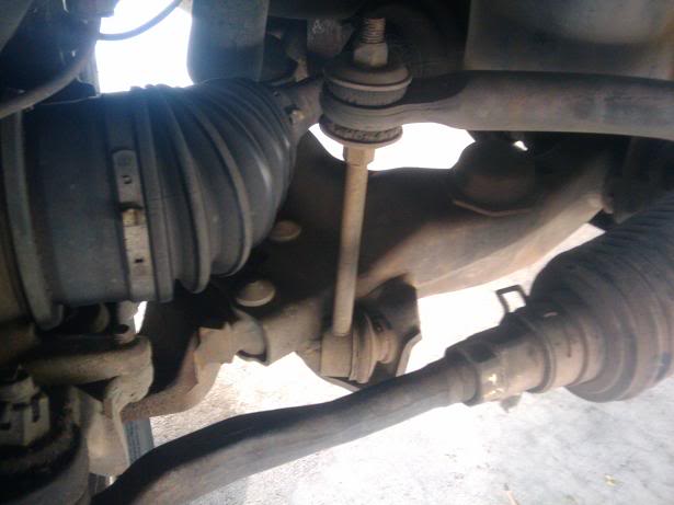

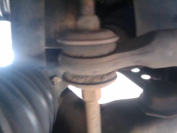

i finally got some pics today check them out and let me know whats up. once again thanks for all the input!!

214K on it..only immediate worn thing you show in the picture is the sway bar connect bushings...if those are worn more than likely the tie rod ends, wheel bearings, ball joints are worn too..
if it is as bad as you say get this thing fixed..
