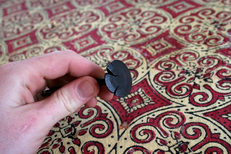

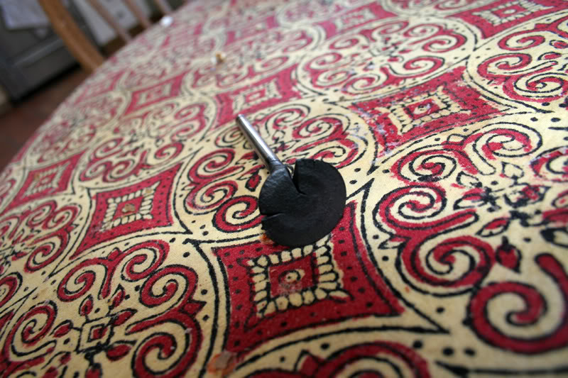

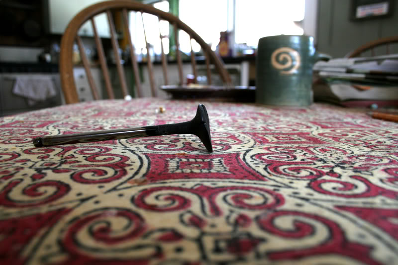

so the previous owner of my 4Runner never adjusted the valves in the 180k that he had it. not long after i got it, it began to run badly and i had a flashing check engine light. anyway, the compression test came back zero and after pulling the head off, this is what one of the exhaust valves looked like

nice huh?

yep. valves have already been done, cleaned up the head, everything is back together and it is running like new!

That valve is obviously burnt crispy. Did the machine shop give you any indication whether that valve was stuck open or if the other valves were out of adjustment. Usually burnt valves are sticking valves, valves that don't seat properly or valves that are to tight. Anyway, I bet it runs alot better.

What the h@11 ate that valve? That looks like severe overheating to me. Did that come from #6? Not adjusting the valves will lead to zero clearance and no compression. Toyota has failed us again with the use of specialized shims. Something the average guy can not deal with thus a guaranteed trip to the stealership and lots of money to reset the valve clearances. Now, if the design team had put a tapered screw on those shim pods, valve adjustments would be simple for any person with some skills. But no and the 3.0 adjustment disease continues into the 3.4 and beyond. Yes, one can argue that the design is simple and very reliable. If you got lots of money, no need to complain.

the valve was not closing all the way. it was still moving, but never fully contacted the head so it couldn't transfer the heat off the valve. and yes, it does run much better. when it was idling, it felt like i had a huge v8 it something but i had the power of a 3 cylinder....which i did. now i can actually keep up with my friends 3.4L
