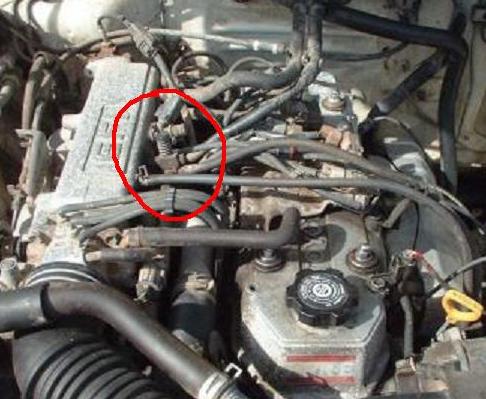

I cant find anything in my Haynes as to what this is. Any ideas?

That's the vacuum adjustment knob...
http://www.4x4wire.com/cgi-bin/ultim...;f=11;t=007277
note my comment on that post about taking a picture of the engine and drawing a big red circle around it...

idle adjust for the ac. controlls the vacume used to control idle with ac running.
David

I was just starting to have the brake/idle problem too. Thanks a Million.
