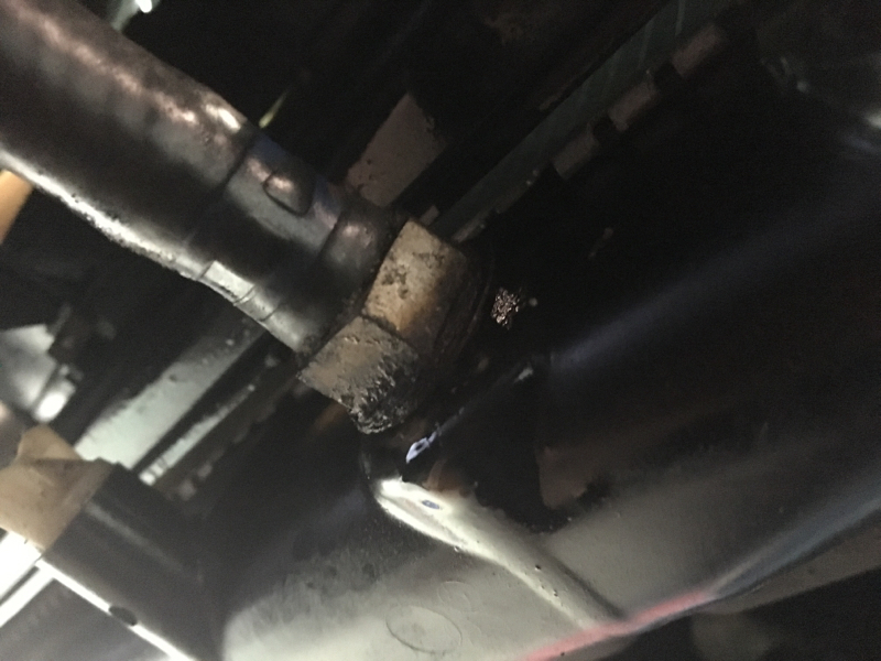

So ... here it is. 2000 4Runner 4X4 Auto 190k on the odometer. Bought the truck 6 months ago, did my usual once over. Test drove it on city streets and highways, ran strong! Checked all the fluids, nothing alarming what-so-ever. Not a single issue until a frightful Monday morning en route to work at 0530 on the highway. 20 mins of driving, no issues then finally the check engine light catches my eye. I look to the left and see my temp pegged out, I immediately let off the gas, and start coasting down. Temp drops down to normal again, still coasting to a stop. I need to get off this busy highway, just pushing it a bit more I accelerate maybe another 100 ft to give me the momentum to get to an off ramp. I get there, felt what I thought was a gear slip.... engine stumbles and stalls. Chocolatey milk substance in my transmission, chocolatey milk substance in my radiator and all over the engine bay. Radiator overflow tank blew off.
I tow it to Checkered Flag Toyota in Virginia Beach, mostly because it was very close, and I was leaving for two weeks the following day. I have them do an inspection, since it's essentially free. Their diagnosis is a bad head gasket ... BTW, I'm still waiting on the results of their "compression test." They also recommend pulling the block to see if the CAST IRON block has warped. I get it .... but barely. I then ask, why would you guys look at the head gasket firsy, when I pointed out to you personally that the same fluid in my radiator was also in my transmission? Their response ... Oh, we'll look at that too.
3 days later, "You also need a new transmission."
Here I sit today (I'm really just looking for some re-assurance that I am attacking this from the correct angle):
I've removed my truck from the stealership and have decided to do the work myself.
--I've also decided to first focus my efforts on the head gaskets. I'll do my own compression test first, but if they all hold 140ish I don't think it's necessary.
--Drain the transmission fluid, flush it, drain it, flush it again and refill, replace filter.
--Replace the radiator as it looks like it's original.
--Re-fill with OEM toyota coolant, not what ever was in there before. I honestly dont recall, but I do know it was green.
--Drain oil pan, as well ... though I didn't see any signs of coolant in the engine, change filter and replenish.
What else should I do?? Of course, if I end up having to dig into the heads, I'll do the timing belt and water pump.

Sorry to hear it got you, too.
Assume the engine is ok(for now) if it holds 140 psi. Your tranny health is the real question. You might consider a full flush done multiple times.
Based on some of the milkshake threads that I have read the odds are not in your favor of a long transmission life. Time will tell.

There have been very few people who come out the other side of a milkshake with just a massive fluid flush.
You have several factors working against you. While 190k miles aren't the end of the world they also aren't the most stout conditions to survive this trauma.
You ran your truck hot enough that it effected performance. The likelihood of your transmission needing a rebuild is pretty high. The likelihood that you got the motor hot enough to blow the headgasket is also pretty high.
