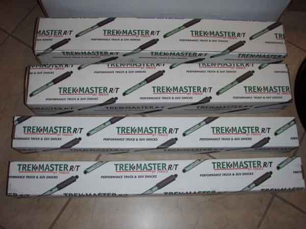

Weekend Project (PICS)
I'm going to install the shocks and coils this weekend...all by myself. Has anybody used the AutoZone coil compressor on the PP coils yet? The last thing I want to do is take it to a shop and have them do it, I don't trust anyone, I'm very anal.
Attached Thumbnails Weekend Project (PICS)-all.jpg   Weekend Project (PICS)-wheels.jpg   Weekend Project (PICS)-shocks.jpg

Well, part 1 of the weekend project is done.
Here she is on stands.
PP 1" coils with Tokico Shocks (Front).
PP 1" coils with Tokico Shocks (Rear). I also used OME 10mm trim packers, so it sits a little higher in the rear.
Here is the final product. It took me about 6 hours since I did it by myself. I also removed the runningboards.
I wanted a mild lift since my rig is a 2WD, mainly for aesthetic reasons. The Performance Products Coils were the perfect solution. Based on the research I did on this forum, I also installed OME 10mm trim packers in the rear since most of the members stated that their rigs sat slightly lower in the rear. The combination was perfect as you can see. The ride almost feels like stock and I don’t have any issues with vibrations on the freeway due to the extension of the 2WD shaft. After the lift I did notice positive camber in the front, but I hope an alignment will take care of that. I am also debating if I need to adjust the panhard bar because the difference is minute.

How'd you like the Tokico?
Also, any troubles with install?
Skrillah, the only trouble I had was compressing the springs, it was a pain in the arse. Tokicos ride smooth, almost like stock, not harsh at all.
