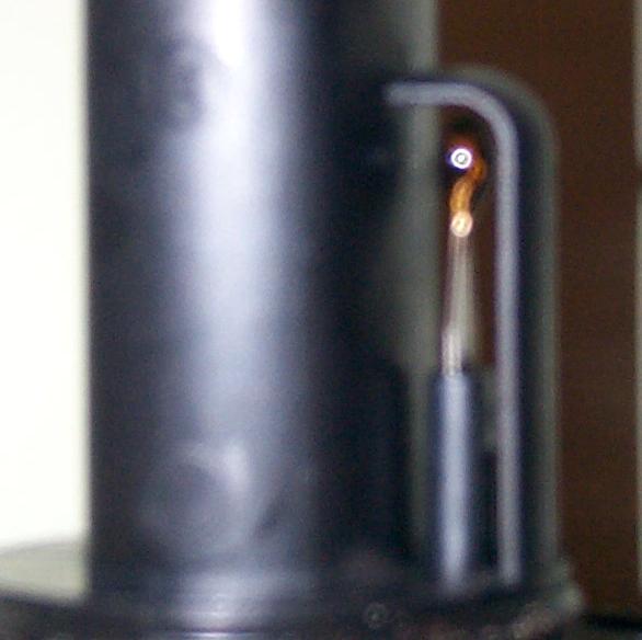

here's a crappy pic of my MAF. notice the substance at the top. it sort of looks like a caramel/sap type of substance.

does any1 know if that is what a clean MAF should look like for a 2001 4runner?
