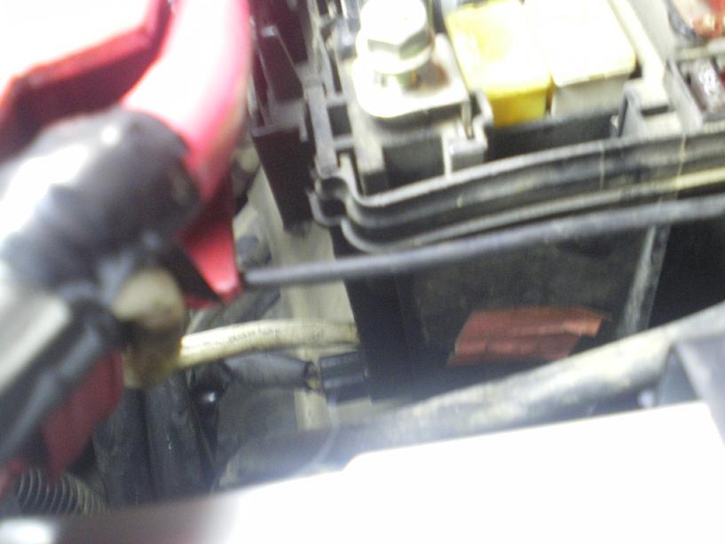

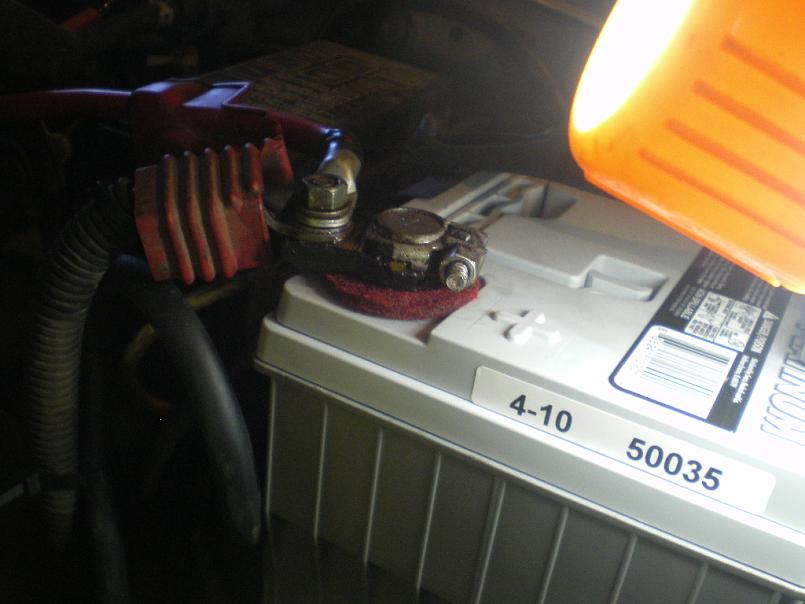

Thanks for the info. I took a couple of photos for clarity. The battery is very close to the alternator.
Thanks
Bill

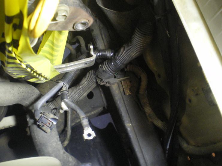

Here are some more photos. The first photo is of the three wire harness and the white positive from the alternator. The second photo is where that white wire exits the fuse box. The third photo is where that white wire connects in the engine fuse box. What is that, that it connects to with the nut? A fuseable link? It says >PA66< SAE PA66, what does that mean? Would I need to upgrade this?
Can I replace the wire in the second photo that exits the fuse box and if so how would I pull it out and place a larger one in?
Thanks
Bill

If you unbolt the fuse box from the fender and turn it upside down you should see where the wire goes in and connects up. You might have to enlarge the opening some for the wire to fit.
You can replace the factory wiring with bigger cable, or do like I did, and just piggy back another wire in parallel and basically double it up. IIRC two 8 gauge should be about equal to one 4 gauge.

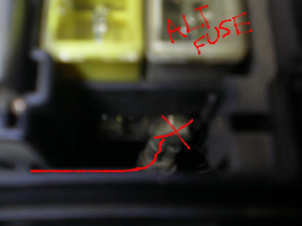

I see now, I looked and found that white wire connected to the 120 amp alternator fuse. I took a photo of it and painted it red. It is dusty and dirty and I did not see it before!!!
I see now, so I either need to replace that wire and the one to the alternator with a big one or add one in parallel like Mt Goat did.
I just need to find the wire and the fittings.
Thanks
Bill
