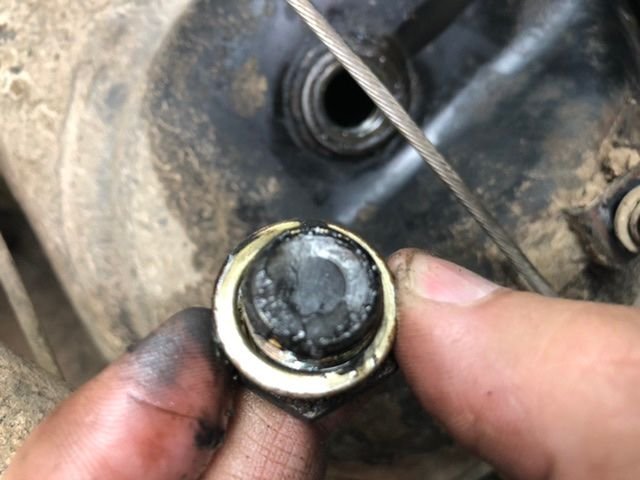

After letting it sit another two hours it just took about ten seconds per plug with flame from a torch and they broke free with no extra effort.
The oil came out a nice, clear medium-brown. I’m surprised because my on bought this truck over for years ago and has literally driven out coast to coast, going to school in LA country and having internships in Chicago and NY City.
There was some silver crud on the bottom plug. It looks like anti-seize but I think it’s more likely just microscopic shavings because the to plug didn’t have much at all. Here’s the bottom plug.

The drain plug is magnetic and the pasty stuff you see used to be bearings or gear teeth. The amount shown in your pictures is totally normal and nothing to worry about. If you pull the drain plug and see actual metal chunks then you should probably worry.
