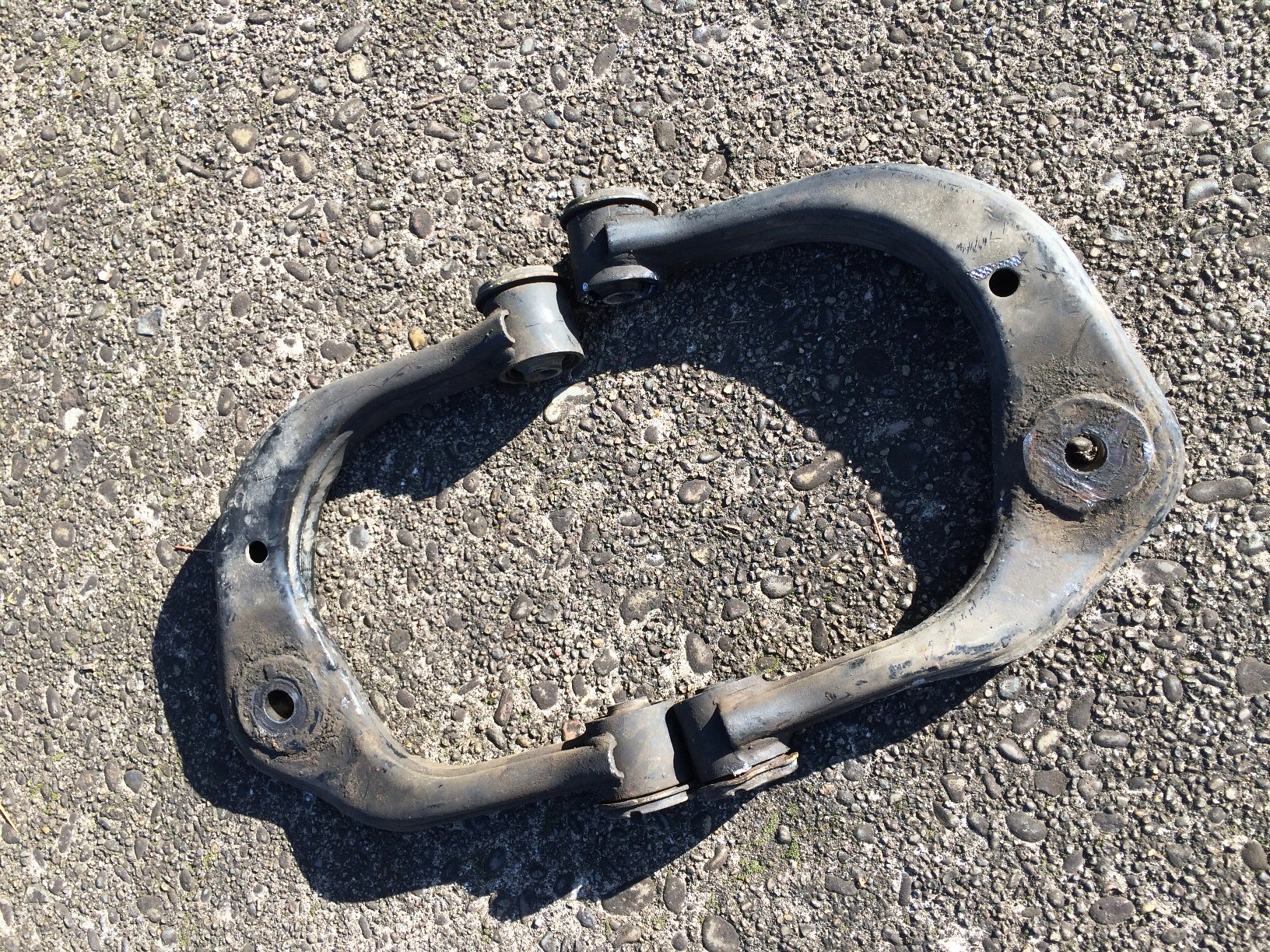

So I'm going to bring this post back just as an update. If you are thinking of doing your upper control arm bushings yourself.....DON'T! Lowers - no problem. I've spent the last 13 hours trying to press the bushing out of my UCA's and have failed at everything but bending my control arm. I tried the bottle jack trick that worked so well on the UCA's and here is the result. These two UCA's should be the same width.
So I ordered two Ikon uni-ball UCA's....darn.

use a torch!

I'll know next time to have a torch on hand. At this point I'm not sure if I bend them back if I've compromised the structural integrity of the arm or not?
