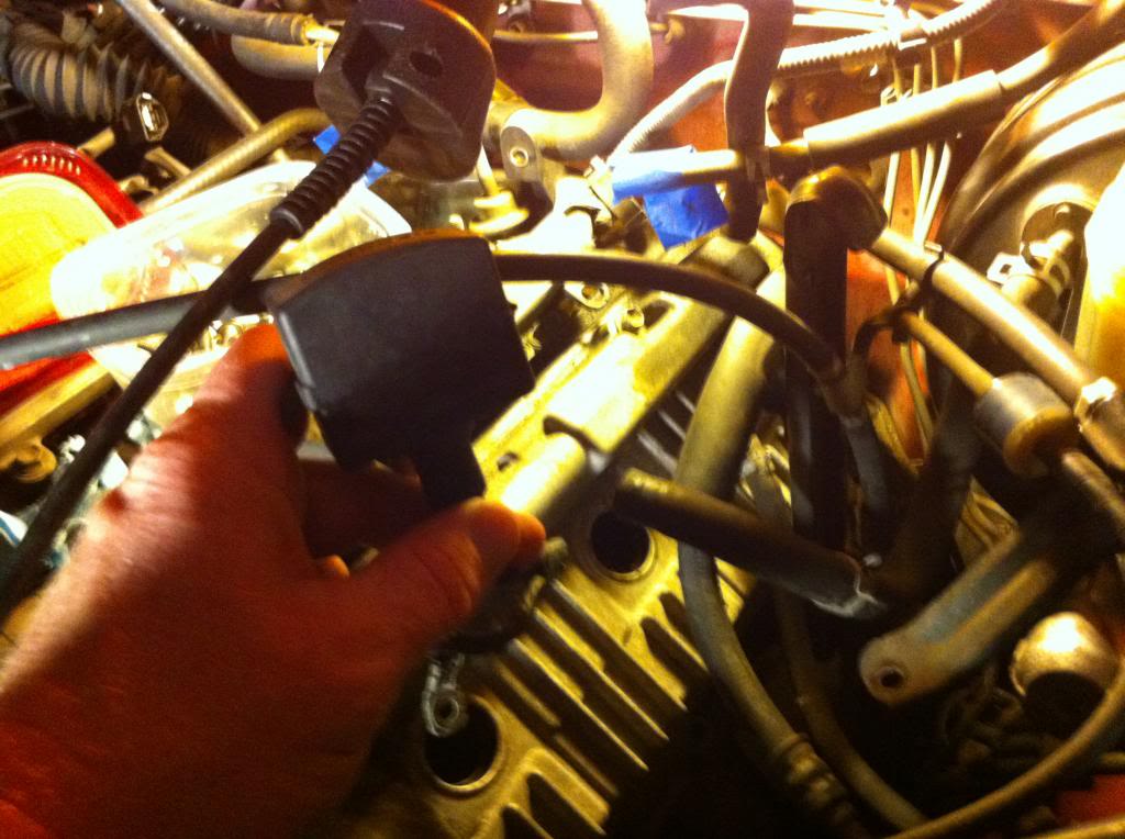

the drivers side cover isnt coming off
the wire loom wont move out of the way
or, do I need to unbolt that metal brace that runs up to the outside of the cover (supports some lines and such)?

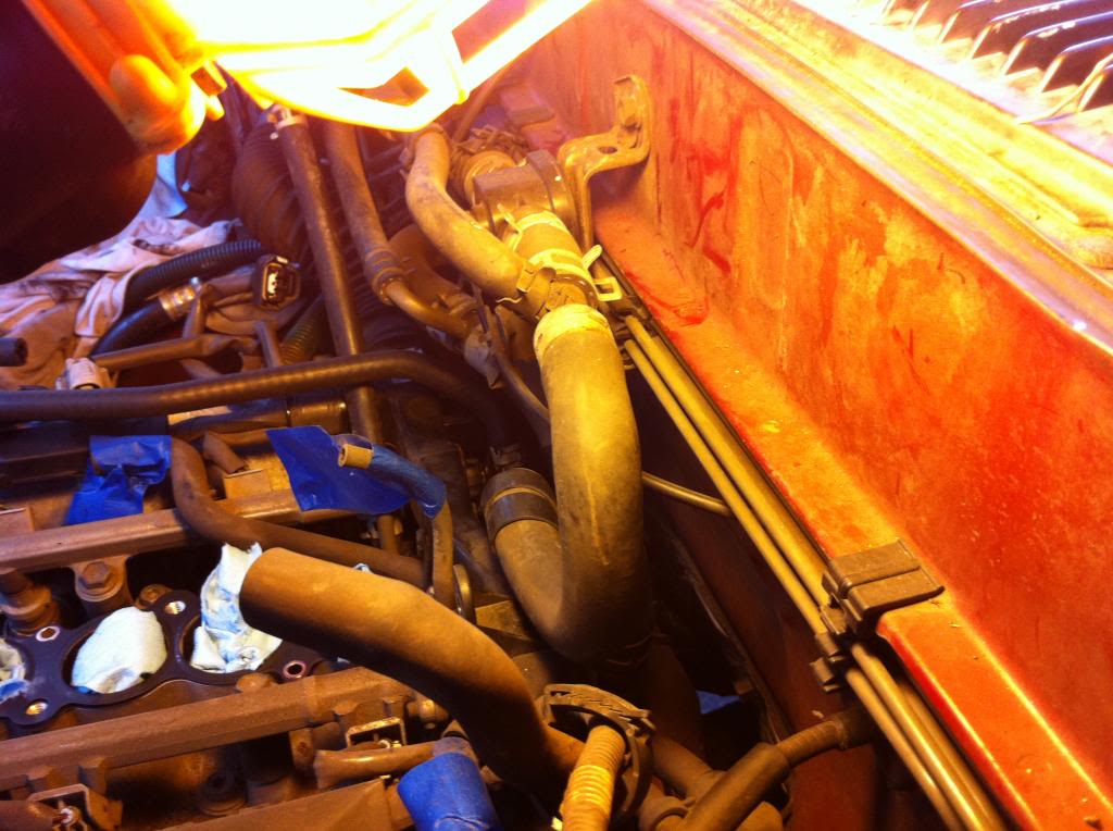

also, I'm replacing the two heater/coolant lines off the rear of the block, as it looks like one is seeping a little, and would be impossible to do without removing the intake

dealer wants 47 dollars each for 'em
I'm figuring this is because you cant buy them anywhere else ?
do I have any other options, or do I have to pay the dealer?

IIRC, there is a clip on the front of the wire loam near the water outlet that may not be unsnapped. I think when I did just the valve cover gaskets, I did remove (or loosened?) that brace for some clearance. It was tight getting the valve cover off, at any rate. A bungee cord works good for gently helping to hold up the driver side wiring harness.
One of the online Toyota OEM dealer in my sig may have save you some $$ even with shipping. Do you have the hose part numbers by chance?

I will look for a clip for the wiring harness at the front near the thermostat
I'm thinking of just getting some generic coolant or heater hose from advance auto as the bends don't look to drastic
Just a little worried bout quality

The clip I'm thinking of is up top in the front where the loam makes a 90 deg turn to the right. There may be another by the thermostat housing/alternator too.

As RWOregon said, I think the problem is with the clip; if I remember it is top left area of the driver's side valve cover if looking from the left side of the 4runner.The driver's side IMHO is much more difficult in removing.
I'd go with the OEM hoses. I have never heard of anyone replacing them, or having them burst, but now is a good time as ever to replace them.

I disconnected the clip for the wiring loom that connects up to one of the bolts on the thermostat, and it gave me a bit more wiggle room.
I'll also look for that other clip you guys mentioned.
I did get the valve cover off, but it would be nice to have more room when installing the cover, as I kind of had to work it back and forth to get it out.

The drivers side cover was the more difficult one, but after following the wire harness in all three directions and unclipping it from all locations, I used a bungee cord to hold it up out of the way.
I also unbolted the metal rod holder thingy that runs below the cover and bolts to the head with a 14mm bolt.
Doing these things gave me wiggle room.
