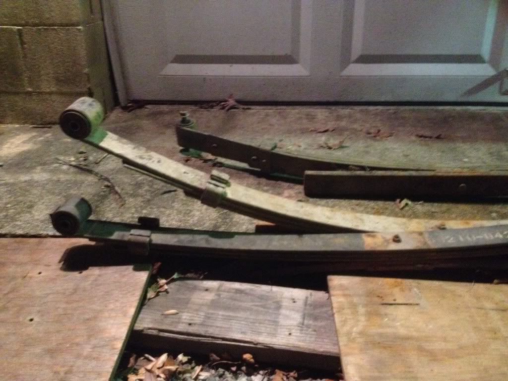

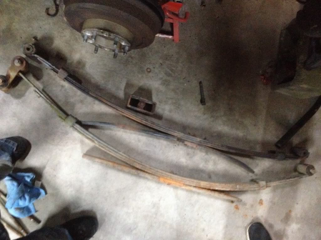

ive been on this site befor for info but havent posted so i figued i would share my info on this topic

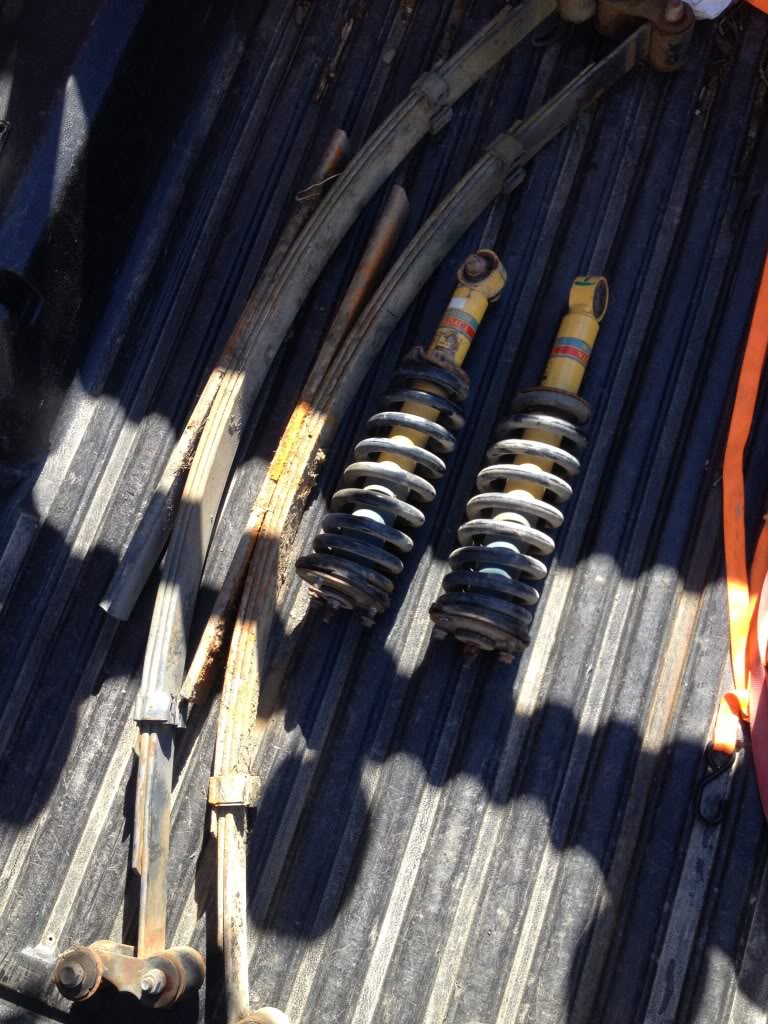

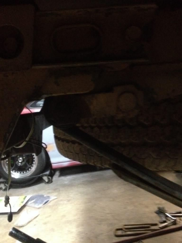

just recently picked up some 2000 tundra sr5 extened cab blisten front shock and rear leaf spring for my 98 tacoma v6 extened cab

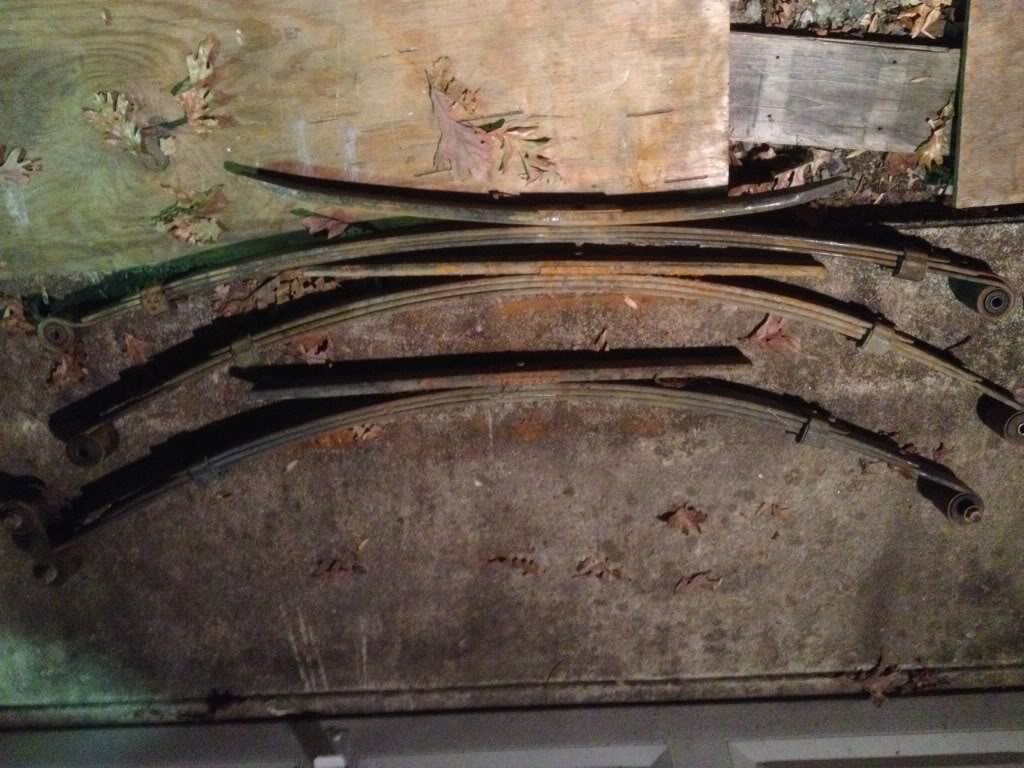

the leaf sping measure the same width but the tacoma are 55" and the tundra are 60"
my leaf springs i was also running 3" blocks

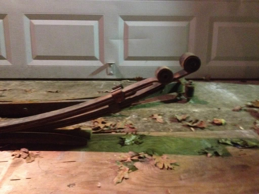

tacoma vs tundra

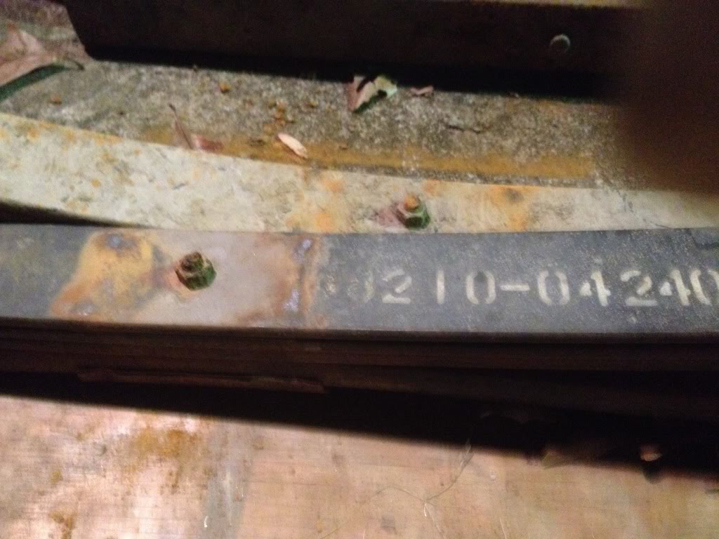

i got them mounted but had to go back to the tacoma leafs becuase the center bolt is futher back causing my drive shaft to come apart when trying to mount the rear end. also for shock it looks like the shocks will need to be atleast 28" long ebake cable needs to be re routed and a brake line will need to be made longer also the rear shackle was resting agianst the frame

Awsome info. Glad somebody actually investigated it. I do feel that the center bolt could be re-drilled to match the tacoma making your driveline work as it was supposed to, but throwing of u-joint angles and needing shims. Not the first time thats been done lol. But still would require some custom fabing for the other stuff and rear shackle to be moved back. And from the looks of those tundra springs they would give you a bit of lift running them on a taco. They are ran differently on the tundra then the taco springs are ran. Reverse shackle and outside the frame rail as apposed to directly under the frame rail, wich is essentially a lifted geometry all on its own, but toyota used a flat spring in that position, as a result, the stock height. IMO a bad spring design on the stock taco's for many reseons. You can see were the appeal of running a semi arched spring would be a world of difference.

i removed the tundra shackle to install on the tacoma. im gonna looking into running a tundra driveshaft if it longer my plan is to eventually swap a tundra 4.7 into the tacoma. i thought about redrilling a hole my consern was that it wouldnt be center on the leaf would that cause problems
Old Nov 6, 2013 | 04:36 PM
ThatGuy1295's Avatar
Joined: Jan 2011
Posts: 1,746
Likes: 6
From: 46 50' 36.82'' N 122 19' 41.01'' W
Well its already not centered on the leafs, just like lots of springs are from the factory. Especially the stock tacoma springs. My thoughts on drivlines for this or any other spring swap are to go 1 piece drive shaft anyways. Besides if you swap engines and try to run a tundra 2 piece shaft the carrier bearing is no where near where the bolts on your taco frame go. 2 totaly different drive shaft setups.
