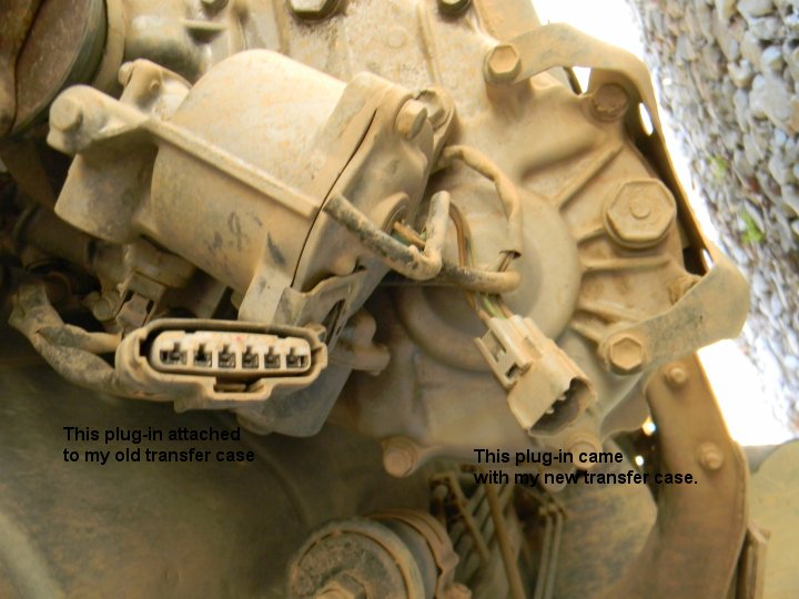

I have a 2002 Tacoma, 4x4, 6cyl, manual. Local mechanic said the actuator motor was bad on the transfer case. Couldn't locate the motor he was talking about, so ordered a used entire transfer case. The case fit and worked perfectly except when it came to hooking up the wiring. Obviously I was sent the wrong transfer case, but the company suddenly 'went out of business.'
Is there any way to just splice these wires together to make my 4-wheel drive work?
In the image, the connector on the left is what plugged into my old transfer case. Wiring colors are (l-r) pink, black & white, red & yellow, white, and blue. The connector on the right is the only hookup on the new transfer case (l-r) black, yellow, light green, then two dark green wires attached together.
Any help would greatly be appreciated.

Is splicing wires even possible with this? Or should I be trying to purchase an actuator motor?

I'd love to help you but I don't recognize that new connector and I don't know what it's from so I can't try to chase down an EWD. The old one I'm used to and I know what the wires do. Any chance of a part number on the new one?

Don't mean to sound ignorant (I am), but where would I locate the part # on the new one?

I was hoping it was on your invoice. I have no idea, otherwise.

Nope, not even an invoice received from them. I got it from Woodfins in VA. Thanks!
