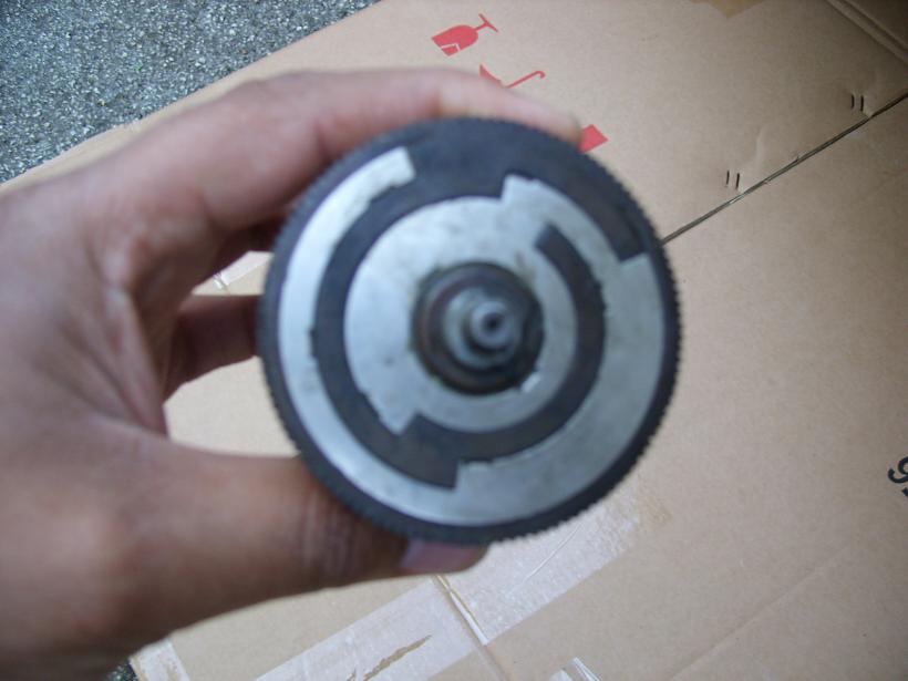

Hey Folks,
Got a MASSIVE problem! Been t/shooting my 4wd multimode system (Goes into Locked centre diff when I hit the 4wd switch for UNlocked centre diff 4wd - flashing lights)
Anyways - I opened the actuator on the transfer case to check the terminals, and thats when the ROTOR/SOLONOID/MECHANISM/THING popped out.
I figured out how to get it back into the actuator assembly (by undoing the actuator assembly & sliding it out on the shaft a bit first).
BUT, the rotation of this thing seems critical. Anyone done this successfully before????
Please help.
ASh.

Some pics of the lil' b@stard
Attached Thumbnails Transfer case 4wd Actuator probs: multimode-actuator2.jpg   Transfer case 4wd Actuator probs: multimode-actuator1.jpg

Sorry for the late reply - I don't know if tacomas have the exact same 4wd actuator as 4runners, but what you see in my pics is the contents of the actuator. This solenoid is a complicated bit of kit (a Chinese puzzle) that could easily pop out when you undo the 3 bolts because it is spring-loaded.
The trouble is knowing what angle it needs to go back in at (getting it back in at all is a mission on its own).
Also, the solenoid seems to have 'in' and 'out' position and I dont know what the default position is.
To make it worse, there are no tech/Toyota guidelines on refitting this. Its 'replacement only' of the whole actuator assembly involving opening the transfer case.
I recommend NOT opening it and check all your diff switches first (if not done yet).
Otherwise, getting another transfer case at the breakers/scrapyard could save you heaps of aggravation.
Another option is to check your actuator motor (insde a black cap on the actuator with 3 screws).
But I have no info on this other than it turns a screw inside the actuator that turns the solenoid. This MAY be your problem.
Check all electricals first
Good luck - keep me/us posted
