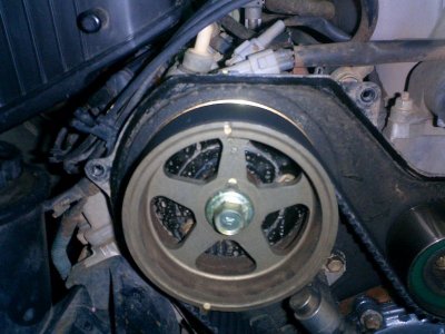

Originally Posted by Dan_90SR5
Also, this might be a huge favor to ask, but if you have to break it down, can you send me as many good pics of the upper idler pulley? I need to know how it's mounted.
This pic he posted shows where the upper idler pulley bolts up. Right below the upper radiator hose connector and right above the water pump pulley.
AJatx- you shouldn't be seeing any belt shavings at all. Did you get the belt guide plate (looks kinda like a big washer) put back on the crank in the right orientation? It has a slight concave curve on the edges that would dig into the belt if put on backwards.

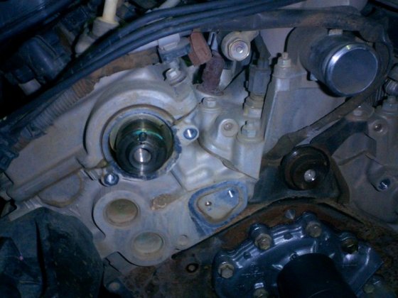

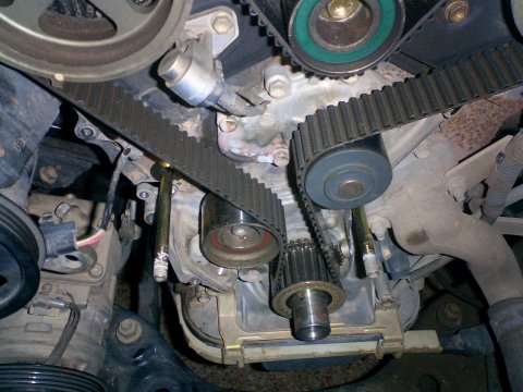

I put the guide on according to the picture.
I went through my old pictures and found that I put it on backwards.
The current pic shows reversed.
J

Here is the original pic of the belt guide.
I'm so happy that I at least remembered to take some before-work pics.
J
