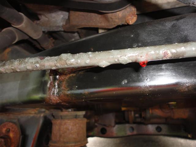

Well I finally got a chance to crawl under the 4Runner today and check out exactly where my steering rack was leaking. Good news, the rack isn't leaking, it's the steel line coming from the pump, here's the pic. So, I'm thinking of just cutting out this section and putting in a piece of rubber tubing suitable for the task. I don't think it's a very high pressure system since there are other sections of rubber hose on this line. Any thoughts or suggestions??? Thanks.

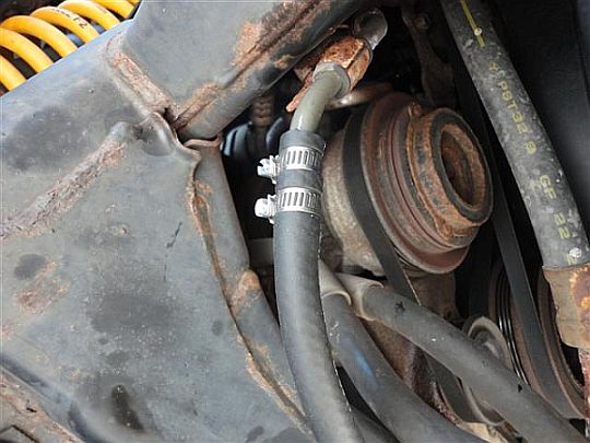

Well I went to AutoZone and picked up some 3/8" trans cooler hose and a few hose clamps. Got home and with my tubing cutter cut out the bad section of line, fitted the new hose, clamped it up and I'm good to go. Total cost...$6.48. Took less than 45 min to do.
