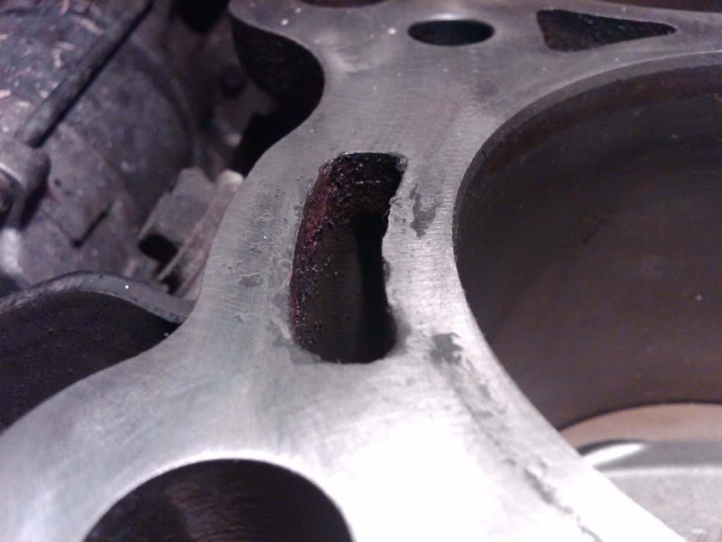

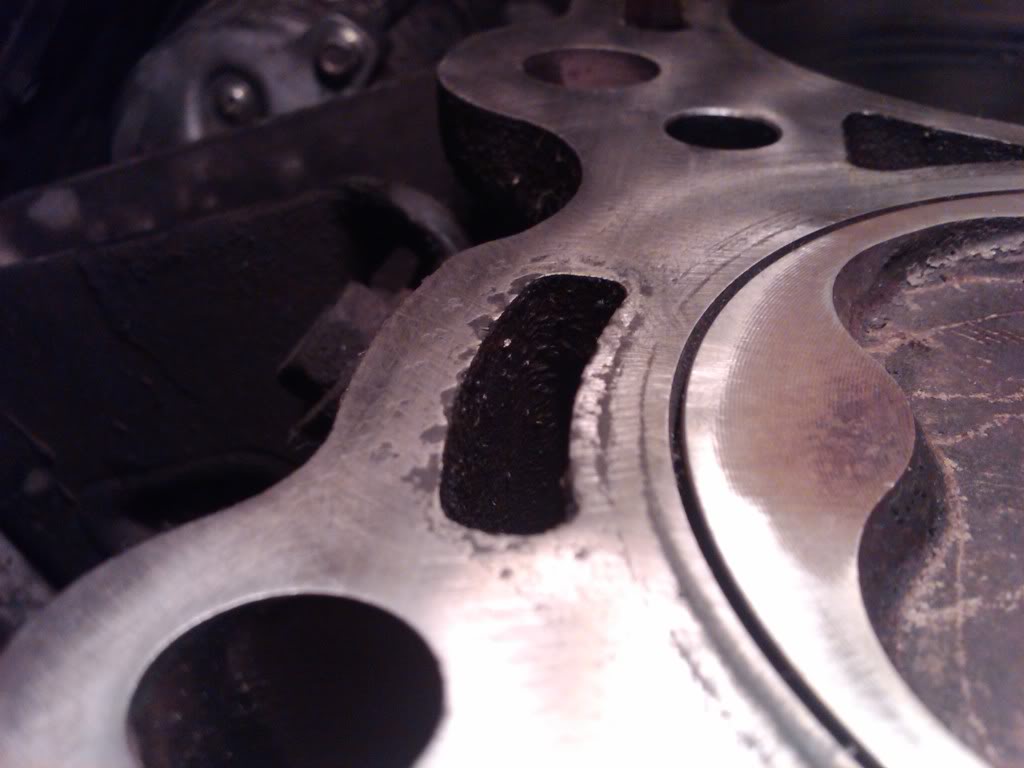

It is a bad head gasket. I'm going to get the heads redone. There is some pitting on the block. Here are some pics of what it looks like. What can I do about this? The guy working on it said he could put some gasket schellac on it. The gaskets were in rough shape, I'm sure the supercharger helped blowing what was left of the gasket. I'm thinking of removing the supercharger and selling it to cover these costs.

Yuk...that's not good. Looks like maybe it was run with straight water for a while, probably tap water.

Any ideas what I can do? I couldn't even get my heads done locally. I had to send them out.

I would suggest calling around and see if you may be able to find a machine shop to do this... other options are really not that great!!!
other options like steel wool or a belt sander... really do not suggest a belt sander...
you may be able to find a gasket to fill the void and use some steel wool to buff as much as possible out...
however there are tools designed for this but they are not cheap and you would prefer to practice on some thing you are not concerned with first!!!
junk yard parts or some thing
if I knew you were sending the heads out first I would have suggested trying to find a new engine first!!! still may be able to and swap the heads, or not swap them till you need to!!
Black RTV is an option!!
