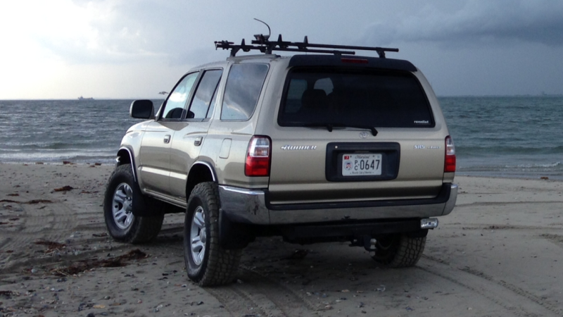

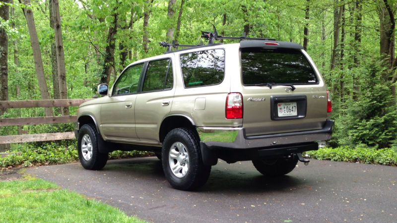

Nice looking rig. You have to garage that thing sometime in the year.
