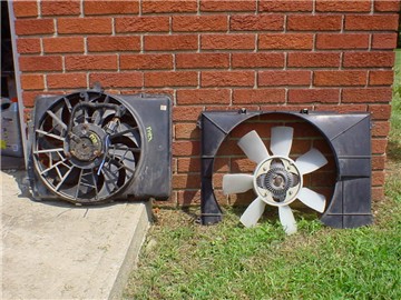

That is interesting that the low speed setting won't cool your engine. What temp setting is the fan controller that you used? I think that the fan only turning on when the A/C is on and your engine is hot seems to indicate that your fan controller is malfunctioning. I had the same thing happen with the second adjustable fan controller that I had installed. (I went through 2 adjustable fan controllers~ $80.00!) Somehow having the fan controller mounted on the shroud, it would cook the controller. When I went to the preset temp sensor, I had no further problems. By the way, how much smaller is the fan and shroud than your radiator? On the 3.0 V6 radiator, I have about an inch of uncovered radiator on the top and bottom of the fan, and none on the sides. I haven't looked at the 2.7l engines, but on the 3.4, the taurus fan is pretty small since the radiator is like 6 inches wider than a 3.0 radiator. I also replaced my thermostat when I did the taurus fan install. I am running a 180* thermostat and a 185* preset fan controller. In order to run the high speed setting, you will need to use the 30/40A relay to actuate a larger 80A or another pair of 40A relays wired in parallel. I still think that the low setting should be enough to cool your 4 cylinder. Keep us all posted.

Yeah I need to do more investigation with the settings on the controller. I thought about going with a preset one but I didn't c any at the autozone or the parts america that i was at. The new fan and shroud is a bit smaller than the old setup. I saw that you went with a cooler thermostat I might want to look into that. But I dont think I should have too. I need to pick up some "toyota" antifreeze tomarrrow to top mine off. I think its about a halfgallon short so that might have a little bit to do with it. I mess with it tomarrow night after work and if Im still gettin hot Ill ask for suggestions on the higher fan speed setup..thanks D
Oh I do have a pic of the two sizes maybe this will give you and idea of radiator sizes
