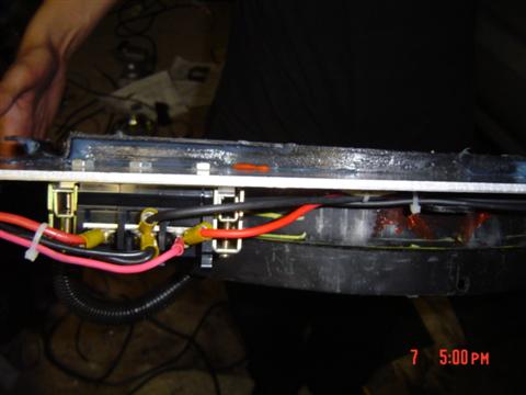

I have the shroud ready to go in the truck. I mounted the fan inside in the aluminum shroud I made. I have enough clearance for the Water pump. I have to trim some of the plastic on the fan to prevent hitting the radiator when the fan/shroud is installed. It's coming together and it is going to work. I haven't seen to much info on the Taurus fan on the 3.4. There are a few sites I did see thanks to you guys. I did very little cutting on the Taurus fan. Most of my cutting was on the aluminum shroud plate. I'll try to get some pics if anyone is interested?

Pics please!
Are you really going to cut the fan? Surely you mean the shroud?

Here are some pics of my home made shroud. You can see the lip I may have to cut. I had the fan mounted on the outside of the shroud, but it hit the water pump. I trimmed the shroud to stick the fan inside the shroud, now it looks like it will fit without water pump interference. I might get by without trimming the edges on the fan. You can see this in the pic of the fan side ways. It should work out, but taking a lot longer than I thought.

I'm shocked by how big it is, is that the same size as your 3.4 radator? Are you going to use some kind of seal around the outside to draw the air through the radator?
