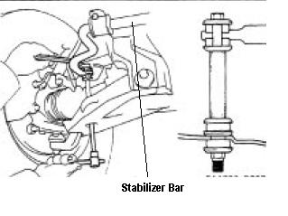

Did the 2wd have a rear sway bar? Don't think so, nothing had a rear one until later model 4Runners got a rear bar.
I'm pretty sure you should have a front one though. Looks similar to this:

Ah yes, it does have a front sway bar. Thanks for clearing that up. Do you know the diameter of the stock front sway bar, or as they call it, the stabilizer bar? Thanks for the help!

Says 1" for the 2wd Yota on the replacement bushing sites.
Yotatruck 1986 - a cheap mod that will help a lot - get some eurethane bushings for that sway bar. It'll tighten up that handling and with those shocks you'll have a handling demon.
Then, when money permits, get some aluminum rims (those look like steelies in the pic) - less unsprung weight on a 2wd helps too!

Correction:
It shows that the 79-88 2wd pickup came with either 18mm or 25mm front bar.
Ya gotta measure. 18mm is roughly 3/4" and 25mm is pretty close to 1".
