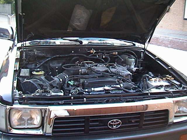

I has been a while since I got back on my supra swap.
A recap:
after getting tired of replacing headgaskets and blowing up the 3.0 V6 I opted for something with more horsepower and, if possibel, better fuel economy.
I don't know about the last, but now know that the first was a succes.
I put in a 7M-GE and mated it with a hybrid bellhouse to my stock V6 gearbox (R150F). The gearbox is mounted backwards, 4 inches to the rear. I also needed to make a new crossmember and shorten the rear driveshaft. I cannot extend the front driveshaft until I have fixed some problems I encountered with the supra engine versus the SAS. Since I use coils and a high pinion diff, things are quit different. The diff flange will hit the bellhousing when the suspension is fully compresed. I'll have to solve this later.
I also replaced the radiator, mounted an electric two speed pusher fan and built a new exhaust.
The electrics took me a week to figure out, since the previuos owner cut my wiring and rewired it. Wrongly of course.
Hooking up the engine turned out to be very easy. There are only like 10-12 wires that need to beconnected and everything works, from tach to oil pressure.
After making some non-insured test runs, I must say that 204 hp is way different from the stock 150 hp + headers.
Here's a pic.

I estimate that the swap, including 1 supra wreck, cost me about 1500-2000 USD.
A lot of things I replaced, like the bumper, grille, roof racks, radiator etc. were not really necessary. I just bought a entire stock from a toyo dealer who moved somewhere elso, so most parts I got for free.
Now I'm finished and have an overview of all things that needed to be done, I must say that it was quit easy. Fabricating the bellhousing was the most difficult and the electrics the easiest.
If you can get all necessary parts before you start, the swap can be done in only 3-4 days.

It's a '86 7M-GE with 100.000 miles on it. I bought the wreck without seeing it or knowing what type of engine it had. Wish it was a turbo.
But anyhow, this was an experiment. Now I now it works I will drive it for some time and see what breaks. And in the meanwhile I can save some money for a low milage 7M-GTE, or maybe an overhauled one.
It now has 204 hp but I want it up to 300-350 hp within a year.
That shouldn't be too much of a problem with a 7M-GTE.

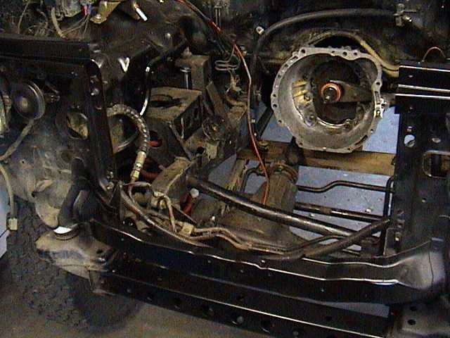

I did not use the option of the bolt-on W gearbox from a pickup. Those are quit flimsy.
I opted to use the R150F from my 3.0 V6 runner. So I had to make a new bellhousings since the bellhouse of a non-turbo will only fit a W series and a turbo bellhouse is too long. It uses a pusher type of clutch, instead of a puller type as found on runners and pickups.
In fact, you can bolt on all R type gearboxes if you make this bellhousing.
All W series will fit also with a nonturbo bellhouse.
Here's a pic:
Here's a pic:
