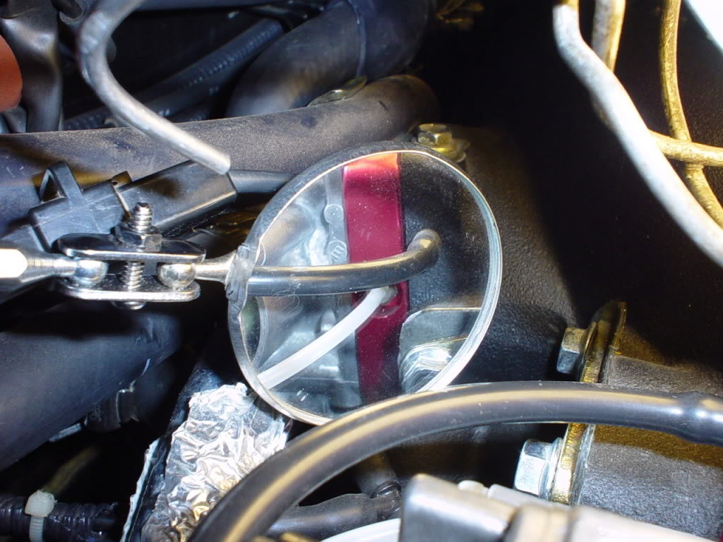

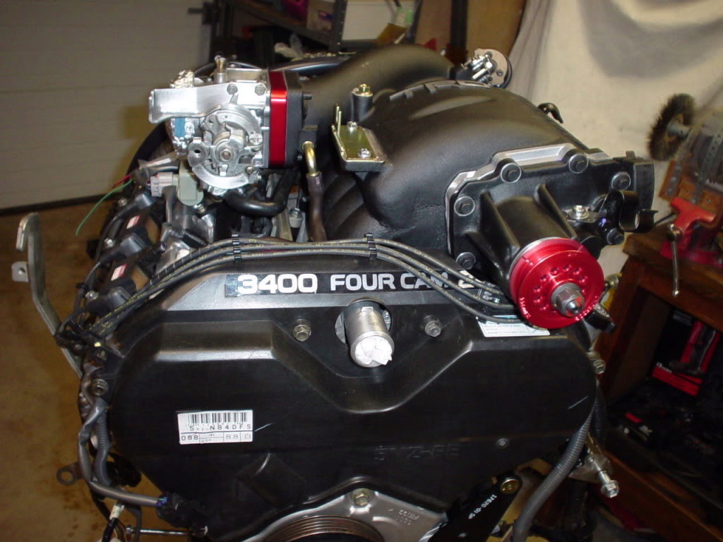

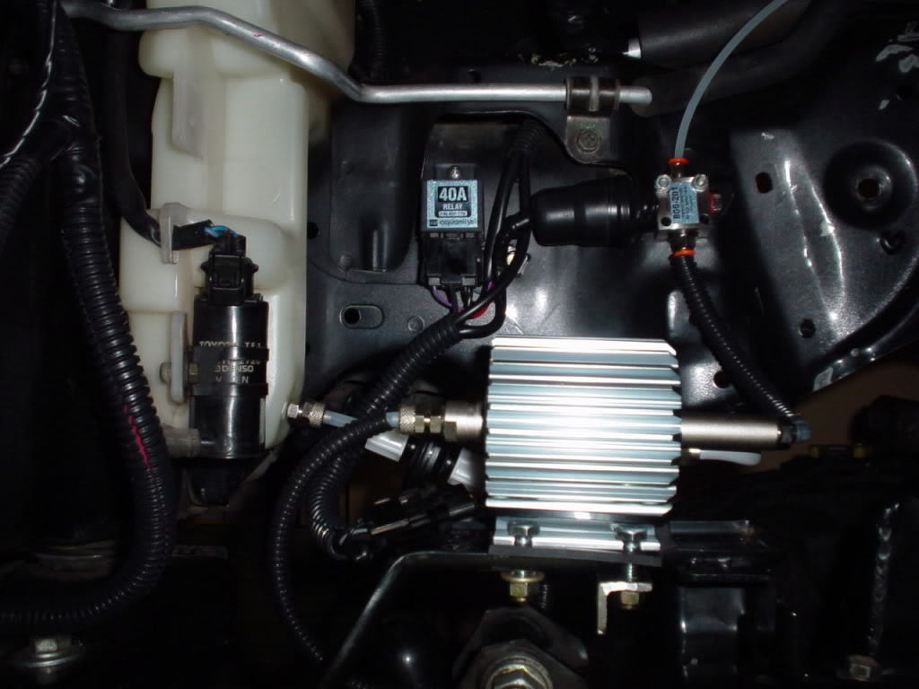

Not really any write-up that I've seen, but there are threads on here about them. WI is not a substitute for proper fuel mods, and is going to tap the money tree about the same as fuel mods (for a good system). I was told by URD that WI was necessary for any pulley smaller than 2.2". You being in high elevations can get away with more boost than someone in the low lands, unless of course you drive down out of the mountains and want to hit the boost down here too.
I have posted a few pics of my set-up (Aquamist 2D system) in my 3.4 swap thread: https://www.yotatech.com/forums/f160...started-82145/
Here's a few:
The WI injector nozzle is tapped into the red throttle body spacer (only good use for a throttle body spacer BTW)
