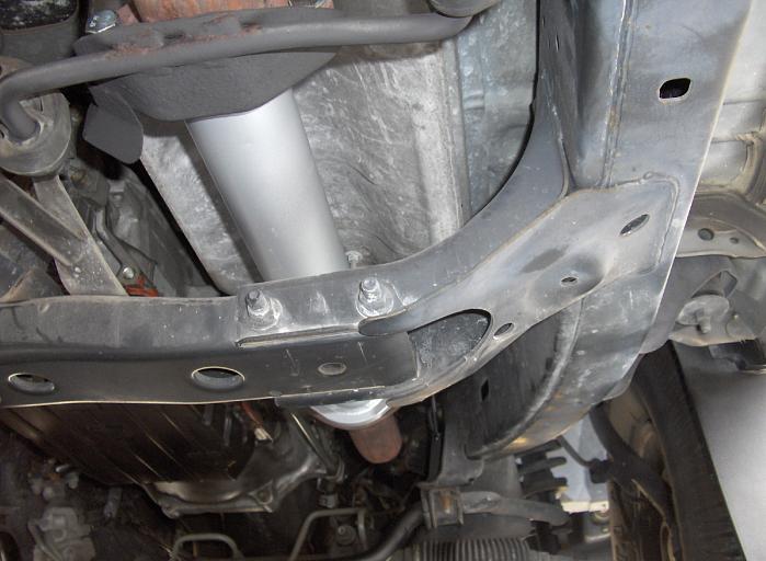

Originally Posted by billkmiami
both o2 sensor's wires seem to be intact. I will crawl underneath tonight and take a 2nd look. After the cat was jacked and I drove the truck home with open exhaust, the truck was very sluggish. After about a 15 min fun ride with open exhaust, the motor threw a lean code. I will get the code tonight and post as well. After I had a new cat welded in place, I erased the code and no other codes popped. So I assume the wires are ok. I will double check though. thanks
that o2 may have seen some fresh air making its way back up the exhaust fooling it

yes the front cut actually started to cut into the o2 sensor mount. The dumb ass stopped after he figured he was cutting into the sensor- so the cut was less than an inch away. I ordered the $59 simulator from URD and I will order the straight pipe (tester pipe) from LC engineering and see if this set up works. This is for my 2000 taco with the 2.7 motor. I emailed URD for info on the $59 simulator but they have not answered me back?? Maybe they do not want to let me know who makes this cheaper part? It looks identical to the $159 unit LC engineering offers- made by Split Second- model ESC1- The $59 unit from URD may be a Chinese knock off?? You know in general if you go cut rate on any part, you generaly get a crap part. Does any one have experience with this part from URD?? Thanks!

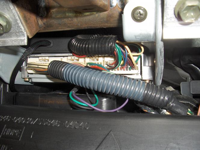

check out the photos- "test pipe" installed in place of the cat from LCM and a 02 simulator from URD= no cat to steal and no codes coming on and I have a noticible gain in power from this 4 banger!
How did it connect up to the ECU? Did you have to splice some wires?
