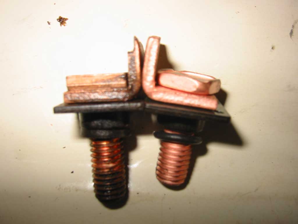

Seriously, here is a good example of "OLD vs New" and if the "old" contact was from my 4 runner, I would replace with new...
The Pic is contact example I'm talking about.

Gawd I wish I had a better camera. Lets review the Pic. The one on the right , in the WORN area has a thickness of 1/4 to 1/3 the one on the left. Starters WEAR the contacts, they do not get just dirty. When the contact gets WORN, the electrical current does not connect thru the contact to the plunger correctly and therefore it Clicks. NO amount of brushing is going to solve that.
English, even tho it aint Texican.
KDF,
See #31. this is a good are the contact example of I'm talking about.

Stubborn yes... "Clueless" no.
And again, yes, your starter solenoid is completly sealed, no water should be getting in there. I think YOUR the only one who has problems with water/salt corroding your starter contacts.
Where do the battery cables connect to the starter... Is that totally sealed? Those are contacts too and that was what I was initially refering to. Also a far as salt spray not affecting the intrnal contacts of the starter, possibly not... Yet, the hammer trick is a "salt belt" favorite.
Why do starters typically go out in the winter...? Well turning over a cold engine is part of it ...and so is salt degrading the contacts
is another.
1st off I have no problem admiting when/if I am wrong ...yet, our opinions are a little subjective and is not black and white issue....I said " if any contact is "questionable" then replace them and I they just have a slight layer of crud..."lightly clean and reuse.."
Also When you say "no water should be getting in there (the starter) a starter is not water proof and I guess that depends on how high the snow and slushy puddles are that one is riding through. Where I live Salt spray gets every where and all the way up to the battery cables... and even a "salt mist" is enough to corrode a contact... any contact
Hey, you are probably right, as after the starter is already "opened up" one should just replace the contacts if they are questionable...and quit messing around with the issue. Believe me, I don't like to do things twice, and when "push comes to shove" I will replace the dam part and not fool around with it for a long time.
However If a contact is just corroded yet still intact, I'm going to "sand it clean" and reuse....
like I said, thats not a crime... is it?
Old Dec 15, 2007 | 12:56 PM
  #40
Maj's Avatar
Maj
Joined: Mar 2006
Posts: 208
From: Orlando, FL
I think the reason Toyota makes an issue out of the thickness of the contacts is that the plunger bottoms out against the housing. If the contacts are worn, there ends up being an air gap between the plunger and the contacts. Air is a very poor conductor so you end up getting a click. So all the contact polishing in the world ain't gonna improve things.
