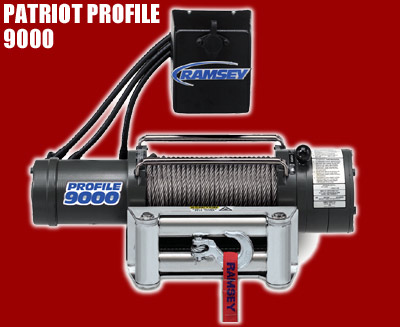

My only question is why are the winch bolt holes and openings off-centered to the drivers side? When I first noticed it I thought it was just the photo, so I checked the website and their photos confirmed what I saw in yours. Its an awesome bumper, but I can't figure out why in the world they would want to have the winch off-center??

i think the winch mounting is off-center so that it can accomodate different types of winches because some may have the motor or planetary housing on that side and wouldnt fit in the bumper if it was centered. just my guess though.

If you notice on any winch, if the spool is centered there is significant difference between sides. So vs. adding 4" to the center width and adding signicifant bulk and overhang to the bumper the winch is slightly off centered. The bumper is very tight to the vehicle and if you install a winch, you'll notice the winch fits very snug inside the bumper.
As for the trouble with the install (you may have done this but..) we always leave the brackets loose when fitting the bumper (and it is tight) so that we can gain any slot space to get it into place then tighten the brackets, then bumper after adjustment. I think it is in the instructions but I may have accidently omitted it in this bumpers instructions and be thinking of another...I'll have to double check.
