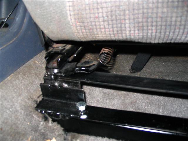

Seat mounting
Originally Posted by dynamic73
Will bucket seats from a 94 Four Runner. Fit into a 94 2WD Pickup Xtra Cab that has the 60/40 bench seat in it now?
The PO of my 89 extra cab installed some tacoma buckets. 2 months after I bought it the brackets started bending and the seats were tiliting towards the door.
The PO had drilled the brackets that were orginally ment to bolt into the side. And he made them bolt straight down.
I called yotayard.com, they were pretty pricey for stock seats.
I picked up some celica seats off of ebay for $25. I thought it would be pretty simple. A few hours and they would be mounted. I was completely wrong, took me almost all day just to mount one. And I started a small fire small burn mark on seat .
Attached Thumbnails Seat Conversion-img_0296-small-.jpg   Seat Conversion-img_0293-small-.jpg
