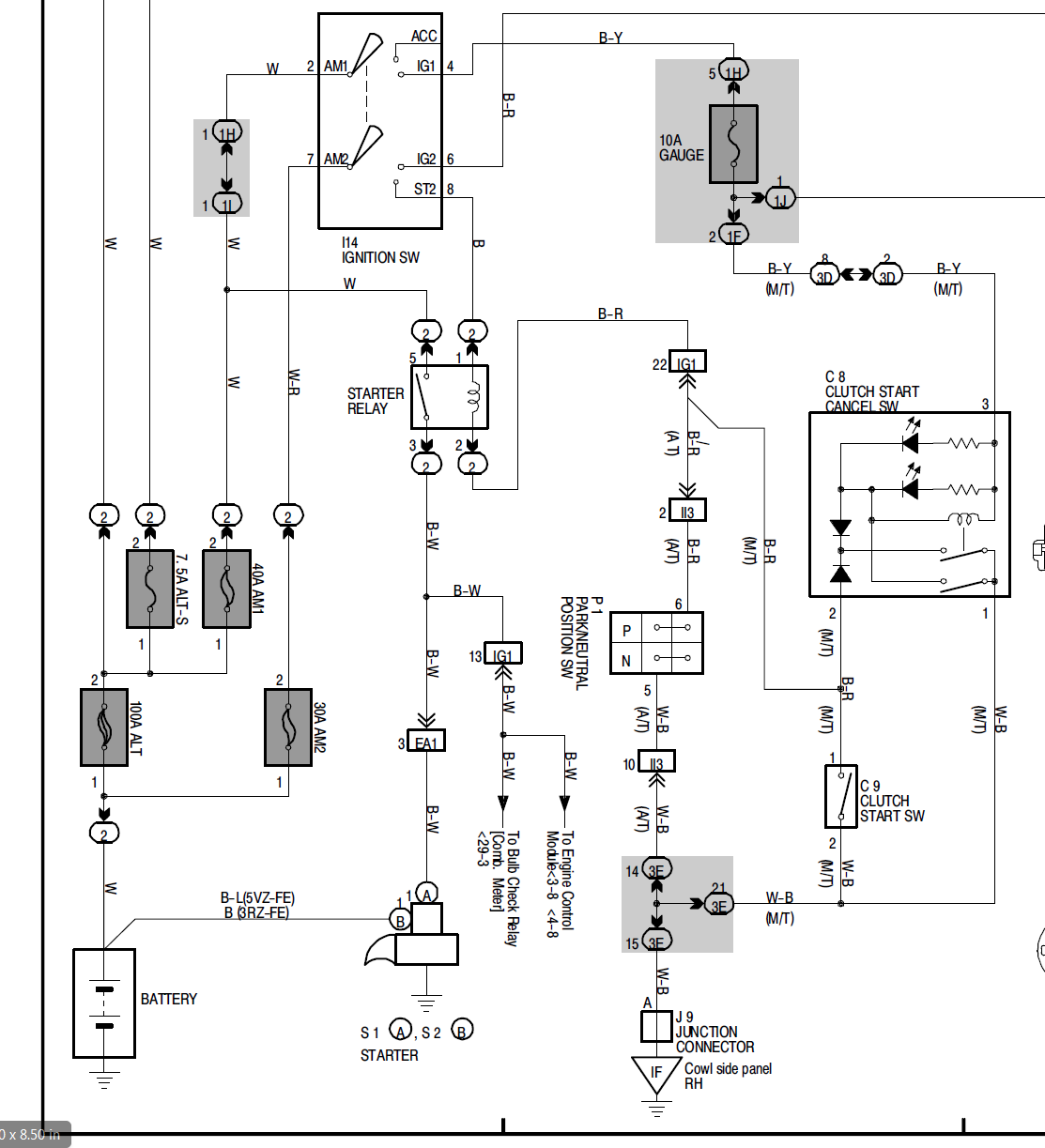

I'm just worried that there is some voltage comparator function in the ECU that is dying, or there is some other interlock feed to the ECU from the mess of crap about the shifter. The wire diagram shows that the volt high signal from the ignition switch is sent to the ECU through two terminals: NSW and STA. The signal to STA also must pass the neutral start switch. If the two signals don't match maybe the ECU sends the power to ground? ..or maybe the comparator is failing and thinks they don't match?

Anyway, I pulled up the wire diagram for your truck, there's really not a whole lot to go wrong, there's the starter relay, solenoid, neutral/park switch. The ECU has a tap on the starting circuit, but it doesn't directly control it. The ignition switch provides the power, and the ground goes through the P/N switch to the Cowl side panel ground (RH).
Anyway, it's a bit backwards logic, but maybe you have a bad connection on the battery terminals? My experience with that is that it will spark and not start though, not start up fine then loose connection.
Another thing to check, is does it click at all when you try to start when it's messing up? The starter relay and starter solenoid should both be clicking (the big click is the starter solenoid, if it clicks you know the relay is working). It's possible the solenoid contacts are worn out and hitting the starter a few times might make it work once in a while. Technically the relay could be going bad too, but I think they generally outright fail when they go bad.
