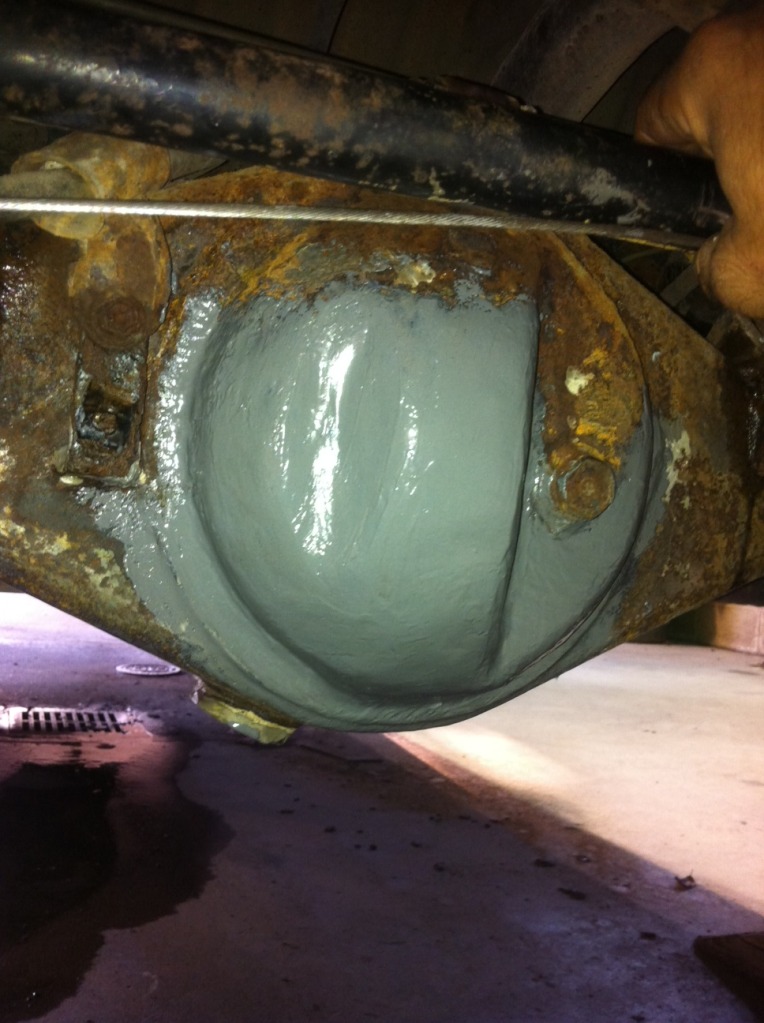

Old Aug 18, 2012 | 08:20 PM
  #32
darkfader's Avatar
Joined: Aug 2012
Posts: 2
From: Davis, WV
bumping an old thread after trolling the forums about the rusted out rear end problems. i had no idea this was so common. my first two 4runners were southern and had very little rust. my current '97 came from ohio, and it didn't look too bad when i picked it up. but it has sprung a leak and now i realize that the aft part of the rear axle housing is junk. i took a grinder and cleaned it up the best i could without removing the assembly and gooped some JB weld on it. it's holding for now. i've found a few housings that are in good shape, but still out of my budget at the moment. (it's race$$$$ season) i want to hang onto this runner for a while tho, so i will make plans to replace the entire assembly sooner than later. here's a few crappy iphone pics of the mess i have under there. obviously a lot of work needs to be done. i haven't had this ride very long, so flame on if you must, but the grinder, wire wheel, and some POR-15 is about to get busy underneath.
after grinding i found two nice holes in the center of the pumpkin about an inch lower than the fill hole:
after some JB:
what i'm most concerned about is just to the left of the pumpkin under the bracket is still wet after the JB weld treatment. the leak was a fast drip and now it's just wet, but i know it's only a matter of time. i can't really get behind the bracket with the grinder or epoxy. FML
my main reason for the bump: has anyone had a new cover welded on? i would much rather go that route than replace the entire assembly if possible. mainly because i never go off road, i really don't need to upgrade to a locker, so i just need something dependable. thanks

I just picked up a '00 4Runner from Delaware and it has the same issue. Pinhole leak at the bottom of the welded cover. Last night I made sure I could get through the rust to open the drain and fill holes, and remove the breather to make sure it's not blocked. My plan is to drain the fluid, sand the area down, JB Weld the leaking area, and then POR-15 the axle. If I see it's too far gone then I'll weld a patch over. Last resort is the Marlin cover, but I really don't want to tear the whole axle down. It's a good option at only $59, though... http://www.marlincrawler.com/armor/a...erential-armor

I fail to see how the Marlin cover will help. It's a cover, with a large hole for the fill plug. At best, it would contain the leaking until the gear oil finally flows from the fill plug cutout. Not to mention, the space between the Marlin cover and the original, rusted cover, would be a lovely place for rust to continue its work...
I've 'repaired' my neighbor's leaking axle housing (2002 4Runner) using the JB Weld method. We both know it's only a matter of time before another pinhole develops.
Not one of Toyota's finest moments.
Andreas
Old Aug 29, 2012 | 08:35 AM
  #37
Ukraine Train's Avatar
Joined: Oct 2008
Posts: 6
You're right. I was thinking you would cut off the old cover and then weld the Marlin one in its place but I see now that's not how it's intended to be used. I suppose you can make some modifications (weld in a bung for the fill plug and space it enough to clear the gears) and use it as a replacement, though. Beats paying for even a used axle, let alone a new one from Toyota.
I ended up just epoxying mine and then coating with POR-15. It seemed like there was still good steel under the rust. We'll see how it holds up. I POR-15'd the hitch too, and it came out looking decent. Nice glossy black instead of the rust/faded paint that was there. Just makes the rusty bumper look worse over it...

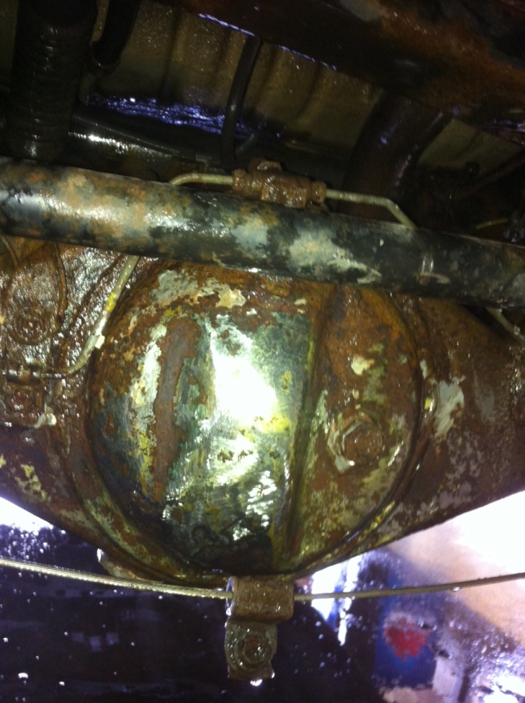

Old Oct 7, 2012 | 07:50 PM
  #38
rad yo's Avatar
Joined: Sep 2012
Posts: 2
Im also bumping up this thread, picked up a '95 runner from a buddy and found the rear diff leaking, figured it would be ok for a few miles but I was wrong. Last time i drove it the rear diff was smoking and oil was bubbling out through the holes in the cover.
Anyone know if the axle housing and the pumpkin that goes inside will be enough? I shouldnt have to replace everything from the hubs inwards should I?
