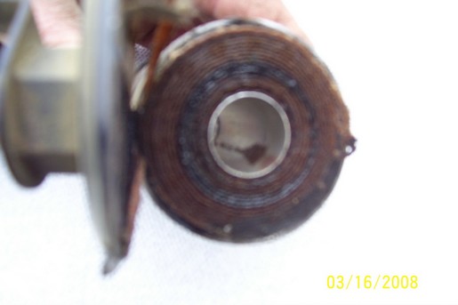

took filter apart
wish you guys could see this in person. I cut inlet end of filter off first. it was VERY bad. I can't stress that enough. even before I cut filter- on outlet end I could see a streak of dirt inside. I took filter completely apart. it was unbelieveable. it was nothing but dirt. I removed my injectors, there was dirt streaks in fuel rail. will try to post pics.
Attached Thumbnails Runs bad, cat cherry red ?-100_0724.jpg   Runs bad, cat cherry red ?-100_0718.jpg   Runs bad, cat cherry red ?-100_0726.jpg
Old Mar 16, 2008 | 08:22 AM
ozziesironmanoffroad's Avatar
Joined: Sep 2007
Posts: 6,002
From: Spring Valley, CA
yuck! you were right to replace that
