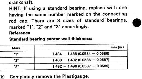

My rod has a number 2 on it, I assume this means my OE bearing is Mark 2? I don't see a 2 on the bearing like FSM says but I see a part number. That means I could go to a mark 3 if I have to but difference is only +0.0001? Why would they even bother or is this a misprint? Or is wall thickness delta not the same as clearance delta?
So I'm wondering what is typical OE rod bearing clearance? FSM says up to 0.003 is OK I'm guessing they start low since min 0.0009 then I should be OK even if I end up removing 0.0005 or so but I don't have experience with this so I'm wondering how good the journal should be vs danger of removing too much material and not meeting clearance.

I was not aware that Toyota offered the selective fit standard bearing shells for service.
Please let us know if you are actually able to source these shells.

They are listed on online parts catalog but the dimensions dont really make sense to me. Perhaps mainly for obsessive factory build Toyota tolerances.
Anyhow I think I'll be OK, from what I can tell if scoring is light to clear it up is just on the order of 0.0005 or so.
