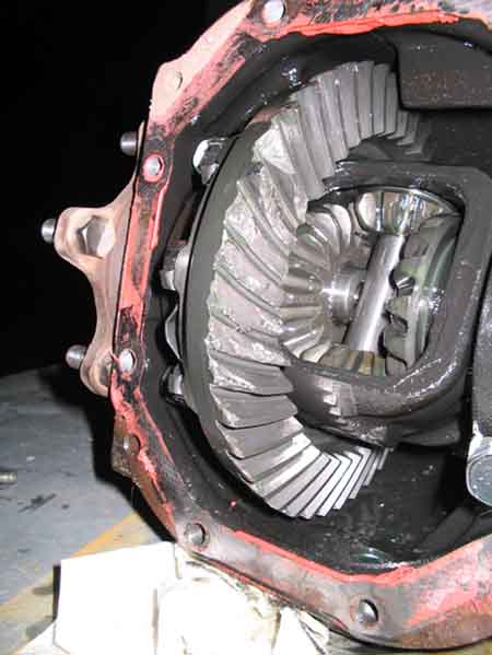

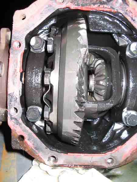

So I completely destroyed my front ring gear on my '92 4Runner, and I was hoping to get some info on where I might get a cheap replacement.
It's a Toyota 7.5" IFS with a 4.300 gear ratio. I'm hoping to find a used- good condition ring and pinion for under $100. Any one have any leads?
Any help would be greatly appreciated.
Enjoy the pictures, they are a great example of what a ring gear shouldn't look like
https://www.yotatech.com/attachment....achmentid=2483
https://www.yotatech.com/attachment....achmentid=2484

Went up a steep (~55 deg) dirt hill in 4-Lo 2nd gear, crested the top and caught some air under the front end, on the landing a resounding *pop* signaled its demise. I had hoped it was a spider gear going out, but the ring gear got the brunt obviously.
I suspect I had weakened the ring gear before, and this finally finished it off. Such is the price of adventure.

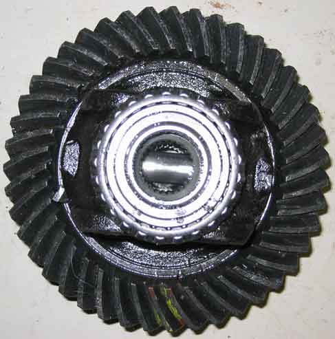

I ripped my spiders out pulling atree down in reverse with my winch, to make it better I have it on film
The spiders decided to ruin the ring gear and pinion notice the metal chunk wedged in the ring gear

This is not a clear pic but notice the spiders
