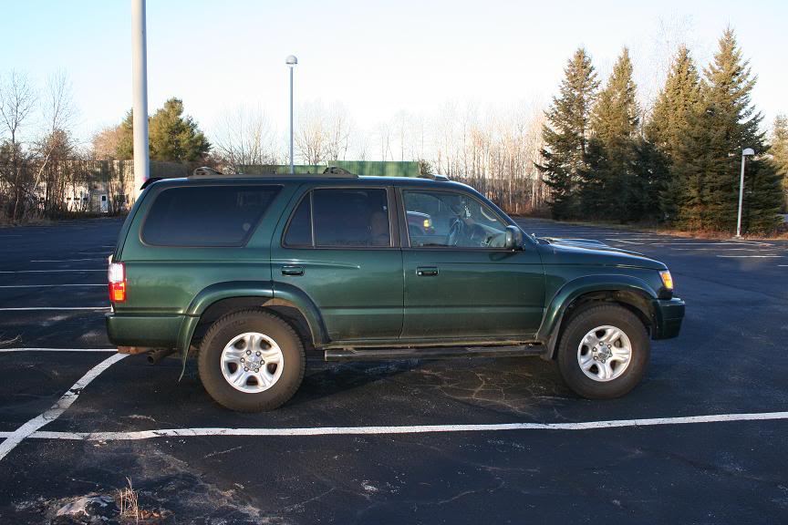

Here's some before pictures I took today. Bad lighting, dirty paint. Oh well. I hope to install the combo sometime this week!

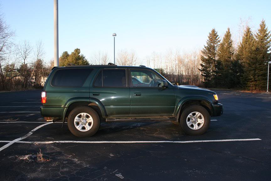

Height increase
Front: 2" (34 to 36")
Rear: 1.75" (34.5 to 36.25")
As you can see I'm just barely level! The front better settle in because I prefer a forward rake.

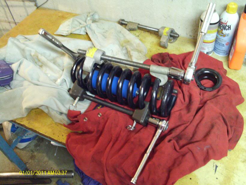

Anyways, as far as the install goes, it was a pain but I got it done with hand tools. I borrowed an extra set of spring compressions from Autozone. My made in China set wasn't going to cut it but Autozone parts are beefy enough. I just used one of mine and both of theirs. Never felt unsafe.

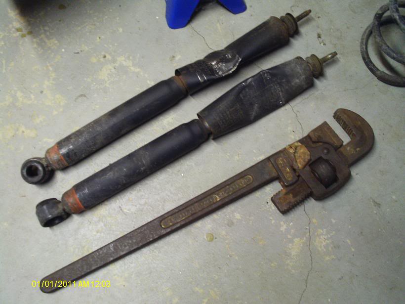

The rear shocks, came off alright with this big channel lock:

The before and then the After shots:
