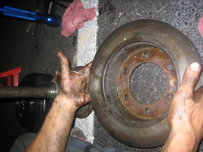

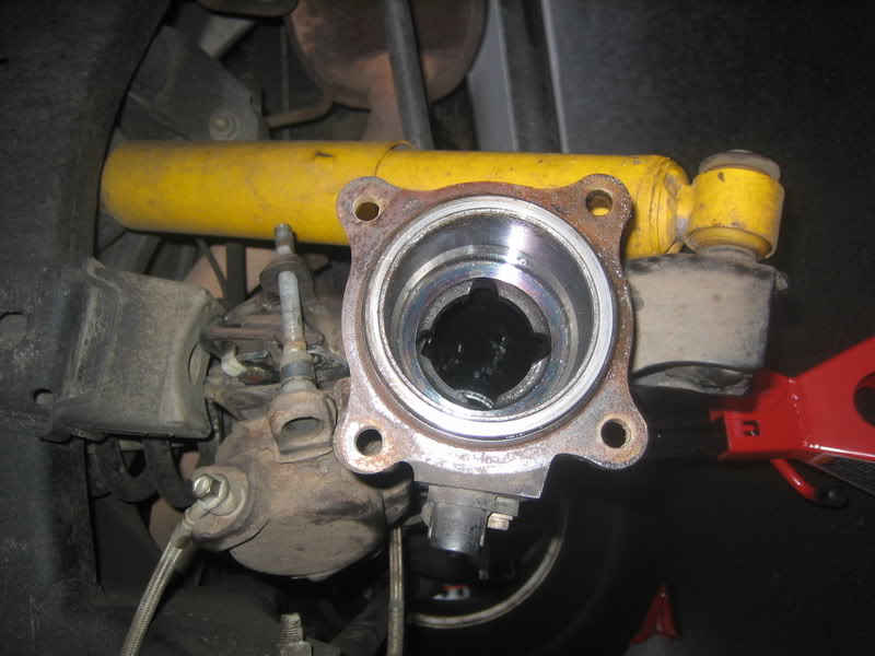

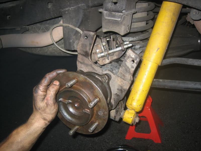

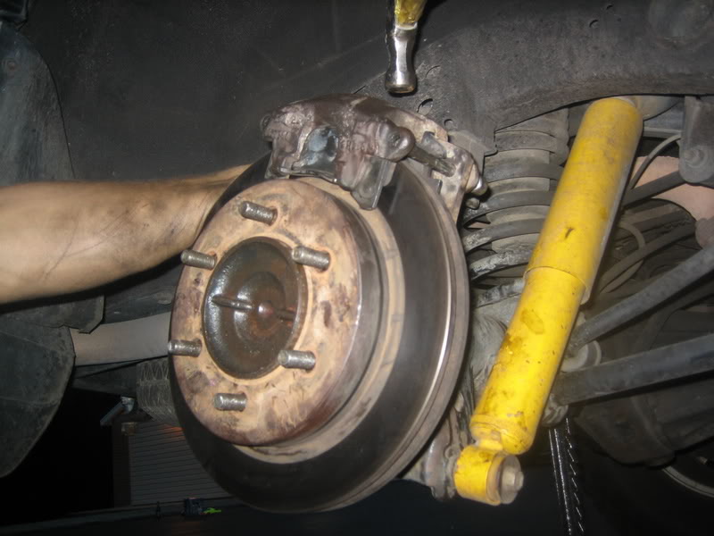

i was leaking a little bit of gear oil out of my passenger side rear axle and had alot of play in the bearing, so i needed to replace the bearing and the seals, pics to follow
more pics to follow tomorrow!

as far as a detailed write up, perhaps, there is alot of stuff that i did that i didnt think abt writing down while i was doing it (socket sizes and stuff) but i will continue to take lots of pictures and try to explain everything as well as possible.

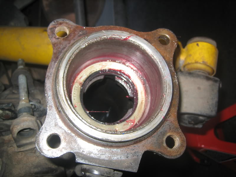

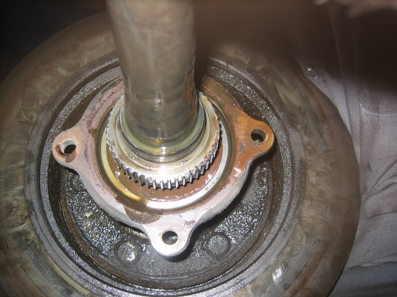

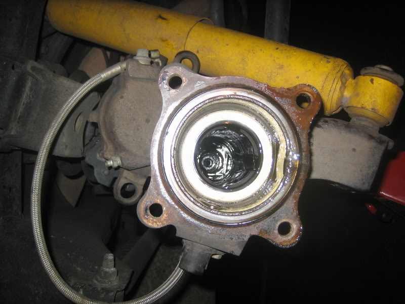

okay, got the axle back with the new bearing and seal pressed in today and reinstalled everything
the leaky culprit
uh oh
no this really didnt work
everything is back together now! ill have to wait till tomorrow to see if im still leaking, but on my test drive it def. took away the howling noise!

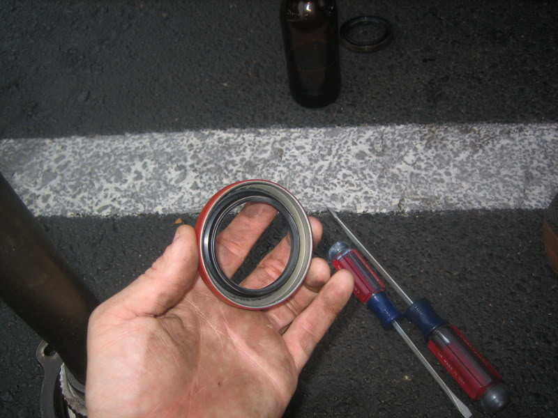

that inner dia of the seal looks greasy
Old 03-15-2007, 09:41 PM
RunnerUp's Avatar
Join Date: Jul 2005
Location: Tampa, Florida
Posts: 972
Received 0 Likes on 0 Posts
you mean in this picture?

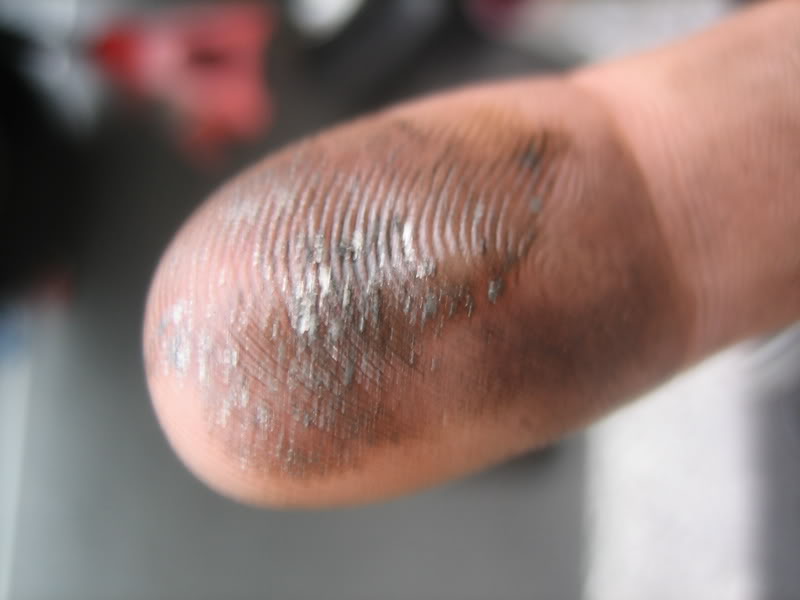

if so, that is bearing grease (im assuming you knew that) and its only on the exterior of the seal with gear oil lubing the inside. but just to increase my knowledge, why would grease be a bad thing? or is it just the grease mixing with the gear oil? im more concerned with the metal shavings i found in my axle housing and by the inner axle seal.
do you think i should go in and clean the grease off the exterior of the seal before i drive it too much? if so, please explain why. thanks

I believe it is the leading to another leak if the inner diameter is soaked w/ grease. Another word, its gives a path for fluid to move through.
The reason why I say that is because i had bad luck w/ front-side engine seals on my two camry and failed after less than half of yr. After that I stop greasing the inner diameter and it seems fine now for over 4-5months.
maybe its just a coincidence but thats how i think it should be done.

FSM typically calls for a bit of MP grease on any new seal that's installed to prevent dry starts. I don't think that would be the cause of your leaks.

i know service manuals tell you to do so, thats what i followed back-then but now i stop. i just put a slight motor oil around the shaft (cam, crank, or axle for this matter) just to give enough lube when driving in, but no grease on the inner dia seal.
i odnt know, thats just my way after certain trial and error

Either motor oil or grease should work fine, but grease does last longer if for some reason the seal doesn't get proper lubrication. I would assume that is why the FSM calls for MP grease. This is similar to engine rebuilding where you use grease on all the metal to metal surfaces to prevent damage before the parts do their initial break-in.
