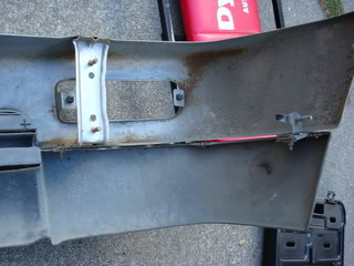

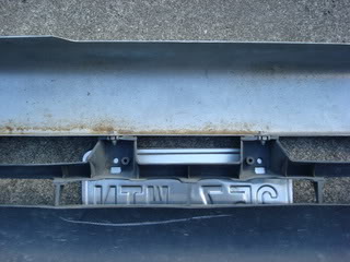

I did this to my 98 so the locations of the screws will be the same on your 96. If you want to remove the bumper to do this it does make it easier, but if you don't want to remove the bumper then these pictues will show you where the bolts are located. Hope this helps.

There are 3 on each end and two in the middle section.
