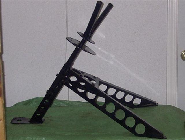

I kinda copied and refabbed a Fabtech tire mount.
It will fit up to a 37" tire and it is lockable. All you have to do is put a small padlock through the hole at the top of the threads and you can't remove the gigabig wing nut.
that looks really nice, except most of us on this thread are interested in something for a 4Runner.

I know I know.
But I thought I would contribute a little for us pickup minority.
The topic did say rear tire carrier.
And it would work for a runner if ya mounted it to the roof
I 've seen dumber things mounted to the roofs of SUV's.
