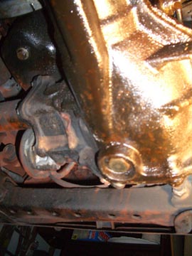

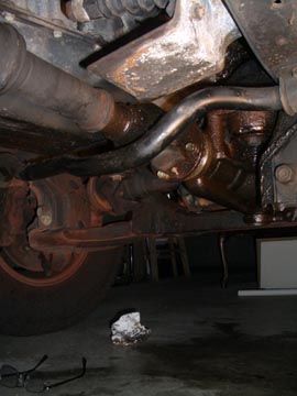

Hey All,
Here are some pics...I had wiped some of the oil off the front diff and off the bell housing but there's a fair amount down there...my kids over filled it so I've been waiting for it to leak out so I can get a "read" on how quickly it leaking but I'd say a 4"-6" puddle overnight...
Would it be worth it to invest in some of those drive-on ramps?...Maybe on all four corners?
As the time gets closer I'm sure I'll have all kinds of questions as to what has to be removed to get there...and will a FSM help?
Wes

The rear main seal isnt too bad, pulling the trans out is not so bad either to be honest. You probably do not need ramps or anything, you shouldnt have to move the trans out from under the truck, just back enough to get to the rear of the block. You are going to need a good foot or two of exstentions and a wobble joint to get at the top two bolts.
I have to pull my trans out this friday, it is a manual but it is conceptually similar process. I could take some pictures if you like.
